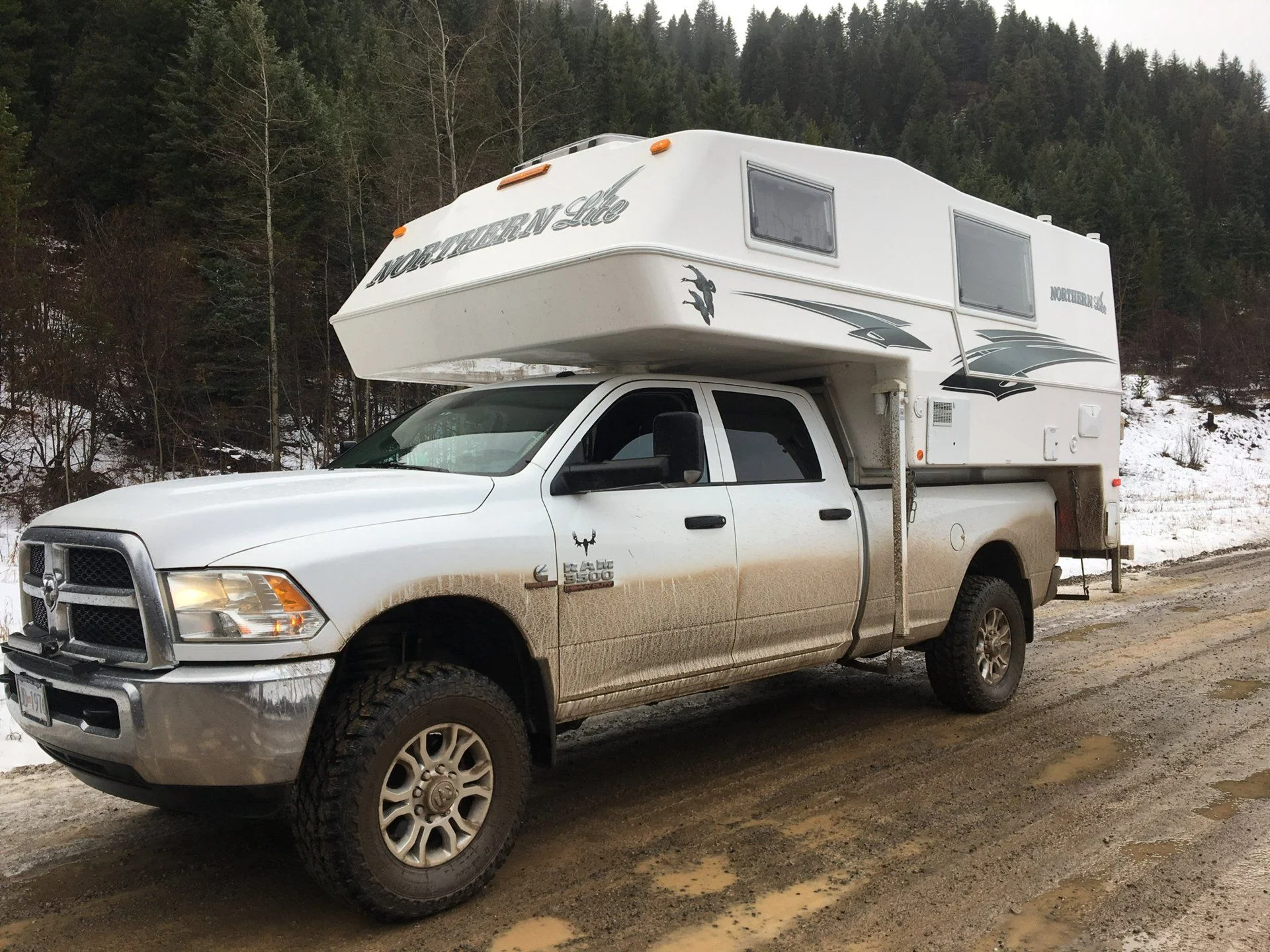

I work out of town a lot (I live down at the beach, and build houses in a ski town) so I went a bit overboard on the camper since it and the truck are 100% tax write off. 2014 3500 Cummins truck with a 2017 Northern Lite. I just traded something for a tandem car trailer, so I’m going to tow the 100 behind.
It’s covered in ‘mud to keep it relevant!
Dang!!!!!! That’s sweet! I am a frequent traveler for work as well and may actually have a location change for a year or two. That’s why I considered your same setup. That’s an awesome setup my friend.
Thanks! I really enjoy it. I need a full size truck for my business, and the Cummins is as good as it gets in North America. The camper is also as good as it gets (if you don’t want a slide out) for 4 season use. I’m comfy in it when there is 6’ of snow outside. We use it as a holiday home as well. I love waking up next to my espresso machine in a (very) dry campsite in the middle of Anza Borego or on the beach with shoulder high surf. I spent 4 months in Mexico living out of the back of my diesel 60 series when I was single, so I’ve done both types of travel. They both have big pluses, but also negatives.
