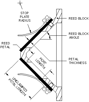

A visual for those needing some context:
The reed valve is preventing back flow from the exhaust from entering the pair and intake. This becomes even more of an issue if exhaust back pressure is lessened, as you would find with some aftermarket exhausts which are less restrictive than the stock setup.
Basic design of a reed valve. It’s meant to restrict in one direction, while flowing in the other as most check valves do. The rattle is the check valve petals doing their job until pressures are regulated in the system.
Also worth mentioning that removing the pair system will not have any affect on power, mileage, or anything else. It exists solely to lean out the exhaust gases and thus lowering emissions.
