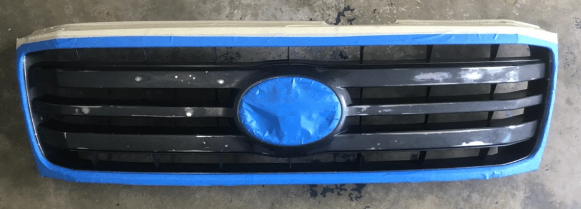

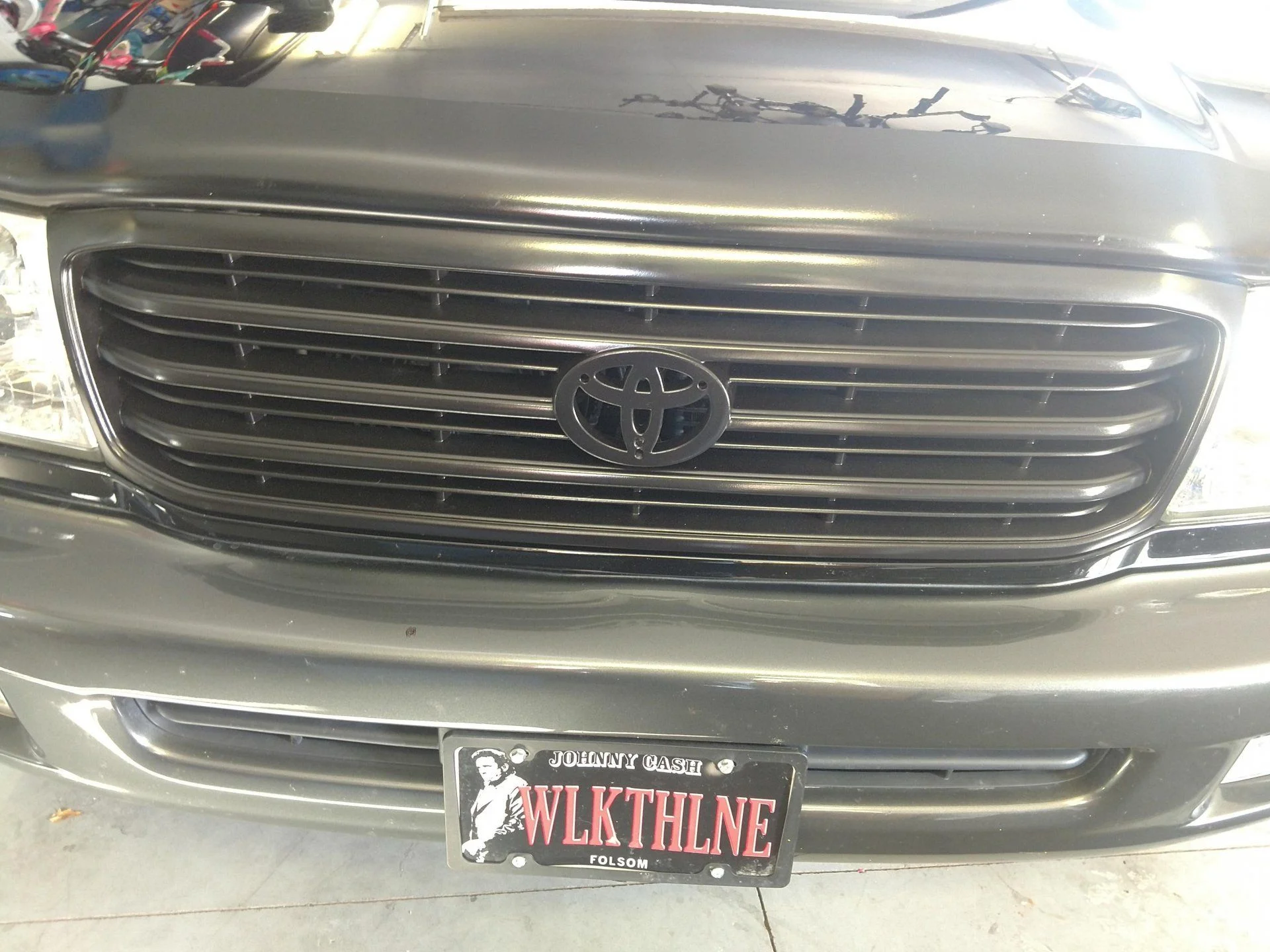

Just pull it, scuff it, tape it and rattle can it. Really... it's that easy.

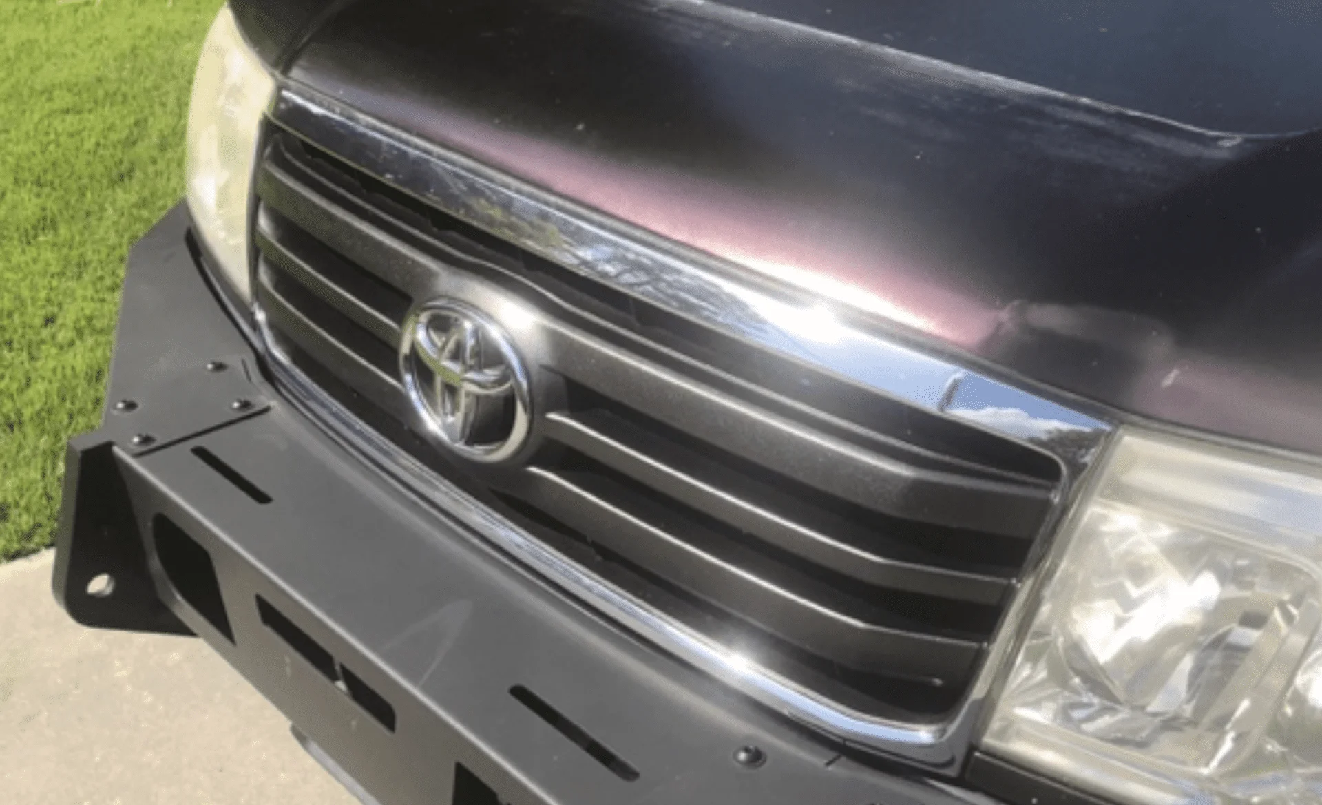

I just finished that (for the 2nd time in 130,000 miles) a couple weeks ago.
Grille looks new... but really highlighted the foggy headlights and flaking
clear coat on the hood.

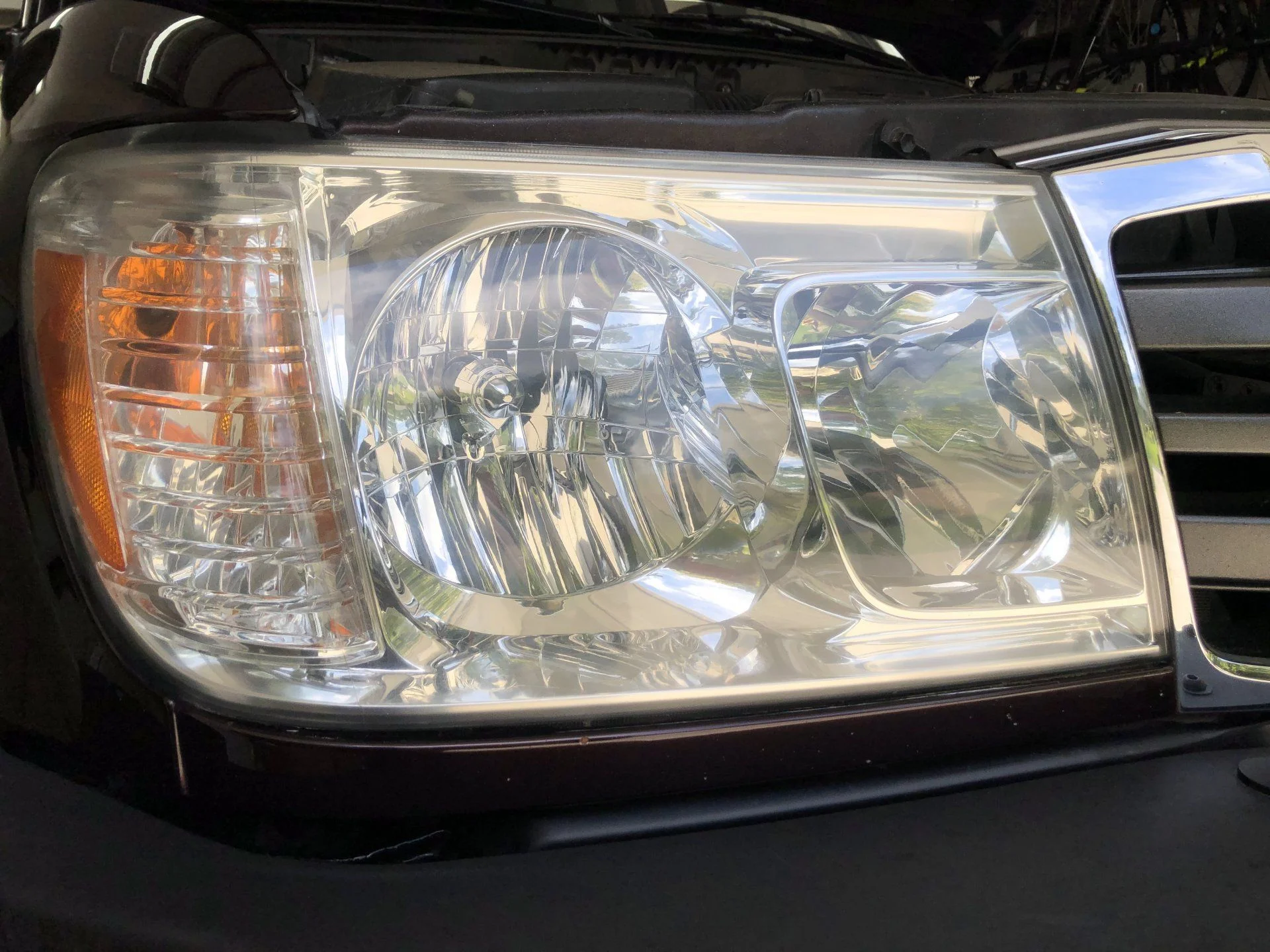

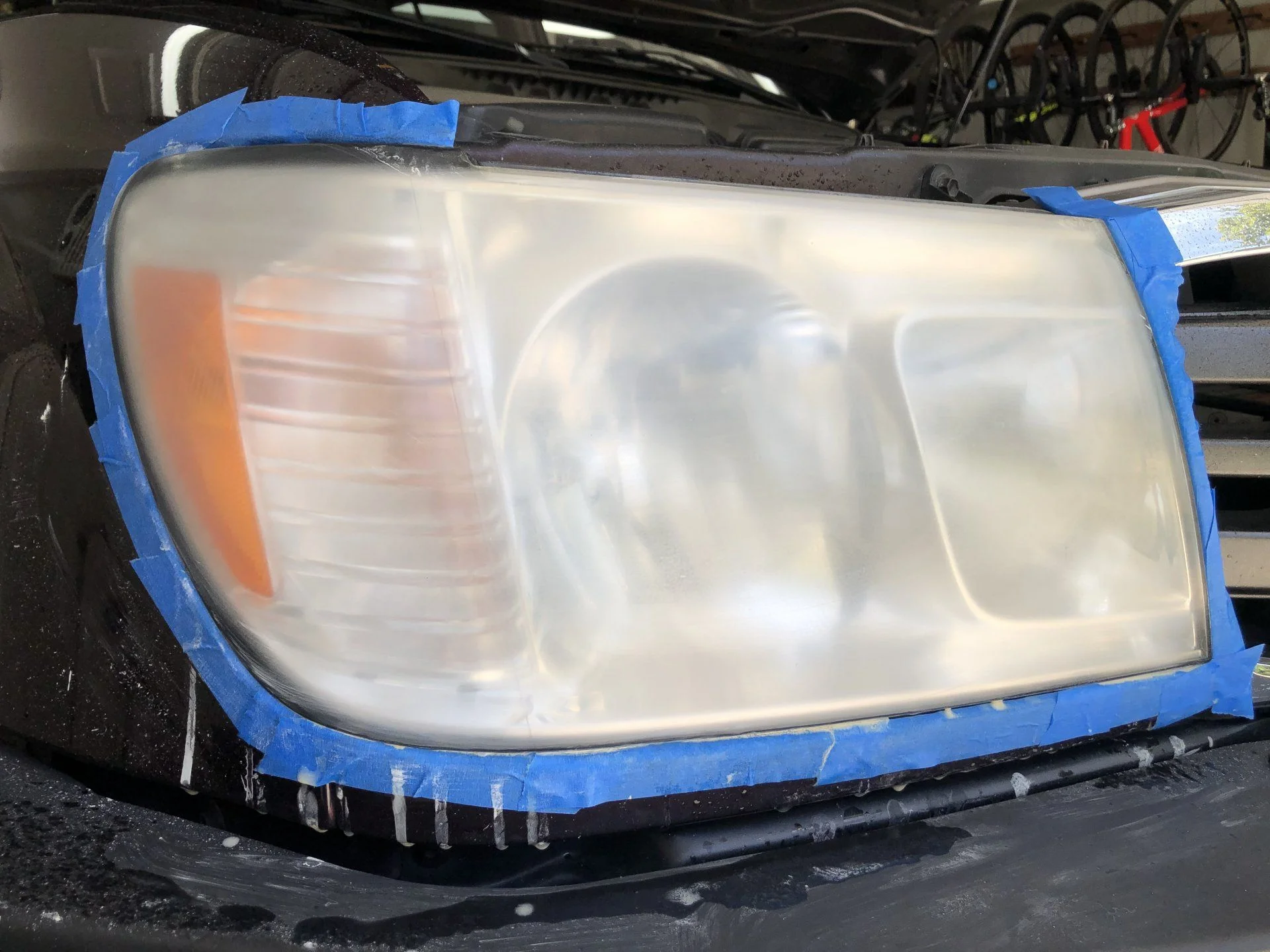

So, out came the wet sandpaper and buffer (for the headlights)
The crystal clear headlights really made that hood look out of place, so it was
off to the body shop for fresh paint...
I guess what I'm saying is - repainting the grille is easy... but can open up a
big shiny can of worms ;)

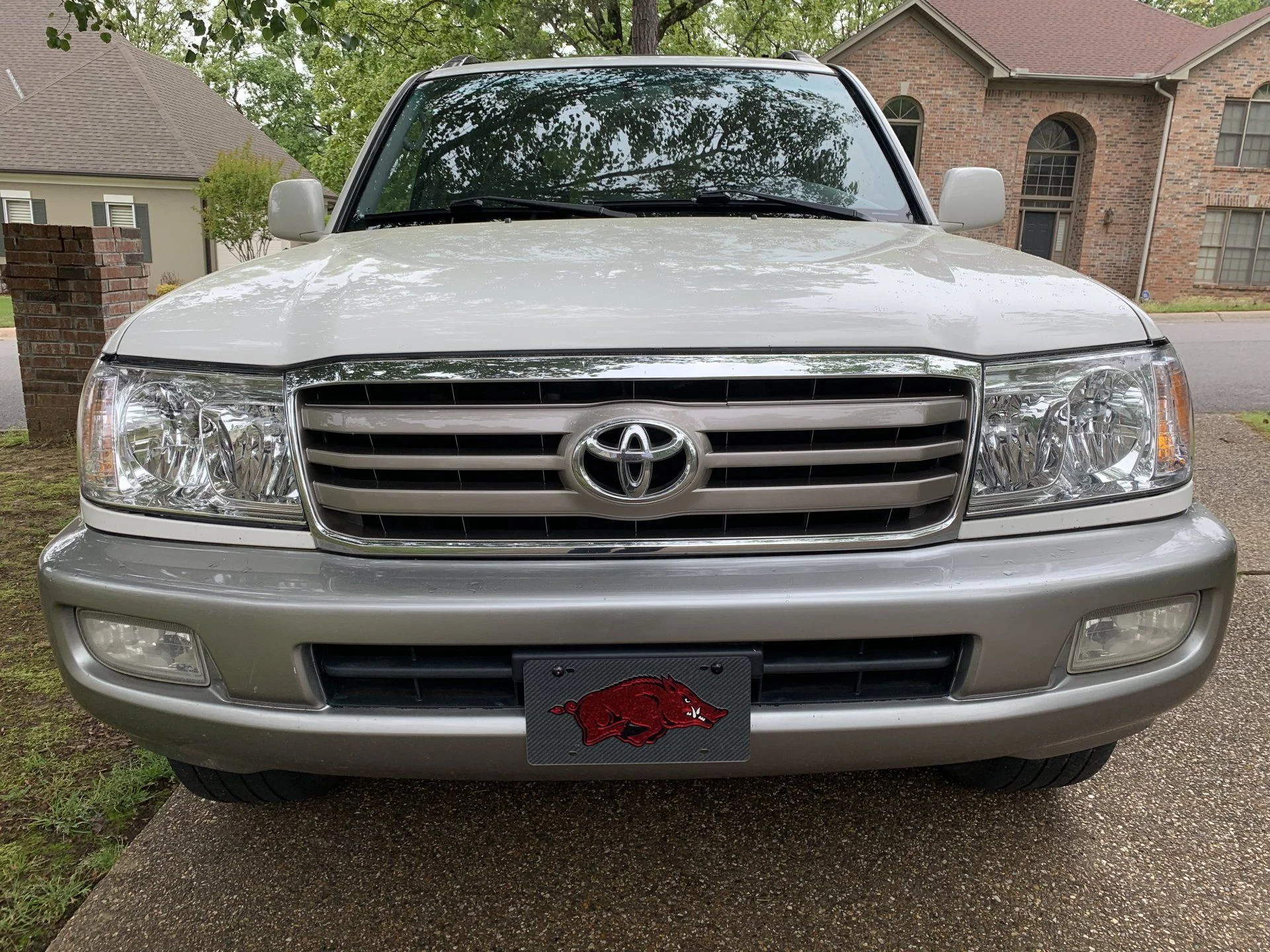

My 2006 had tiny pits all over it but I had it painted professionally the same color as the trim molds.

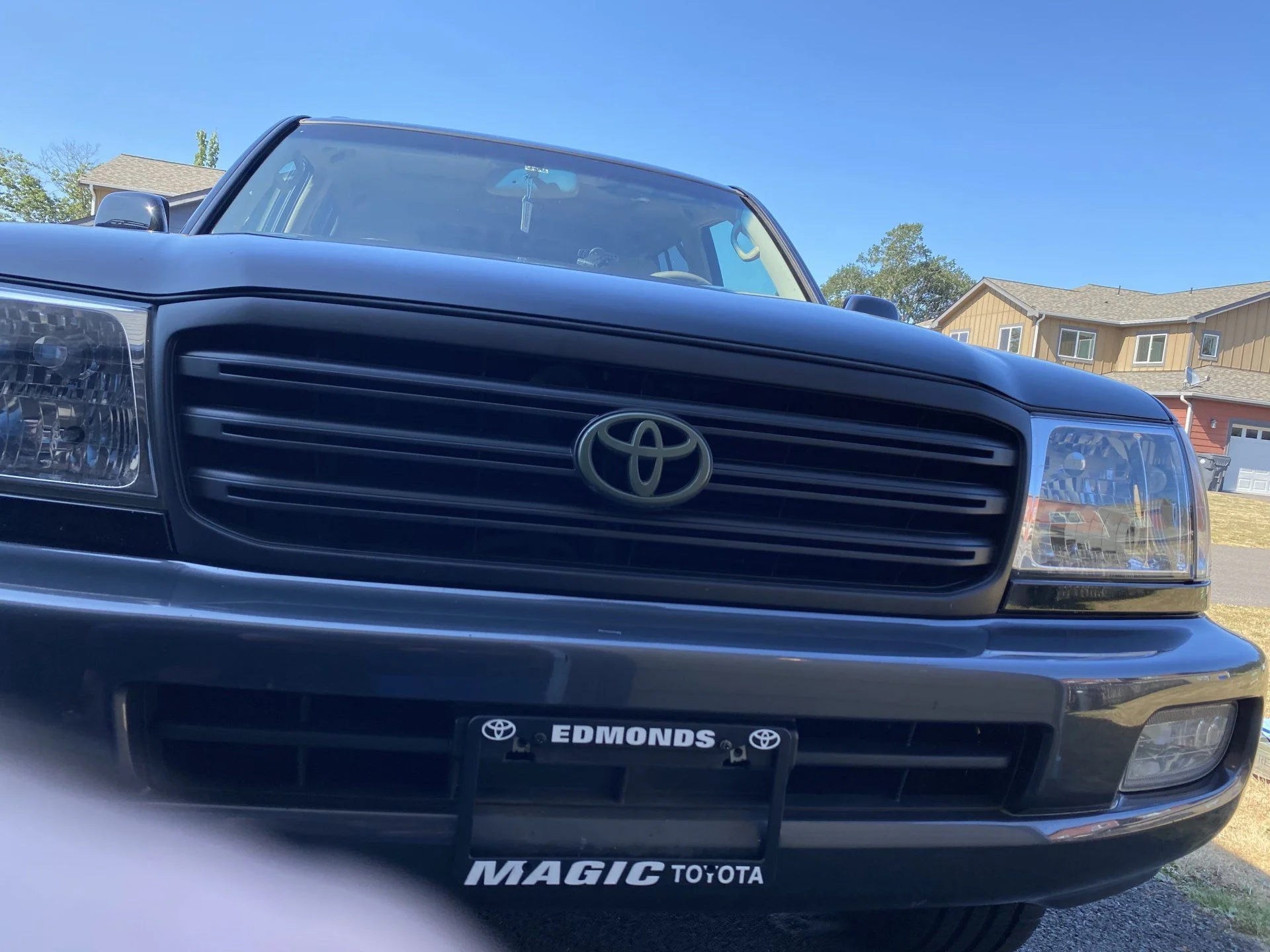

This looks very nice and oem...

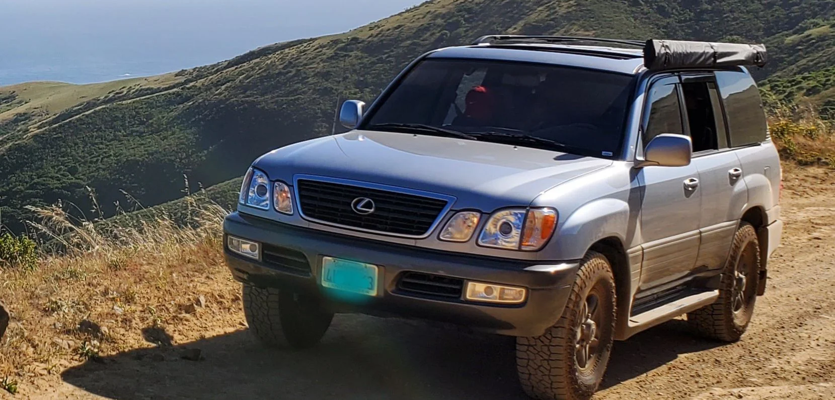

really looks uggly when guys completely black it out specially a lexus...
this is how my lexus is OEM.. love the look. I believe it was 98-02 that had this blacked out grille stock.
Thanks @95Fantasma80. The OE light gray didn't really match anymore - with the black sliders and black and Evo Gray bumper - so, I went with darker metallic gray for the grille.

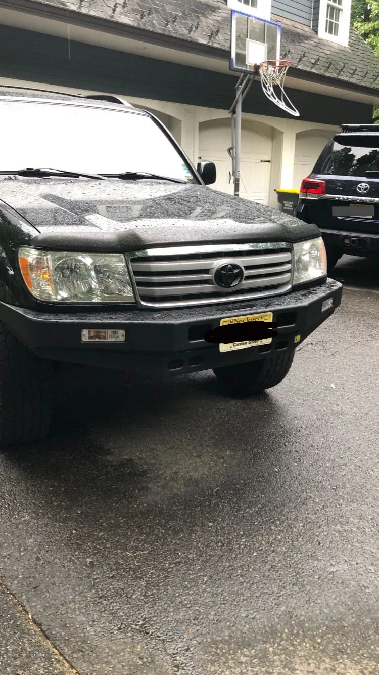

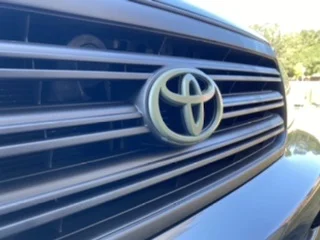

Thanks guys for the help! I just hit mine with the rattle can and I think it turned out pretty good. Although I think I want to go with a darker grey next time and black out the outer chrome. 👍
now I just need to touch up the lights and get some new rock sliders on...

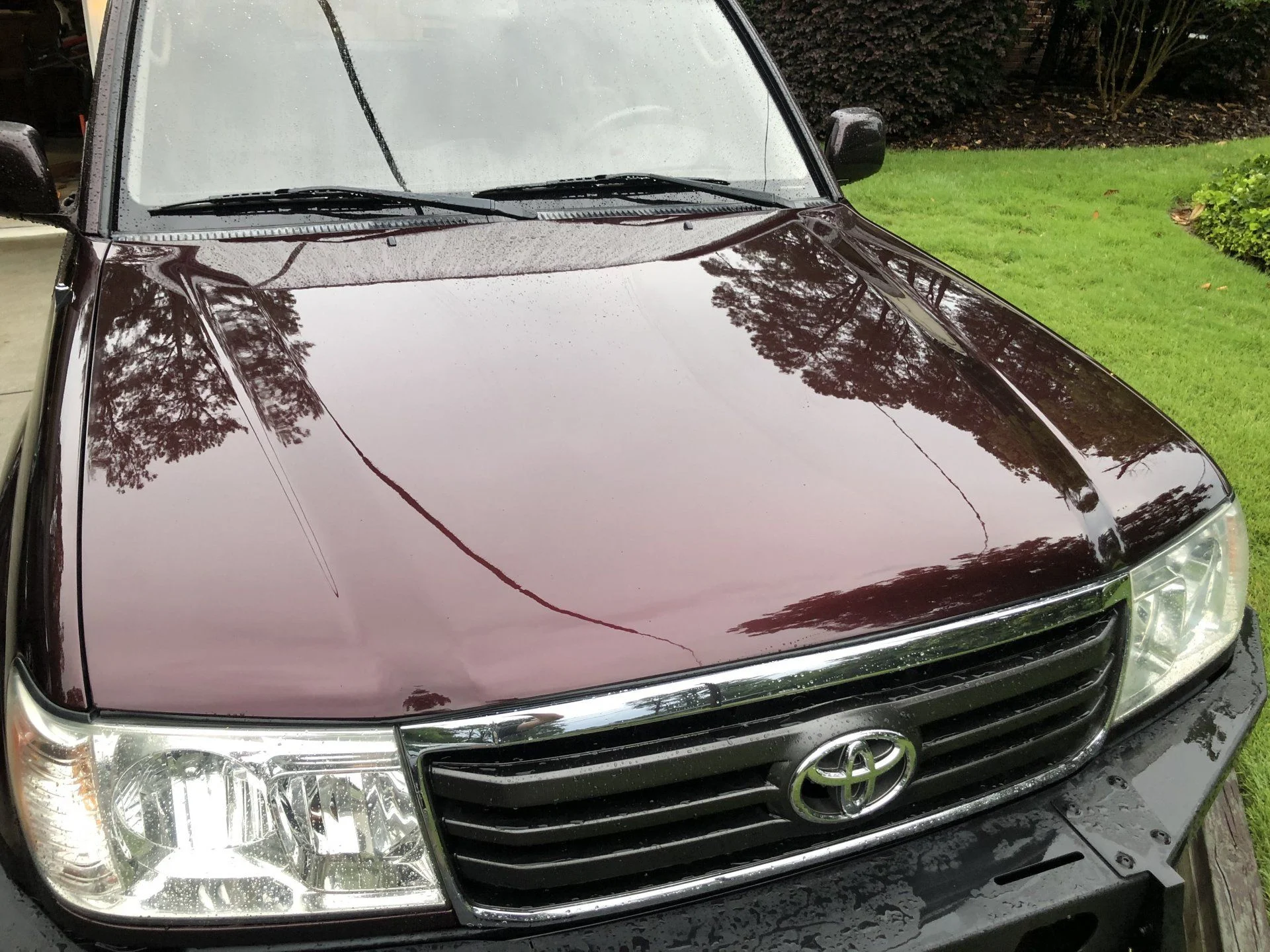

I had the fenders and hood done - $800
Hood - total color coverage
Fenders - color blended from top down
Hood and fenders cleared

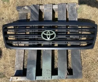

Bunking this as I saw some guy with a Dodge RAM using easy off oven cleaner to help expedite the ability to peel away the chrome on the grille. Got me thinking if it would work on our chrome accents
So the goal with the Easy-Off would be to take off the paint and the plasti-chrome - leaving the naked black plastic? If it worked, that'd be ideal - part of having to repaint these grilles so often is the chrome makes even the tiny chips just pop. I'd much rather paint dark gray over flat black.
I have no doubt the Easy-Off is a capable stripper (that's what she... sorry) I just wonder how it'll know to stop at the plasti-chrome and not damage the grille
agreed, and not sure if Dodge's manufacturing process is similar to Toyota's, his "plating" was peeling off although it did seem like a PITA to do but he managed to do it. I would love to be able to work on bare plastic vs having to deal w/ chrome
