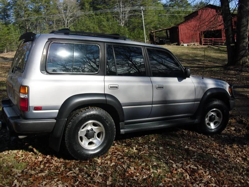

Sanded mine good down
Cleaned them very well with Mineral Spirit.
Used Rustoleum Spray can
Flat textured Black...............looks great,

Looks good! I like your black caps to match your flares.
