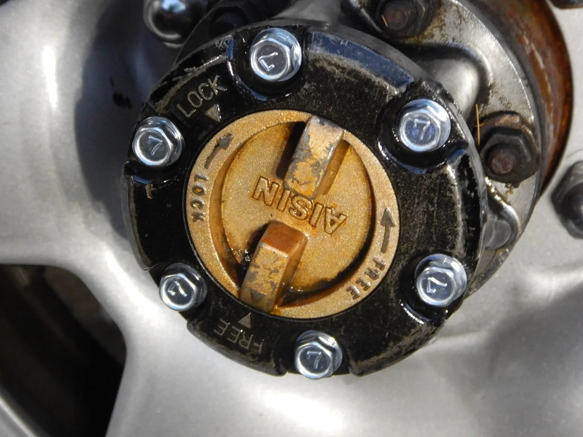

I've had good luck with VHT engine enamel and roll bar and chassis paints. Take a look here for their caliper paint, including red (mini-truck hubs) or gold (Land Cruiser hubs):
Thanks! Picked up a gold and black VHT caliper paints to do the hub cover, dial, and the extension from the rotor.

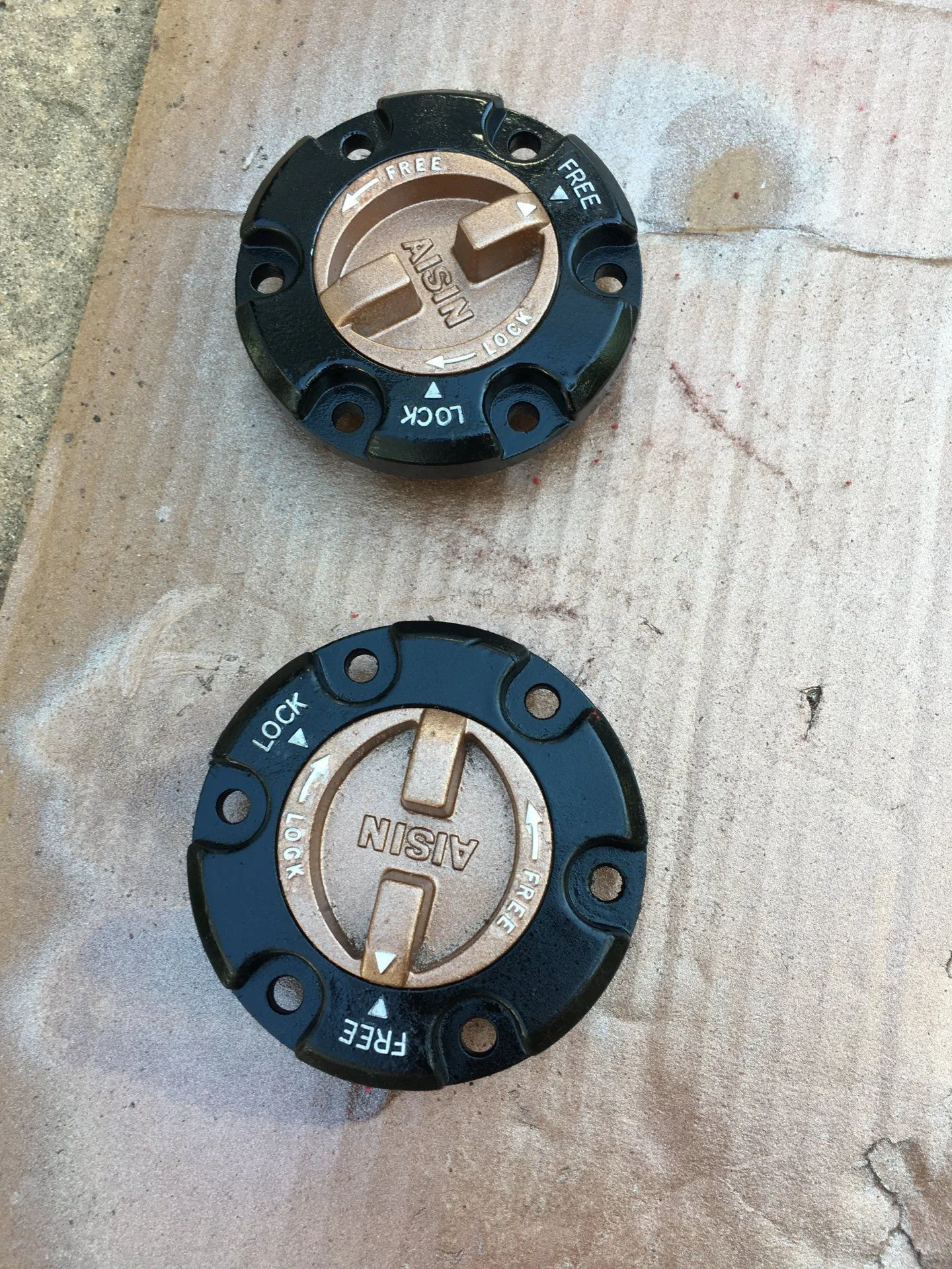

I did not paint the hubs but I painted the hub covers using brake caliper paint. The one you bake on after it dries
Curious...How did you keep the white raised lettering? Great attention to detail. Would love to know your technique for this. Thanks!
Trying to remember exactly but I believe I first painted the entire hub cover face white and then used Vaseline or grease over the top of the letters when I painted the rest so they simply wiped off
thanks. Great trick.
