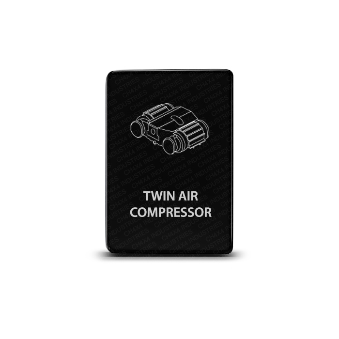

@Tex68w I dig the switch! How did you tap into the dash light? I had a separate wiring connector in the dash that wasn't connected to a switch. I cut the green wire and spliced into it. Seems to be working fine so far.
I used a crimp tap connector and ran it to the green wire on the headlight washer for LED light power and then ran the power line to an add-a-fuse and plugged it into the fuse below the steering column for the rear wiper.
