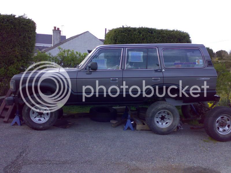

Landcruiser is currently looking like this;
Sadly the wheels are not connect to anything! as I'm rebuilding the axles...

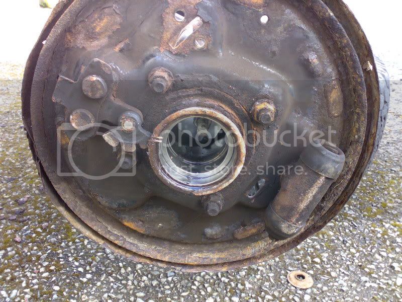

Started by removing the drums - easy peasy

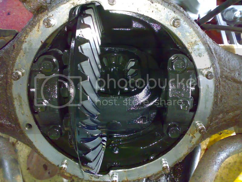

Removed the diff cover
and then unbolted the guide pin and took out the mini cogs pushed the axles in a removed the pins.

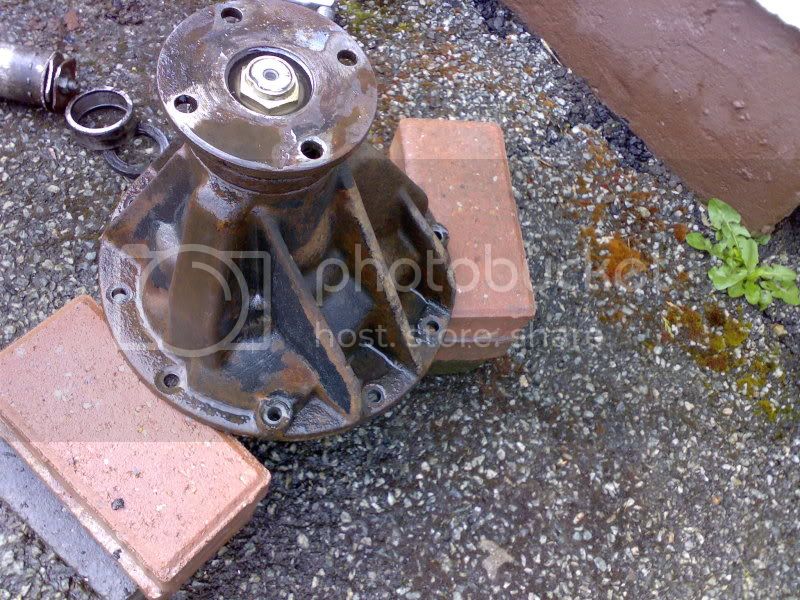

I then removed the differential;

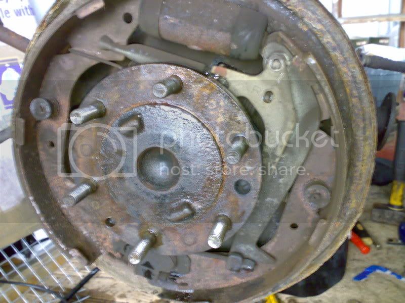

Now with all the brakes taken out;

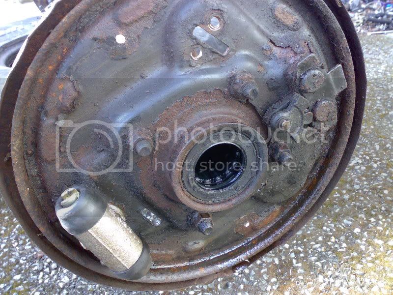

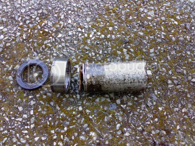

and you can see the seal and bearing. They actually seem to be in reasonable condition after 146,000miles no marks at all. However we are going to be driving across the Sahara desert and the last thing I want to be doing in 40c Sudan is replacing a bearing / seal - hence why I am doing them now.
Took out the seal and the innards of the bearing (carefully with a screw driver not scratching the surface)
To remove the bearing most manuals tell you to use a slide hammer, I don't have one and from reading around on this forum it seems easiest just to wack them out - so here is my technique.
I made up a little "pusher" with a bit of old exhaust and some bolts
then with a long rod of metal I used a sledge hammer to force the bearing out;

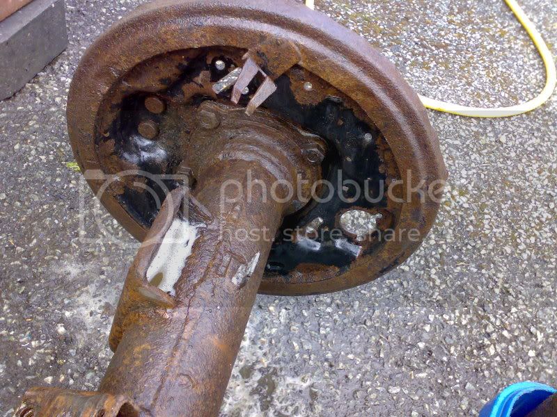

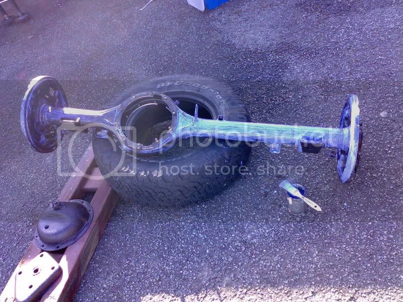

I then cleaned a wired the whole axle up.
Then painted with some Bilt Hamber Hydrate 80 Bilt-Hamber Laboratories - Corrosion Prevention: Hydrate 80 . This stuff is cool, paint it on sky blue and then it turns the rust black.
After letting the Hydrate 80 to dry I sprayed it with some good old Hammerite Hammerite UK - Metal Paint
and there it is left to dry overnight..
