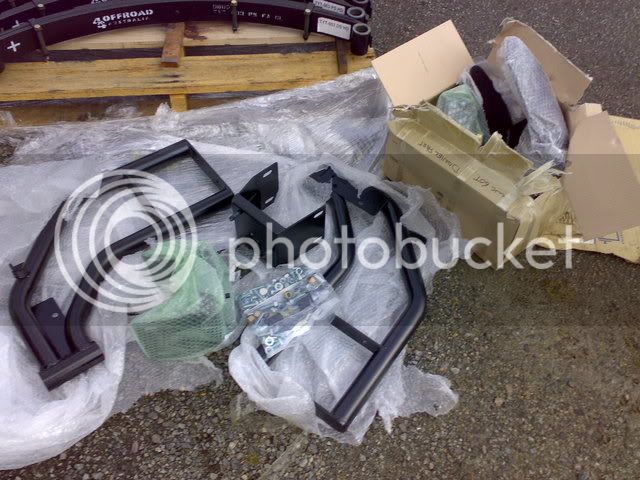

Woow woow - excitement today! All my gear from Australia (4wdsystems) arrived today! All looks like it shipped OK and everything is all there which is a good start.. Here are some pics..

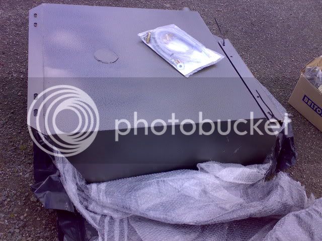

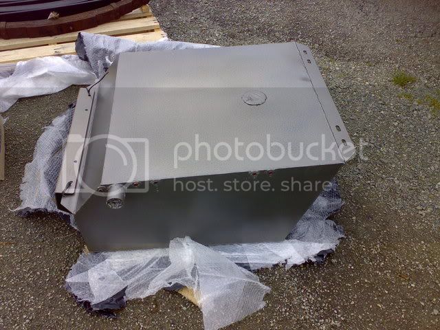

Guess which one is the fuel tank?
And the rest of the stuff slowly getting unpacked!
Fuel tank!

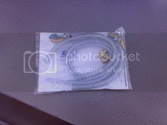

Fittings and instructions..

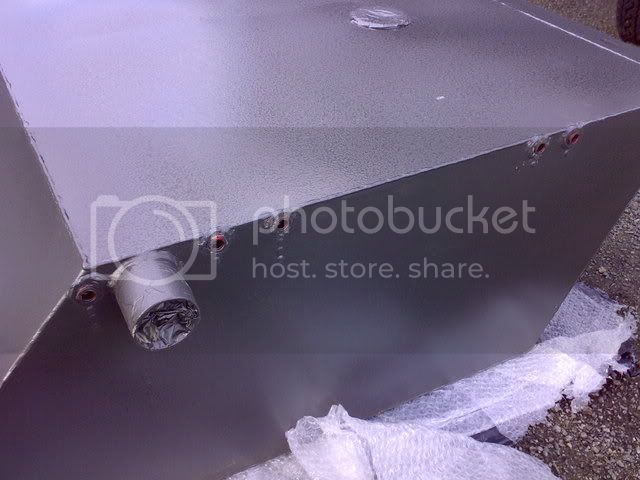

For those who are interested it does have space for fuel return (fits both petrol and diesel landcruiser)

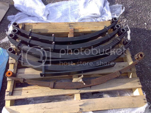

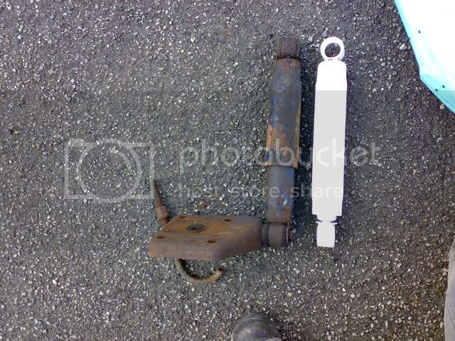

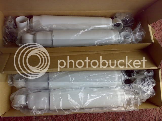

Extra heavy duty suspension (8 leaves at the rear) should cope with fuel tank and 2xwheel carriers.

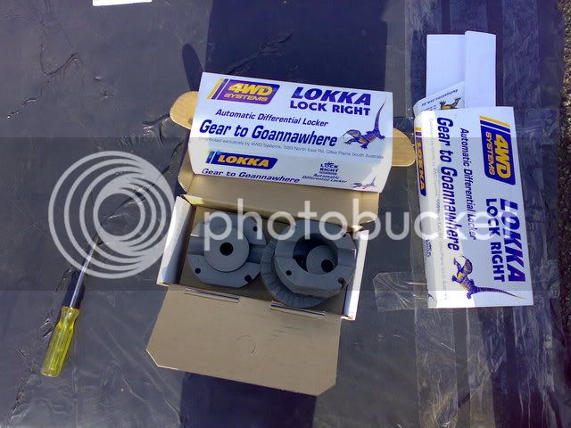

Lokka's (2x!)

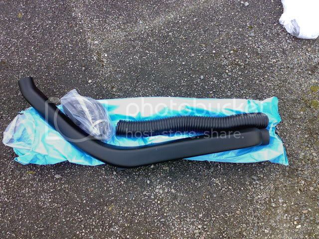

Snorkel
Dual spare wheel carriers, these are chassis mounted through the rear bumper

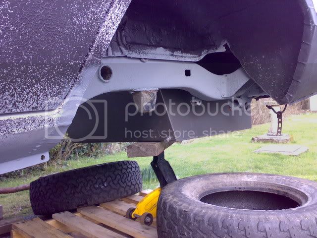

I had a trial fitting of the fuel tank and all the bolts all seem to line up and gives enough clearance for the exhaust / suspension.
Paint is seriously thin on it though - so I am repainting it before fitting properly!
I'm chuffed!

Fuel tank is 195 litres, which is 42.9 UK gallons or 51.2 little US gallons...
