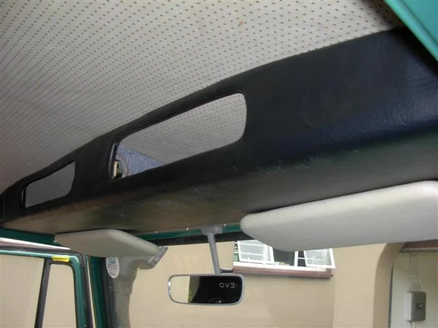

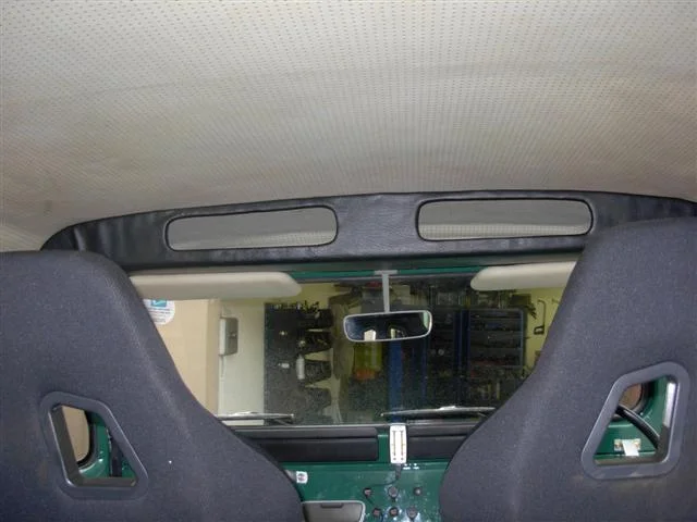

I went cheap. 1 - 1x12 pine plank, then had headliner and pad wrapped around it. Done with less than $20. Mounted it on the inside lip of the metal rain track portion, then put L brackets on each side and attached to inside door screws along inside top. Oh yeah, doesn't interfere with taking the top off, I just took my top off last week and the shelf is still there. In fact I did one in the back as well to mount some 6x9's. If you want more pics let me know.
I made my own
I used 6mm marine plywood, covered it with foam then with black pvc
the whole job only took an afternoon
