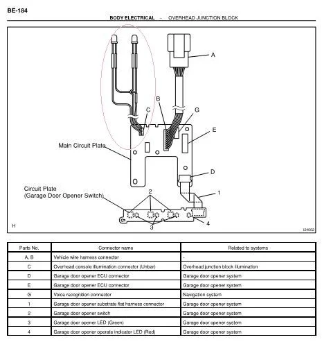

I have an 03 LC with the indentations, but no lamps. I can confirm there should be a part number out there somewhere to order the harness & lamps to just plug into the overhead console board, but I have yet to find it. I pulled the console on mine today and confirmed the connector is there and waiting. Operation wise, in my GX, these stay on as long as the headlights are on, so I would assume the circuit in the LC/LX does the same.
can you pull the GX harness and lights and see if it's the same? I guess they aren't soldered to the board?

Revisiting a very old thread regarding wiring harness for console illumination. I came across the part numbers for the harness for a late gen lx470 but it seems to have individual wiring harnesses for each bulb. I would find it hard to believe the LX has a different board for their overhead console? Am I missing something?
This was the only google image I can find

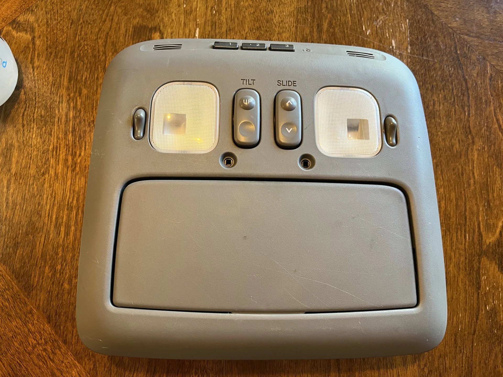

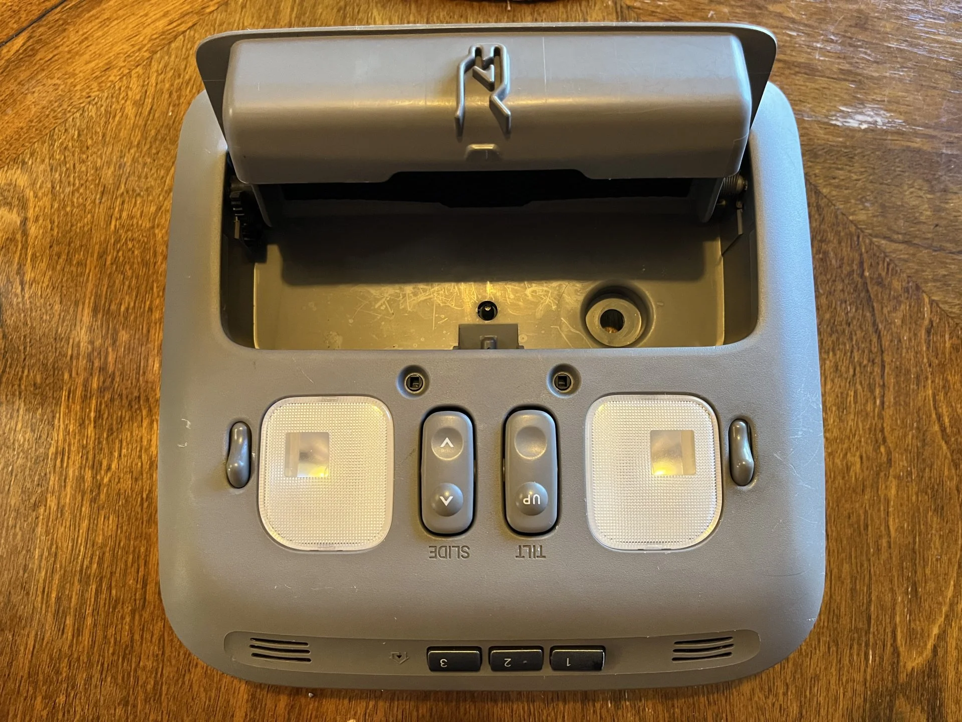

I’ve been slowly LXifying my LC, so I grabbed this overhead console from @customcruiser for the courtesy lights. 2007 LC on the left, 2004 LX on the right.
It’s a plug and play operation and everything works… except for the courtesy lights, of course. I’m guessing there’s more to it?
I’ve decided to let the LX console go. I don’t have the time or desire to figure out how to get the little LX lights to work on my LC. Asking $60 shipped within the continental US which is what I paid.
What didn’t work for you? I’m assuming the same thing as me.
I tried to install an LX console as well. I’m almost certain the main plug the LC has from the headliner doesn’t carry the same power as the LX one. I bet if we could compare the two plugs, we’d see more pins in the LX one. I, too, was hoping the LX part would be plug n play but it doesn’t seem like it is. I just went with splicing the map lights like everyone else.

Everything but the little lights worked. I'm a little surprised it wasn't plug and play, I would think the wiring harness would have been identical.
If I find the right LX, I'd switch to it.
