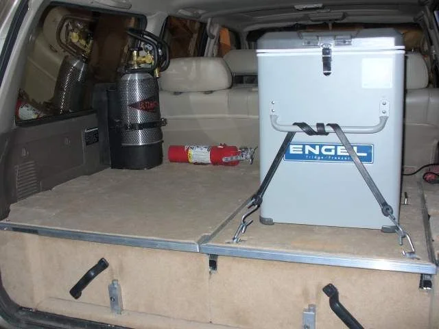

for comparisons. The African Outback drawers in my 80
attachment.php

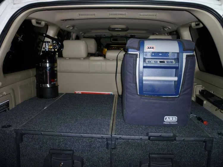

The ARB drawers in my 100
attachment.php
The handles are better. As mentioned, the cover for the side pockets has the screw latch rather than just flopping it on top on the old set
The fridge drawer slide also is better (stronger)
You can also stack these 2 or 3 high where I think the African ones came already bolted together
I think the drawers in the african are a bit wider and the ARB have more fit trim kit and larger side pockets
