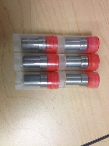

2014-10-27 11.28.25.webp Mine showed up today. Thanks for the link info.
Seats and washers on their way too.
Thanks, it wasn't that bad getting it fixed especially when having the proper tools for the job. I do have one injector that leaks so I must buy one. But other than that, boy am I a happy camper. Diesel all the way!!!
You mention proper tools. Other than the deep sockets you mentioned in the other thread where there other specialty tools you needed?
That's great that you got them! By special tools I meant 24mm and 27mm deep sockets and torque wrench. Makes a whole world of difference. I ended up ovalinzing one of my nozzle holders and I have a slight leak, and that is because I did not have patience and I used an adjustable and the vise to open them up. So i need a new injector. But regardless, the job is a one banana in my opinion. My black smoke has not gone away so my next step is a turbo I guess. My fuel screw is also all the way in, so i assume no one tampered with it. I'll just leave it be for a while cause she runs good and I'll turbo it down the line.
