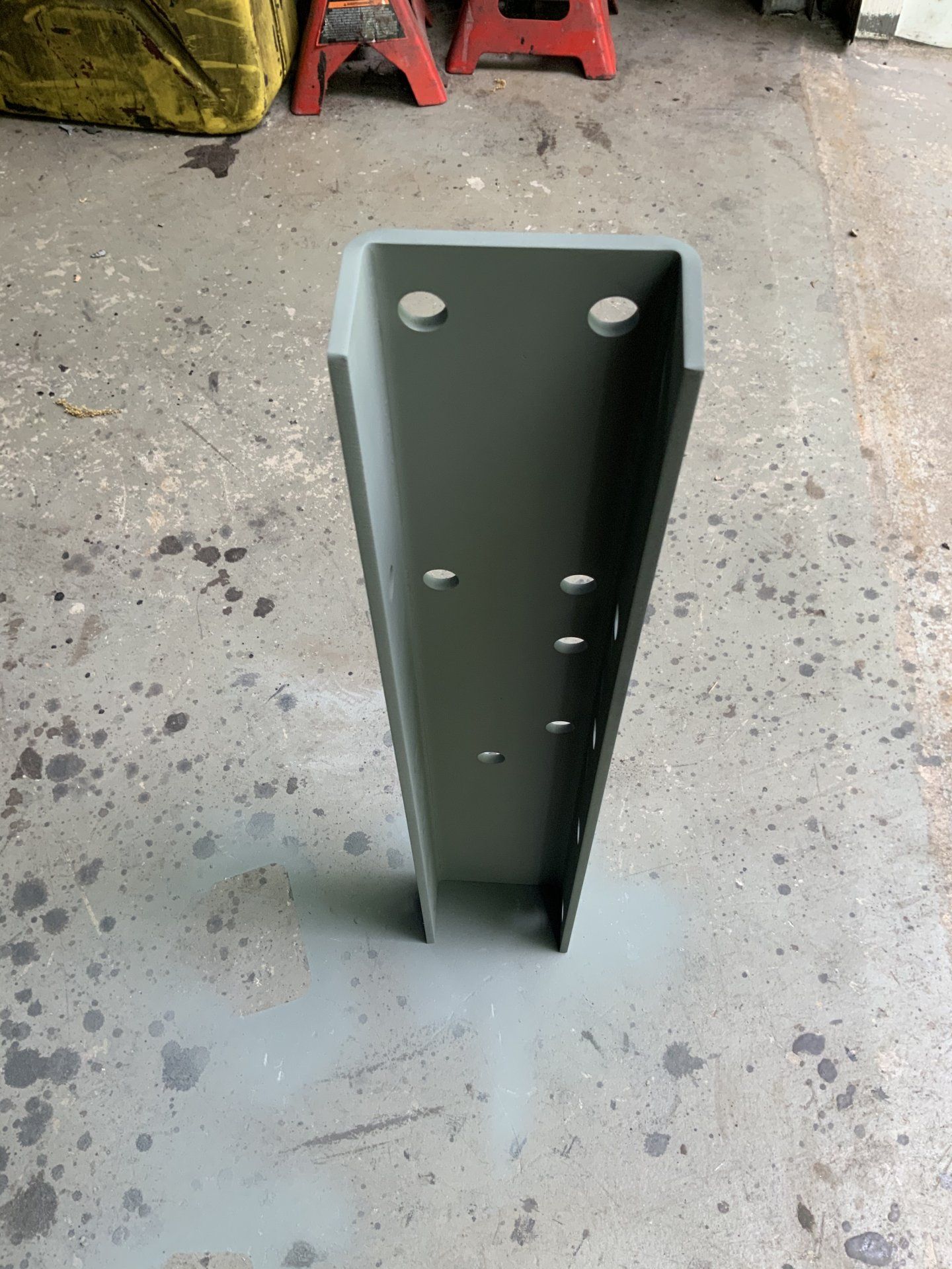

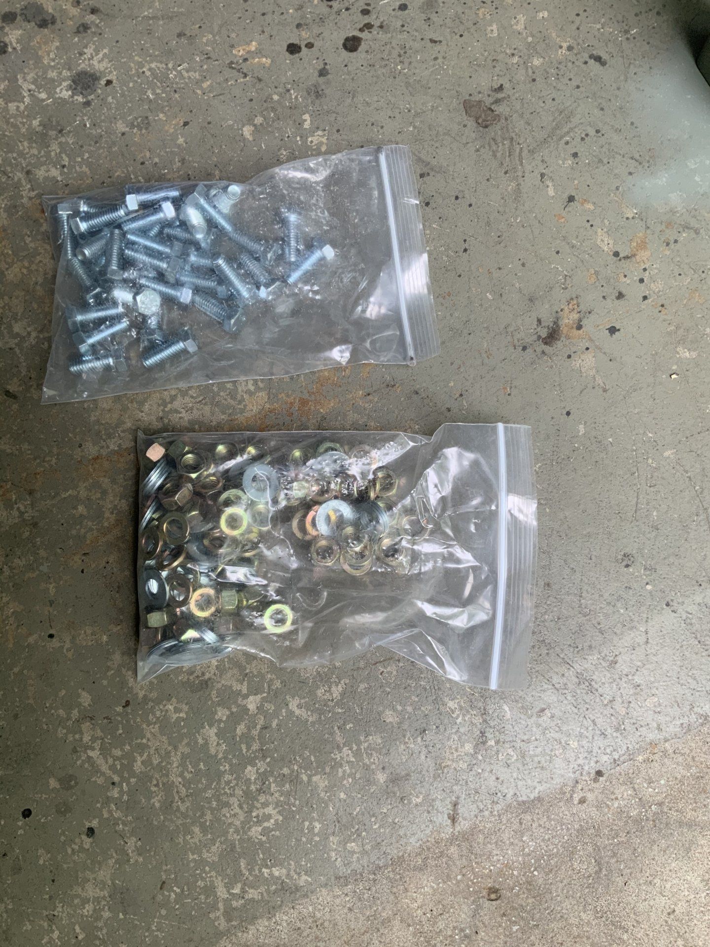

This week I haven’t done anything really, other than welding in the inner fender lip. I did however get a nice surprise this morning, namely, the TrailTailor rear frame inner channel repair pieces. Thank you Jason and co! Have them self etching primed an ready for some chassis black. With so much to do on the truck, I think it’s best I tackle these first, since they are under the truck and I have most of the stuff out of the way now.

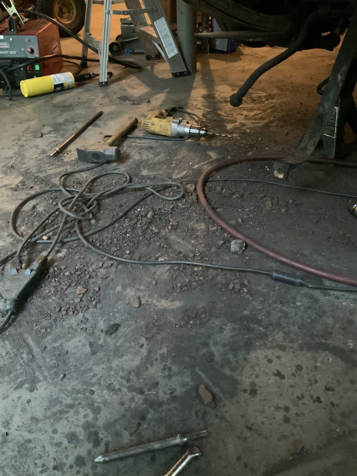

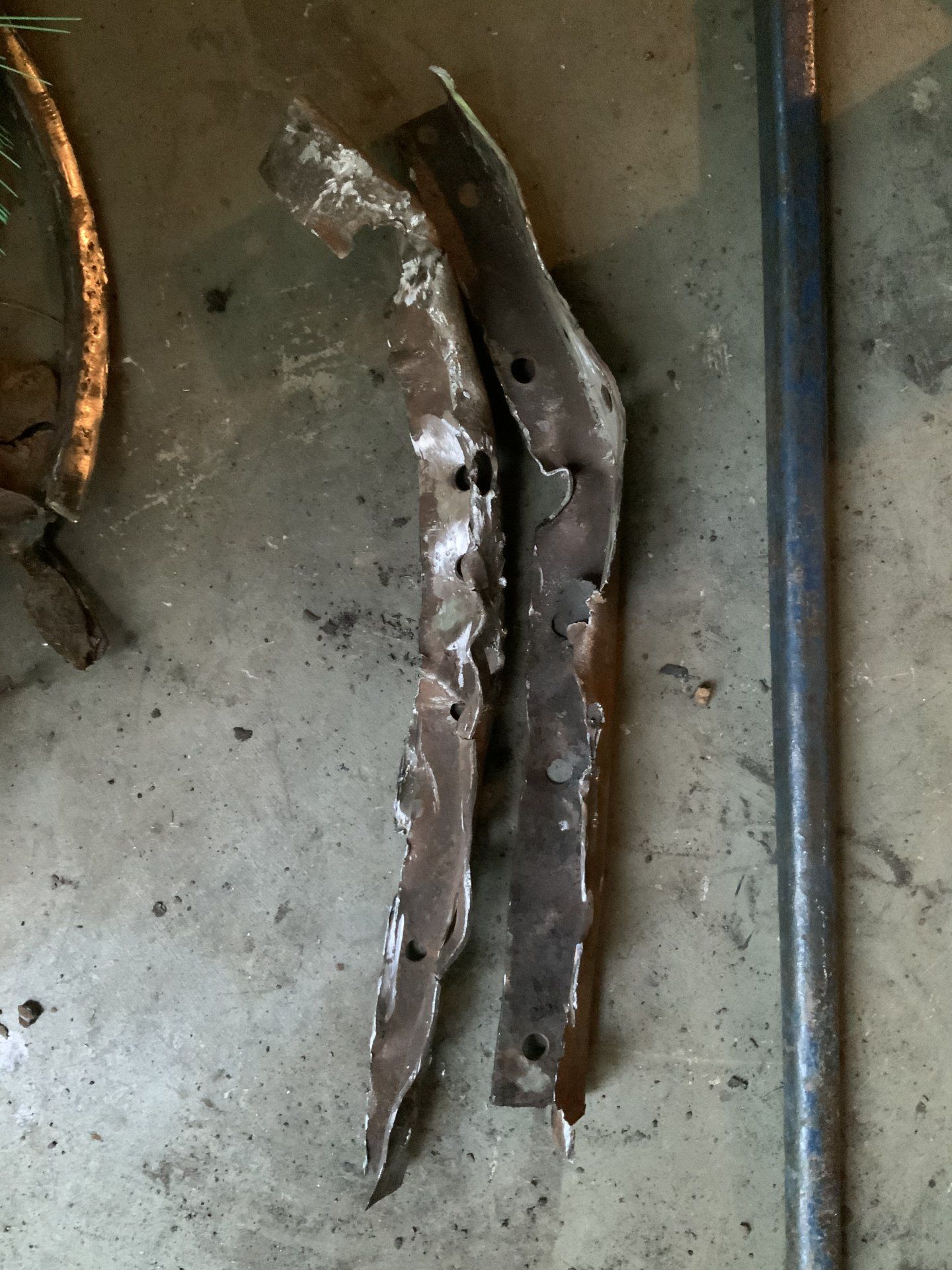

So today I ran out of welding gas and I thought to tackle the rear frame inner channels. Holy crap, what a s*** show. After 3 hours, I called it quits, and it’s not cause lack of tools! Grinder, pry bar, air chisel and a drill later, and I still have only managed to remove the left hand side channel. The rivets, forget it. I have to drill them out. I cut them and ground them flat but they still won’t come out! There’s no way those are going to budge. I was lucky with one or two of them, but hell if those things are going to come out...Made a mess again, and have only managed to do 25% of the job.
Any advice?
Yep, unfortunately.
I saw on here in someone's thread that an air chisel will make this job child's play. Pfffttt, other than easily removing the heads of the rivets, it was pretty much useless. I mean it helped with prying the channel off the main frame, but a giant prybar, and cutting the channel length wise is what did it.
Also, notice, I did not remove the spring and shackle but rather tac welded the spring perch into place. Wanted to eliminate a step there in the process.
I guess tomorrow I am going to try and drill the remaining rivets.

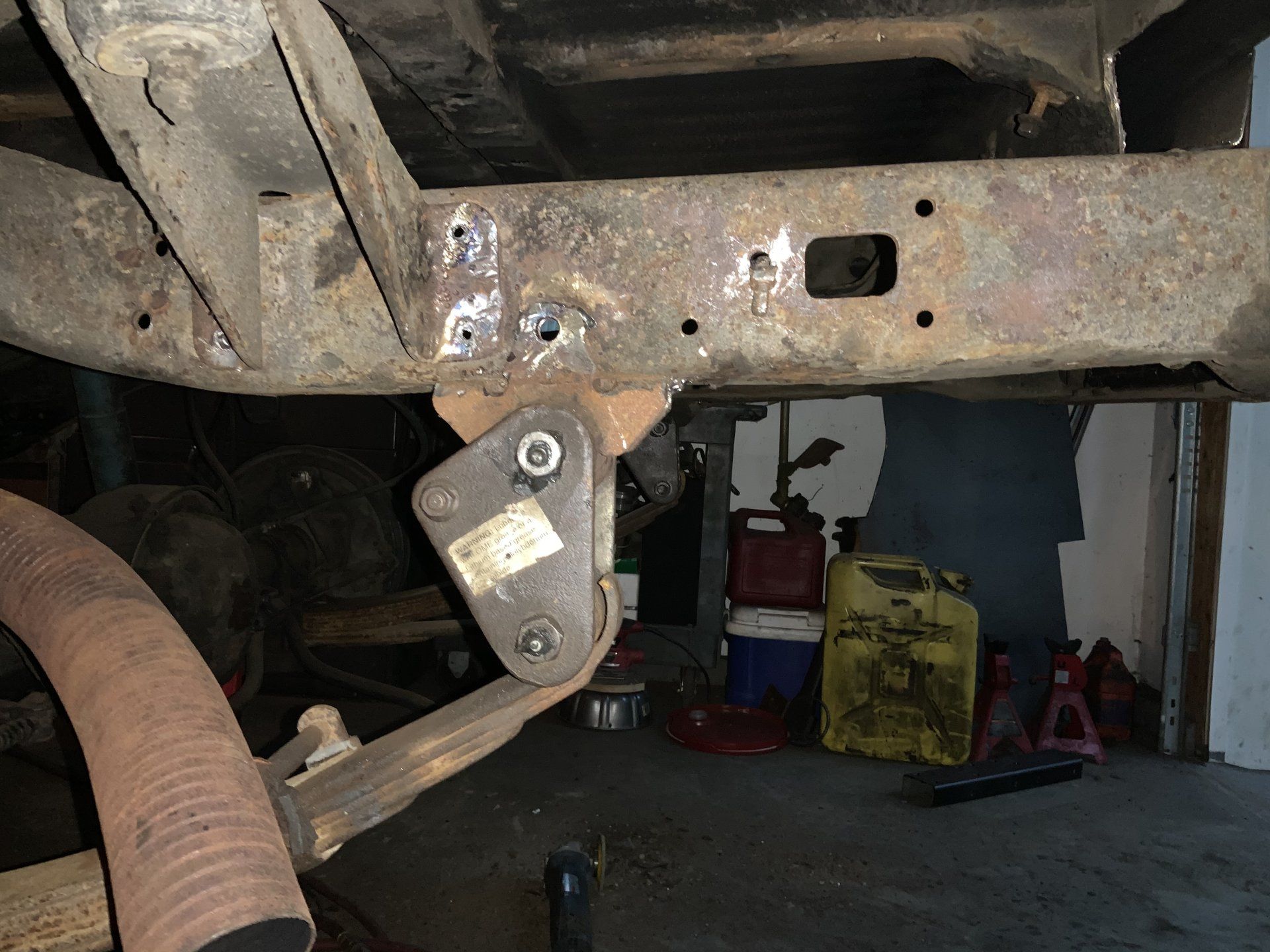

OK, so today finished installing one side of the Trail Tailor frame reinforcement channels. Let me just say that one side took me start to finish, an entire 6 or so hours. I have taken out the transmission while laying on my back, done a bunch of crappy work on his truck, but this here process takes the cake. I don't even want to start on the other side. Hopin' the other side will go smoother.
Here are a couple pics.
