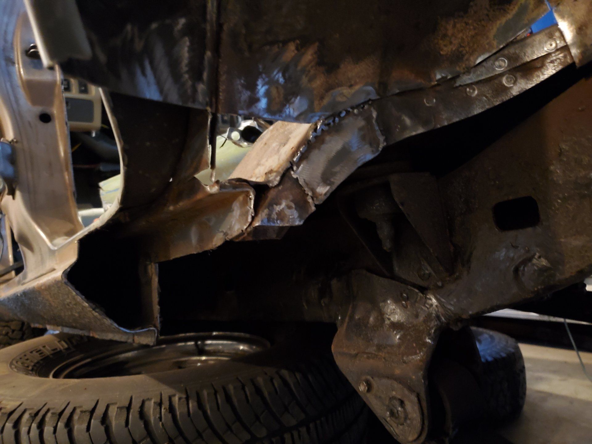

Little by little, getting this puzzle put together. It takes some deconstriction before assembly takes place. I cut this chunk out of my spare truck and I had to take it apart into pieces so that I can make it work. I am so close to buttoning up the drivers side, I can see it already!!
Yep, I am already happy to have cleaned out this side. Little bit more and then on to the passenger side...then doors and lift gate.
The small patches should be easier though.
Oh, thanks Onur, I know man, welding sheet metal is not to bad, the grinding part is what sucks.
And so I say good bye to the drivers side and hello to the passenger side...for now anyway.
Don't know if I should do body work or not. Never done it before so not sure what to expect. Can't be more difficult than welding in new metal.
Right now I am just aiming for getting rid of that obvious rust.
I am pleased with the results!
