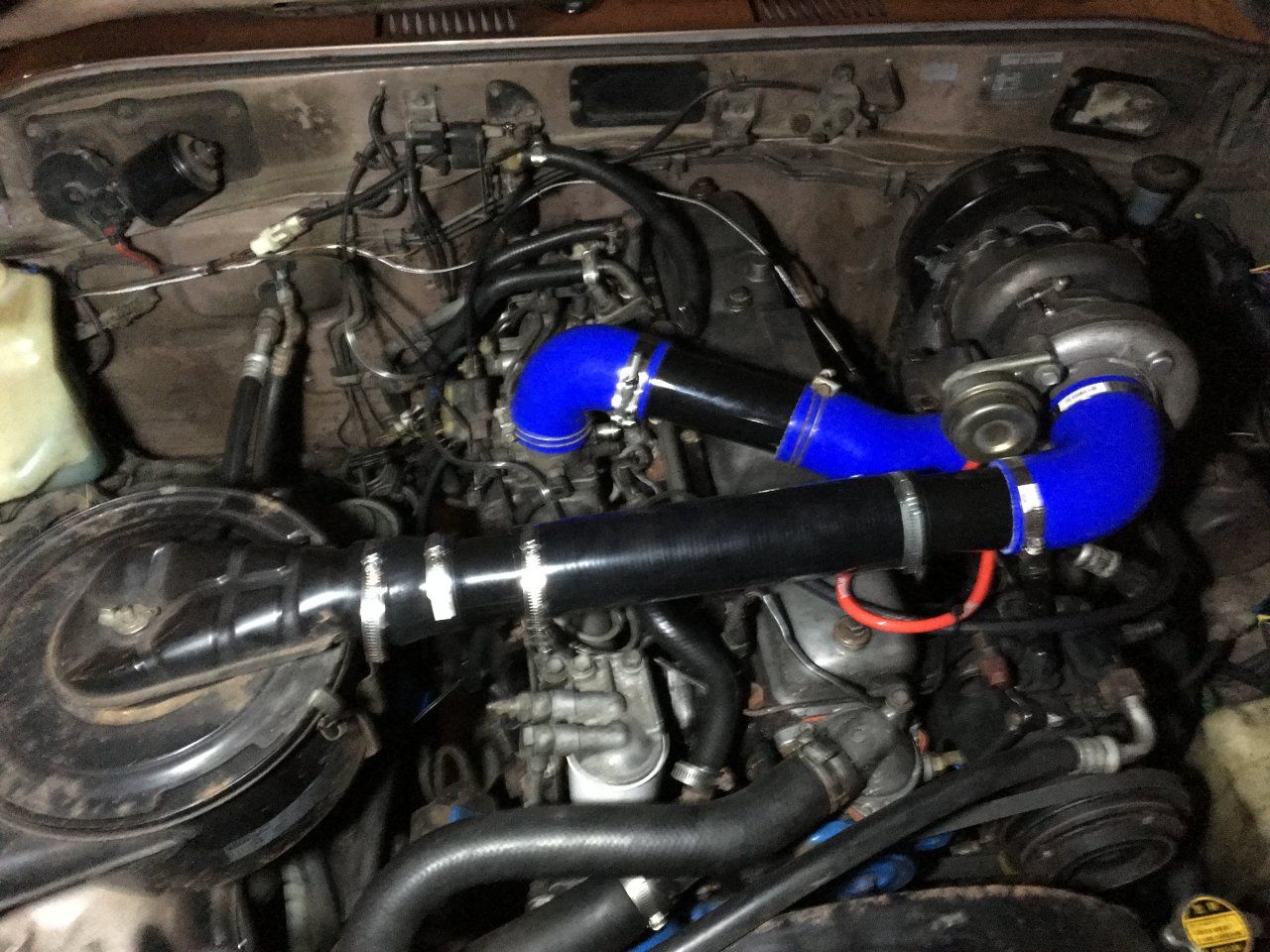

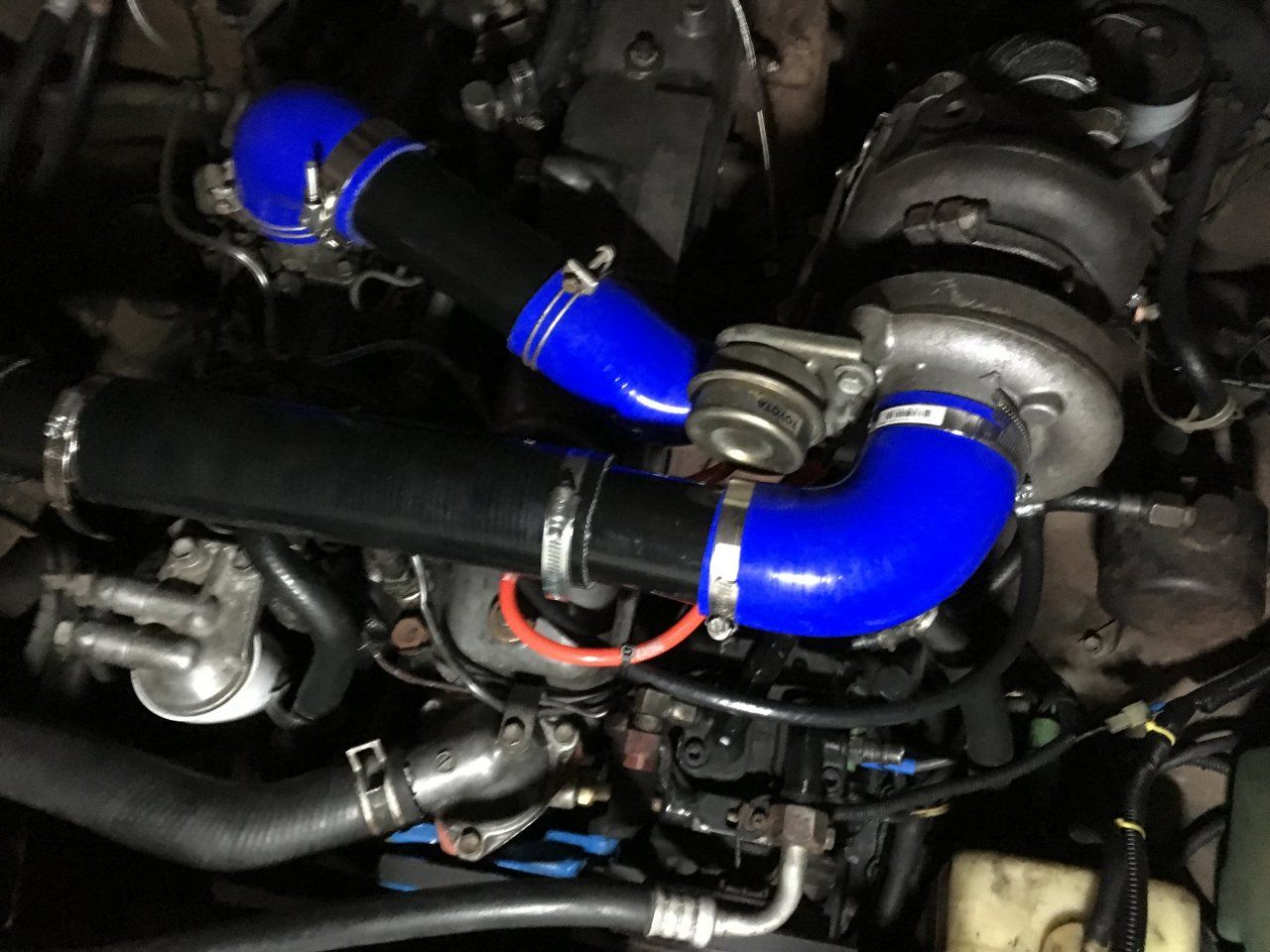

Almost done! Just need to relocate the valve cover breather hose into the intake pipe coming off the filter and cap the intake throat inlet where the valve cover used to connect to before.
I'm going to cut the hood tomorrow and let the turbo stick out gloriously through the hood, ha.

So after a couple days of driving here are my findings. I managed 21mpg, mostly highway. I also noticed that it runs cool as before, maybe if I really lay into it, the needle would climb just a little higher on the gauge. There is one thing that I have a question about. My egt's are spot on for cruising around 550 or so but if I go uphill and really give it the beans, they climb past 1000 real easy. In fact I back of at around 1200 as I know that that is the danger zone, but I see that it would just keep climbing past 1300 with ease if I keep going. The truck feels powerful and I wonder if te po had messed with the fuel screw before. I have not yet touched it. Also the truck smoked excessively before the turbo (black smoke). I did a bunch of reading and searching last night, so that's why I am posting today.
Based on all my research, an intercooler would be a good way to drop the egt's. Looks like I'm going to have to plan for one of those.
