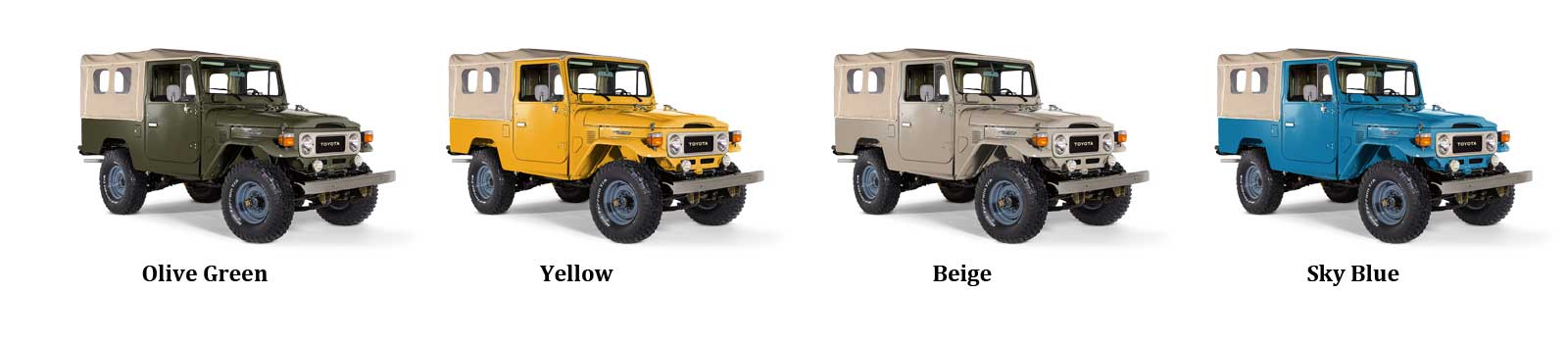

I like the green the best, but seeing as it's a Copperstate/AZ I think the Beige would fit and look best for this vehicle.
Of course Beige is my second favorite color too. :-D
The Olive with the light colored soft top will pop and stand out here in the desert environment. I like beige but it will blend in with the natural surroundings and might not be the best bang for your buck from a exposure standpoint. If the yellow was actually the factory Mustard color (insert actual color code here) then that would be my choice.
.... we could use your help deciding on the color for the build. We've rendered the few options we're considering below. Thoughts???
Thanks to all of you who have shared your opinions on color. There's still time to throw in your color into the mix if you haven't done so. By the way these are factory tones we're talking about.

Still haven't decided on the color, so feel free to jump in with your suggestions.
Very nice. Love your guys work. Follow you on Instagram.
I vote mustard yellow on the paint. It's a "racing" 43. With decals and such, yellow really pops and stands out as a desert racer.

1. Color: We've decided to go with Olive. After getting everyones input (THANKS!), we think Olive will contrast beautifully with the desert while keeping the 43 looking vintage.
