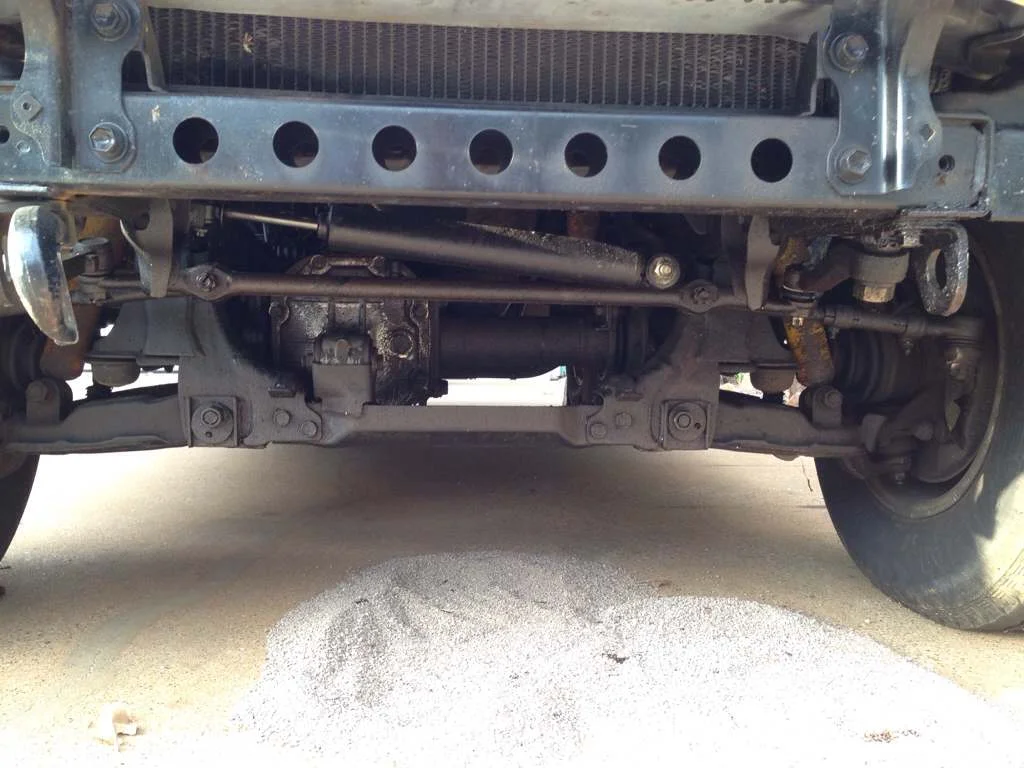

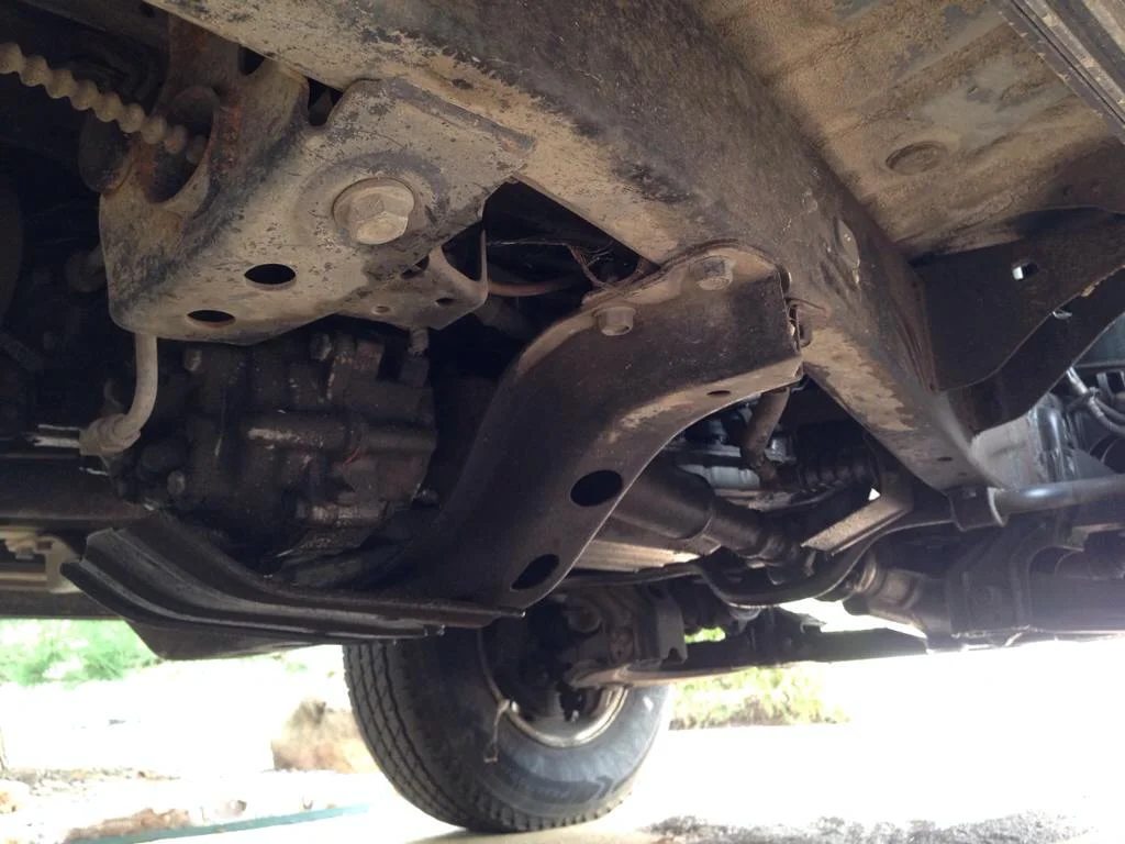

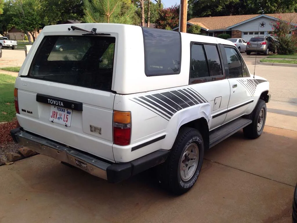

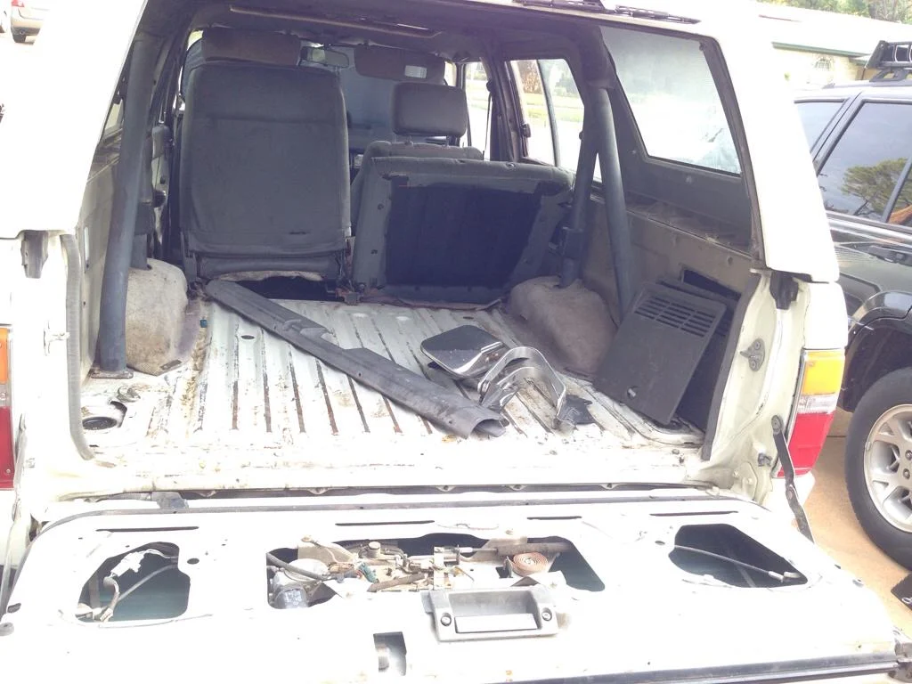

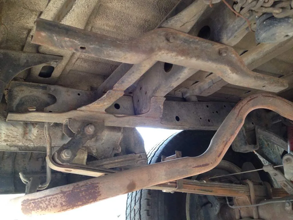

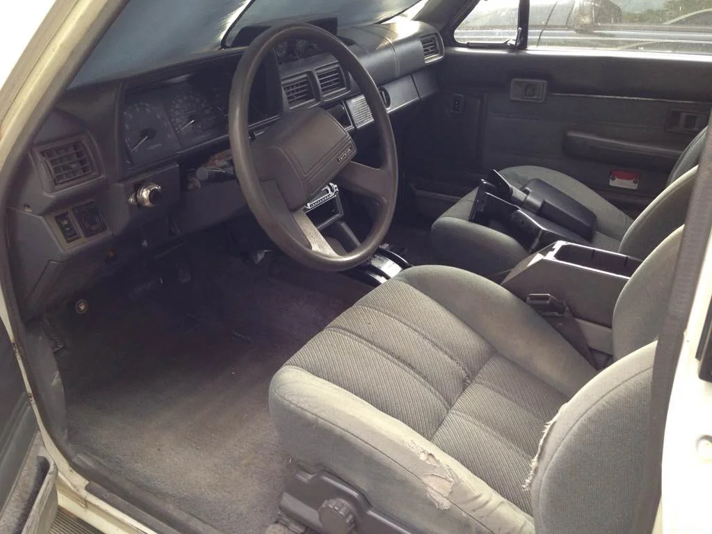

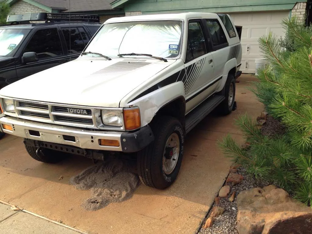

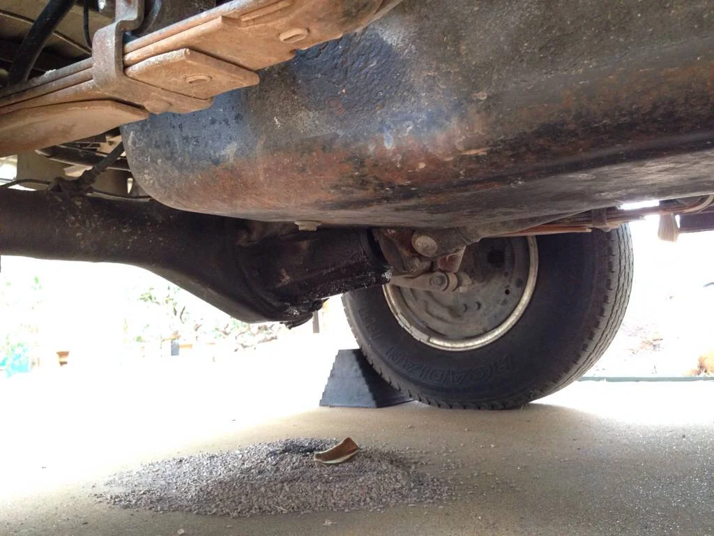

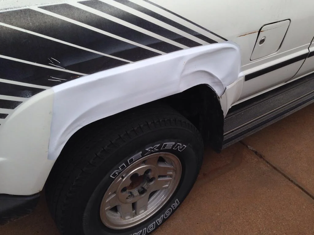

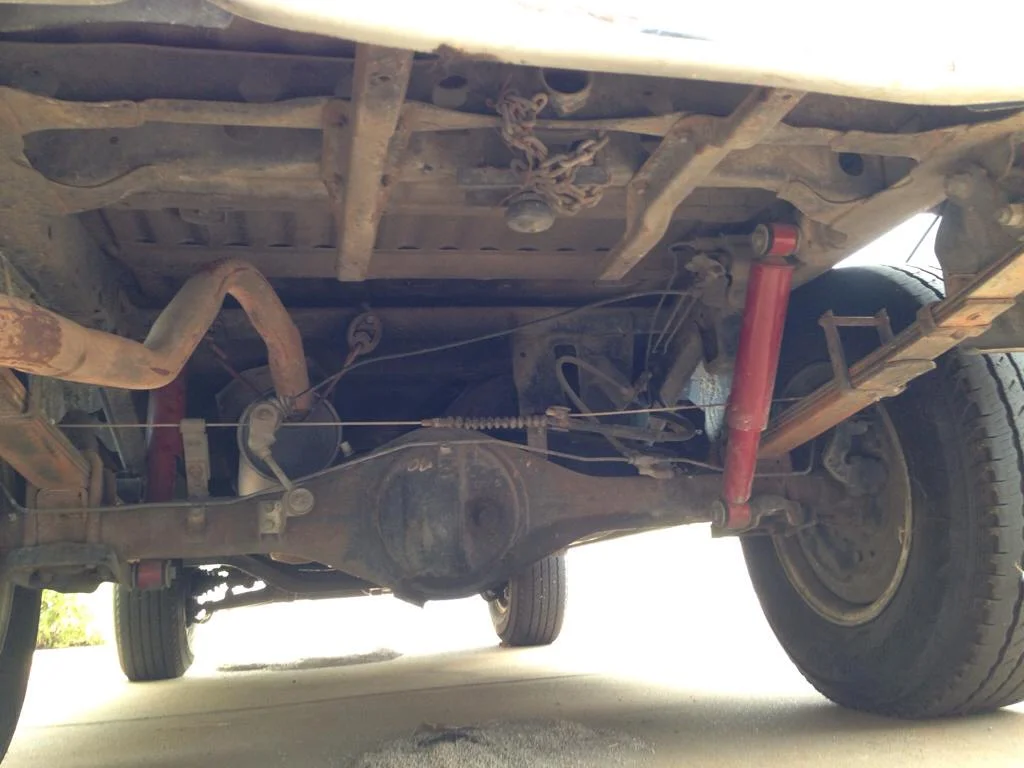

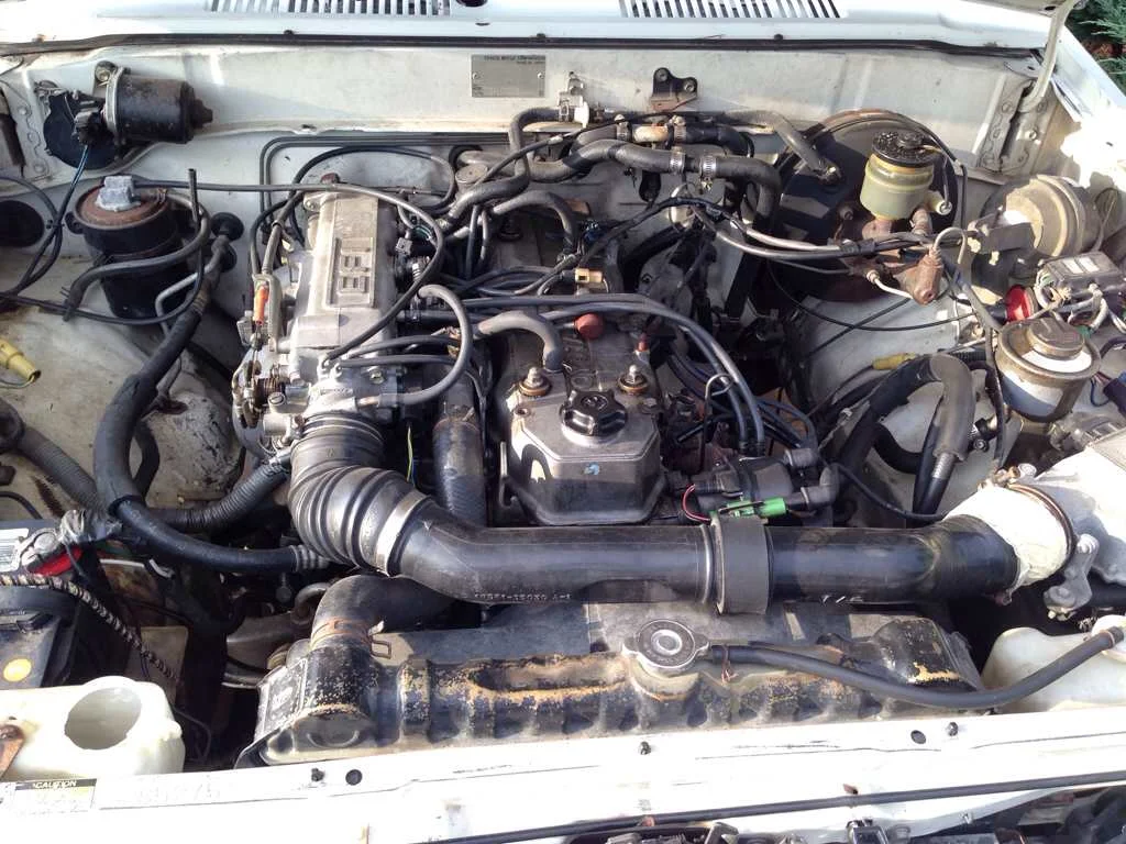

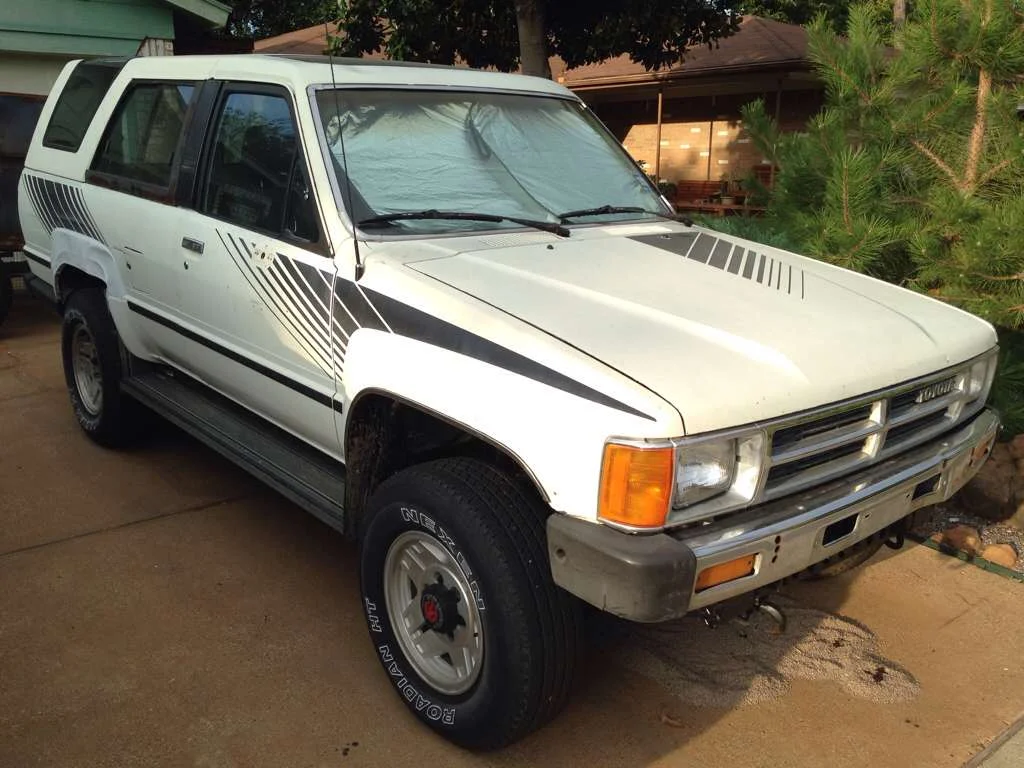

Here are pics of her current state:
That should give a basic idea of where I'm starting from.
-Daniel Kent

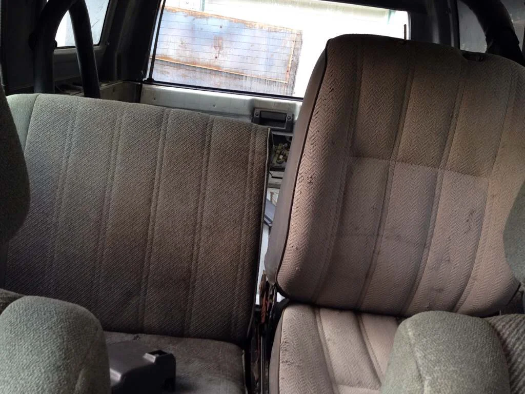

Wow, you have your work cut out for you, that's for sure. WTF is up with the rear seat?
I know, seems to be my life story. Lol. The rear seat was the PO and I'm in need of that side of the seat as well. Although if we have to part out our BJ60 then I may see if the seats from there will fit the 4R.

Never heard this. Where specifically are they supposed to be weak? You might be thinking of the late 90's Tacomas.
Well I'm not sure where, but I thought I heard the front. I thought I saw frame reinforcement plates for it online. If it's not needed I'd rather not do it.
I have several dash pads and cluster surrounds in my stash, no longer needed. Similar fate planned as the sunroof.
Interested in this as well.

I see that your intake tube is "sealed" with masking tape. I have the whole tube as well as the two rubber boots. PM me if you are interested.

Awesome!!! Love those 4Runners. Whatever you do, make sure you keep or re-pro those KICK ASS 80's graphics. They make those trucks in my opinion. :grinpimp:
Thanks Sam! Those graphics are sweet, but for now they are coming off to repair and inevitably repaint in the future.
Thinking of doing the rear spring between the leafs or add a spring to fix the sag.
