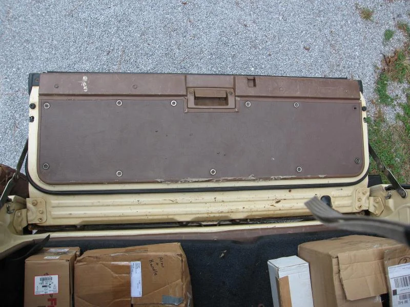

Like many of my "winter" threads, I didn't intend to post this until sometime around August when I am actually in the US and have the time to complete the "plan". However, the "plan" is more or less finalized and my Brother-in-law was kind enough to take a few photos for me, so what the hell.

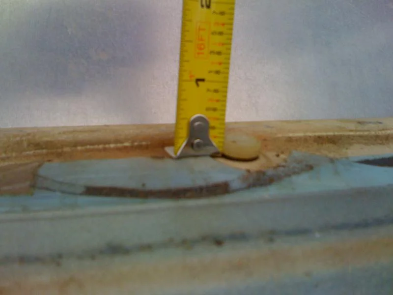

Here is my 1985 4Runner tailgate in its current state and a close up of the plastic insert under the vinyl cover that the screws go into.
I happen to peruse the 80 forum often and I got this great idea courtesy of CDan: throw that vinyl *** away and get some 1/4" aluminum plate to replace it with. Well that sounds great but you have to cut the plate, etc. but I took measurements last August anyway.

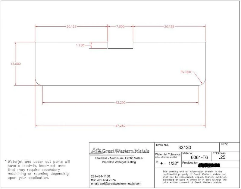

I then drew the dimensions up on Google SketchUp and started asking for quotes via the internet on a cut piece to fit. Now if you want to do the cutting yourself, all you need is a piece of 12" x 48" sheet as the outside dimensions are 12" x 47.25". I'm kind of lazy and didn't want to fool with the radius cuts. Anyway, I found this great place which would cut to my specs and deliver for a very reasonable price:
Great Western Metals - Water Jet Cutting Specialists
For about $85 (plus around $20 for shipping from Houston to Alabama), they redrew my sketch in Autocad and cut the 6061 Aluminum plate with a waterjet.

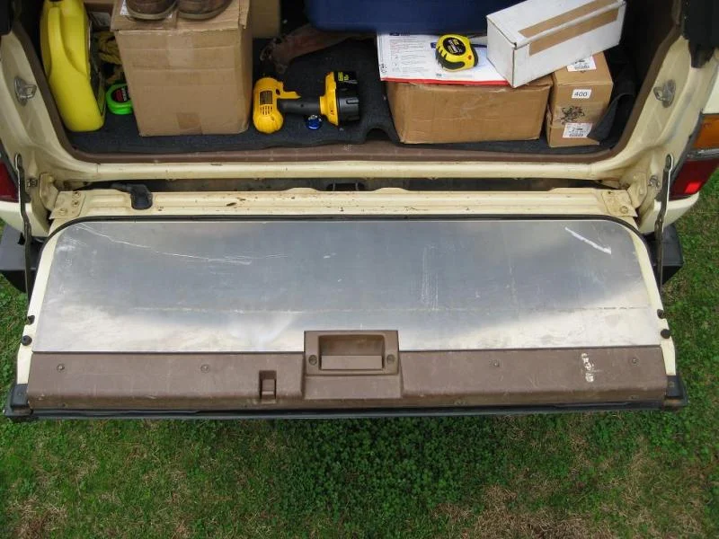

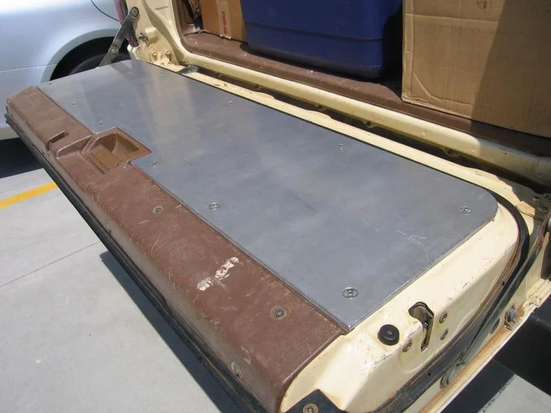

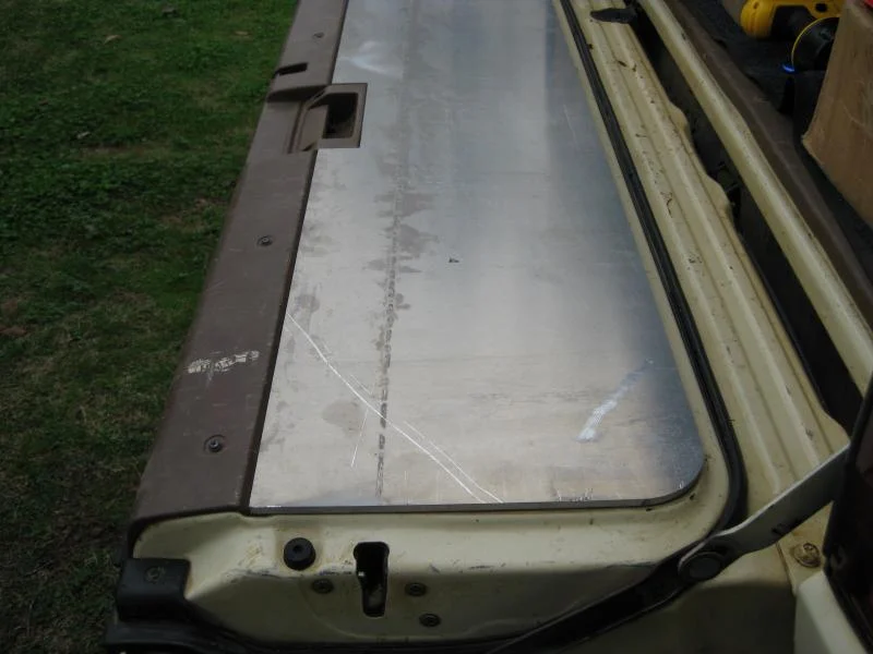

The first photo is their Autocad drawing and the others are the "test" fit that my brother-in-law was kind enough to perform.

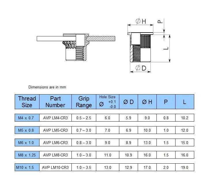

So in what OTT manner do I intend to attach this plate? Well the plastic insert sits in a 1/4" square hole. I intend to remove the plastic inserts and to drill the square holes out to 11mm diameter and then install an 8mm nutsert in the hole. I will then use 8mm stainless countersunk screws (11 total) to screw the plate down and of course I intend to countersink them into the Aluminum plate. The photos are of the screw and nutsert cut sheets. According to my calculations, 30mm should be the correct length for the screws.
If you use these metric screws, you need to use a 90 degree countersink. Most American thread type countersinks are less than 90 degrees. Also it looks like I will need about 1/4" of washers between the plate and the nutsert. I intend to use delrin or some equivalent, relatively hard plastic.

I am not affiliated with Great Western Metals in Houston in any way but if anyone wants one of these then all you have to do is call and reference their drawing number and they will cut one for you. I recommend the 6061 plate, it's very rigid aluminum alloy but they do carry other alloys. I believe the salesperson that I dealt with is named Carol. She was excellent to deal with, especially since I only wanted one of these!

Google Sketchup was a great tool to use to sketch the plate dimensions with. You can choose 2D and any units that you want for the drawing. It also allows you to export as a jpg so you can email the drawing to anyone with a PC. That helped when I was trying to get quotes via the internet.
Thought I would post a pic of the final product. I used a drill press to drill and countersink the plate and then drilled through the holes with an 8mm bit into the tailgate before enlarging the holes to install the nutserts. You have to make sure with the nutserts that they are perfectly aligned with the holes in the plate as 1/4" aluminum has no give. You can't see the detail in the photo but the 1/16" round-over router bit really put a nice smooth edge on the top edge of the plate.
