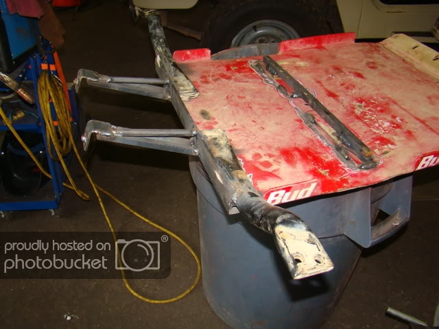

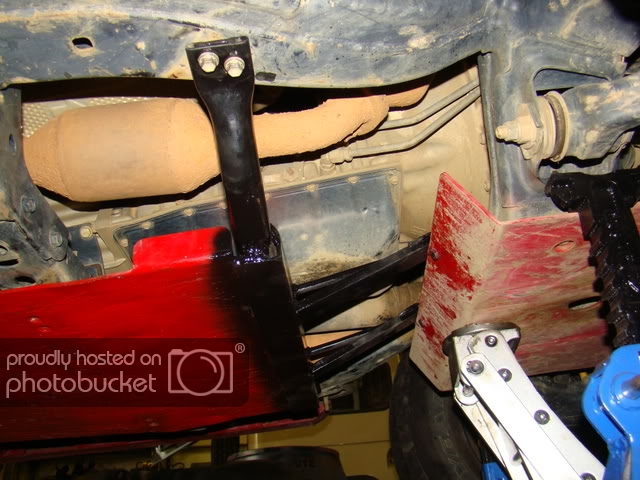

Got my middle skid all figured out with the help of the guys at ACC. There were four bolts that held it to the stock cross member. All four weld nuts mounted inside that cross member had popped loose and I couldn't tighten or remove the bolts. We got them all out and then reinforced the skid laterally where it touches the cross member with some steel bar stock. Also re-established a comfortable gap between the exhaust cross-under (cross-over is not technically accurate ;)) and the surface of the skid plate.
Then we removed the CAT protection bars (those diagonal handlebar looking pieces that go from the frame to the cross member). Swapped them from left to right and amazingly they bolted right up to the frame and lined up with the leading edge of my skid. Measured and marked everything and then tacked the bars to the skid. Then everything came off and full welds and a little bit of angle iron were added. A little more red paint and now I'm back in business.
