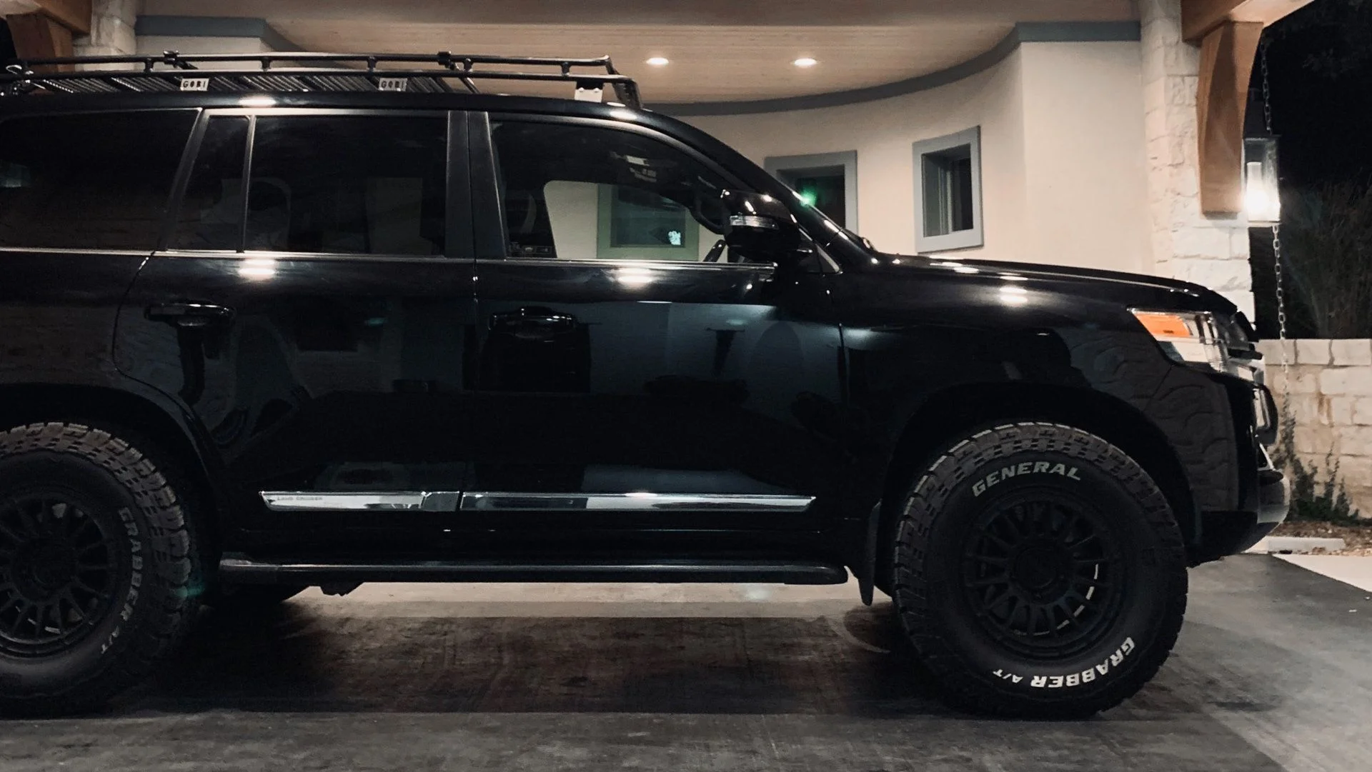

And thank you for the kind words! The 0 offset is certainly something different, but I feel it's nothing too extreme at all. Adds a bit of prerunner flair to the overland build. I feel like being between 18 and 25mm offset is really the sweet spot between a planted look and functionality for wheeling. The 0 offset might restrict me from 285/75 or 305/70 in the future.
It sits pretty nicely with the 0 offset and 285/70, so I can't complain:

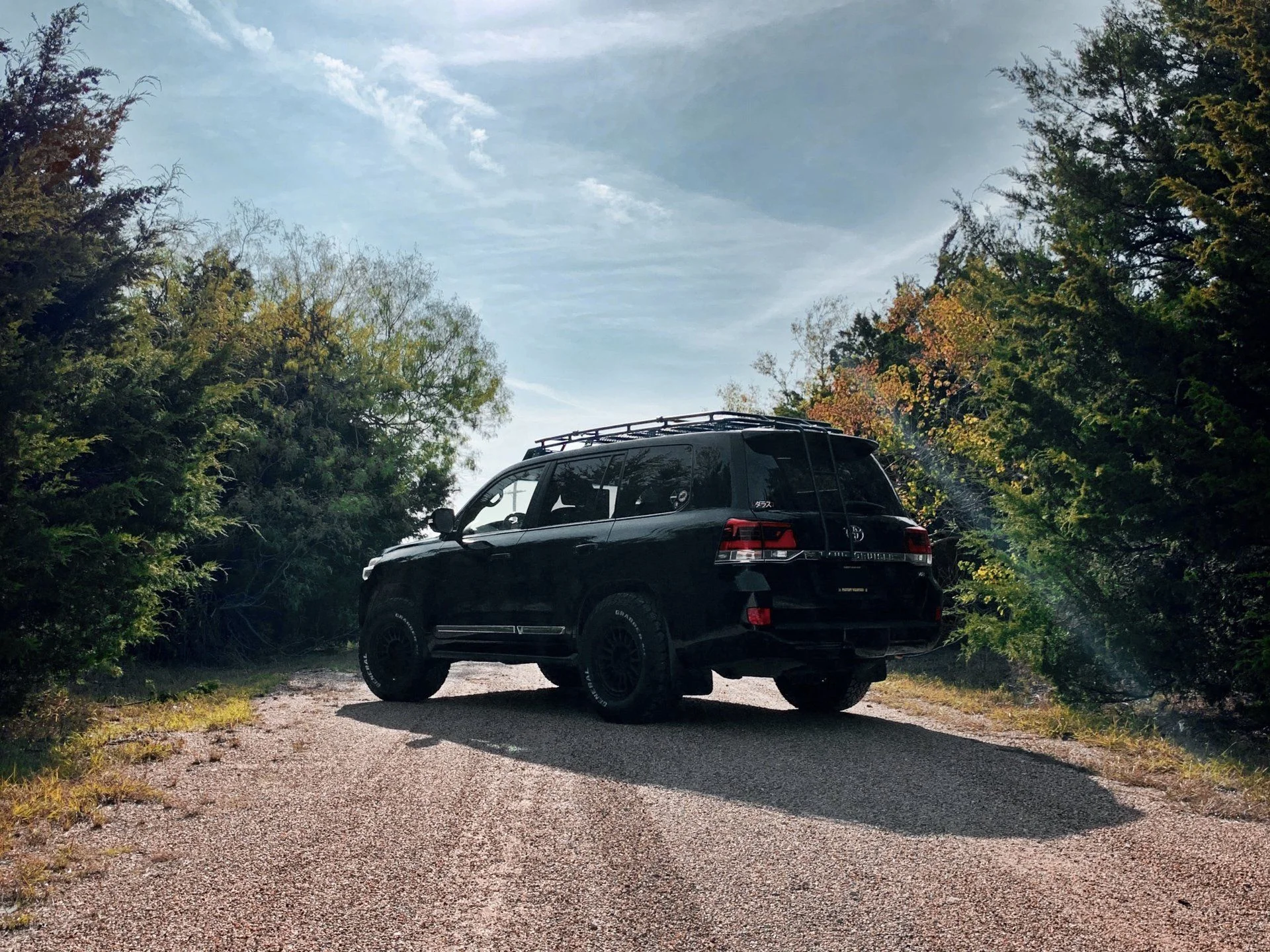

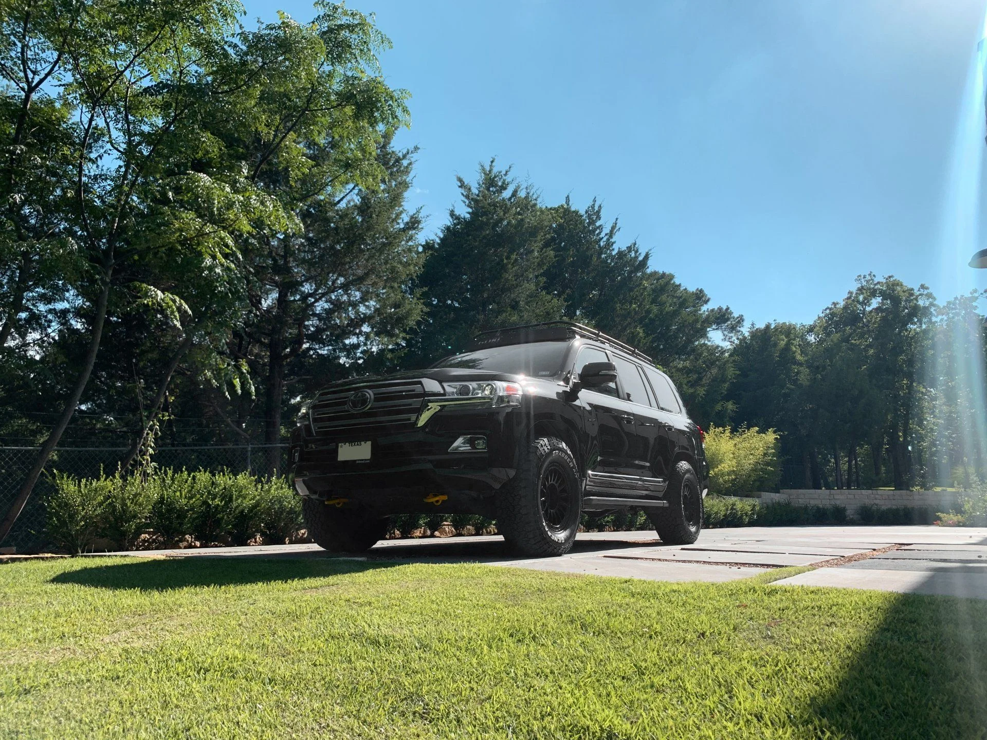

Here's some recent pics of Oso to update the thread:
Haven't added too much to the build aside from some convenience mods inside, really happy with how it is right now. Pretty darn capable and good looking for stock suspension and 33's. Really tempted to yank off the running boards. Long term, I do want to get lifted and throw on some 285/75 or 35x10.5 tires.
Next up might be lighting, such as ditch lights and a cargo area light, as well as some ceramic tint all around.

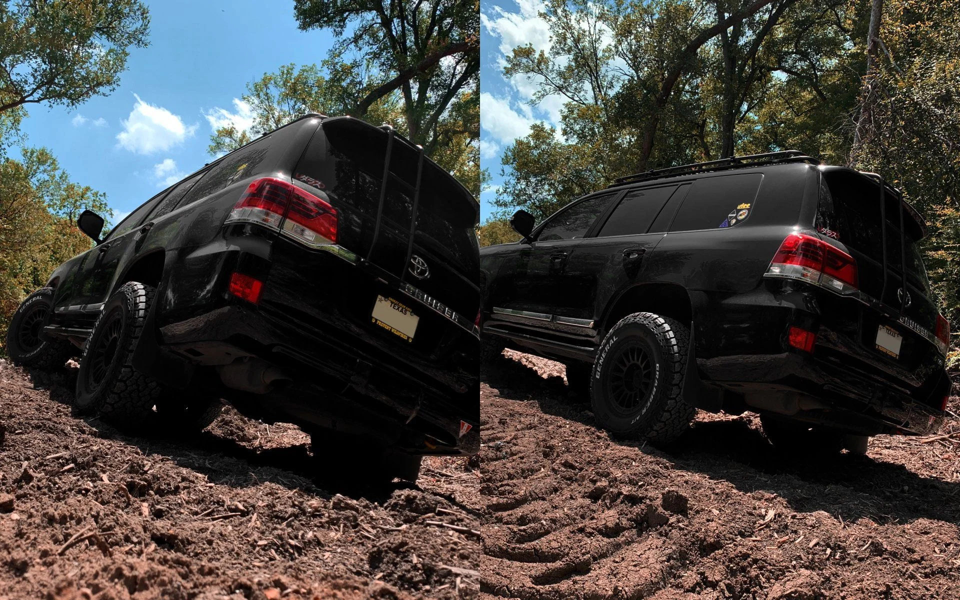

Thanks for those pics. So just to confirm on the road it doesnt scrub, but if offroad it may rub a bit?
Yeah, after I took all the measures listed earlier in this thread to get the fender liner, mud flap, and rocker panel out of the way, rubbing is fairly minimal now. Off road when articulating I've experienced some rub here and there, and if I turn quickly and sharply into a parking lot or driveway with an incline/decline it'll rub for a split second. Daily driving I don't rub, just in those rare sharp turn occurrences maybe 1-2 times a month. Overall not too bad. I bet a lift, UCA's, and a good alignment would help even more.

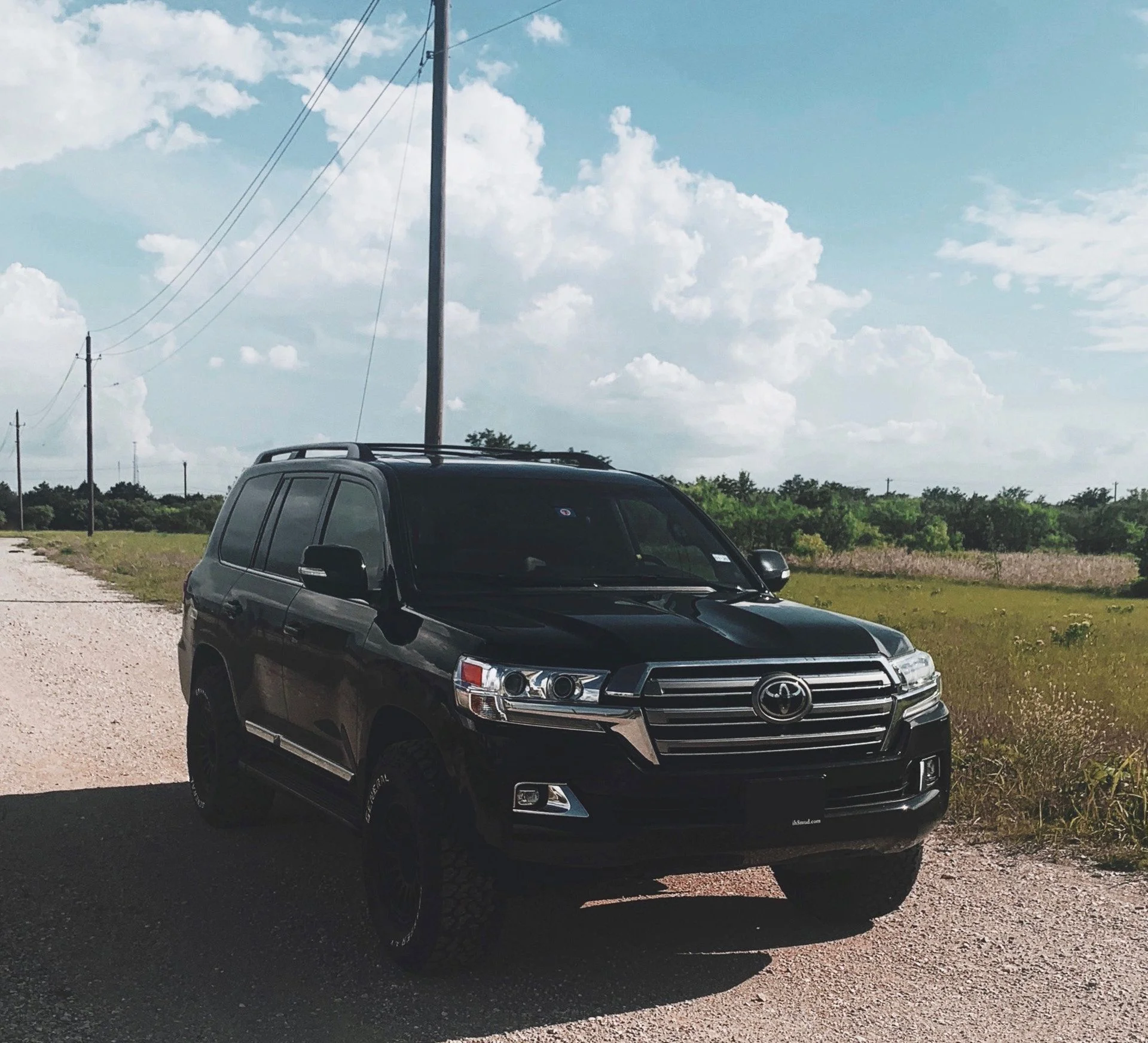

Black is a pain to keep clean, but I would have it no other way. Brandywine Mica or Amazon Green are neat colors if you wanted to be different, and I'd probably get Silver or Gray if it was an LX. I was dead set on a Black with Terra interior during my search. I maintain it with Turtle Wax Hybrid Ceramic products to have deep gloss and keep it looking cleaner longer, and to make it easier to wash.
It cleans up nice:
