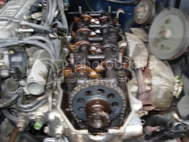

Well, the kit I had was wrong, the upper sprocket was completely different but they had one with the right sprocket. Now I get the lower sprocket and chain on but I can't pull the sprocket up high enough to get it over the end of the cam over that pin that holds it in place. It's like the chain is a link too short, the old one fell off. The new kit I got is for 85-95 so it almost seems like I've got something funky going on here. Im stuck now.
No, no guides on, no tensioner. Just the crank sprocket, and trying to slip the chain/cam sprocket over the end of the cam. I need it to stretch about 2-3 mm. Its killing me, Im about to slap in the old one with new sprockets, guides, and tensioner and just throw the chain in my toolbox.
Well, there is just no way in hell that chain is going to fit. Im so pissed right now I cant even see straight. I counted the links on both the chains and the old one has one more link than the new one. Should I just hock this napa crap and call engnbldr on monday? This is fxxxing bull****, an 8 hour job held up by a chain that is supposed to slip over the end of the cam.

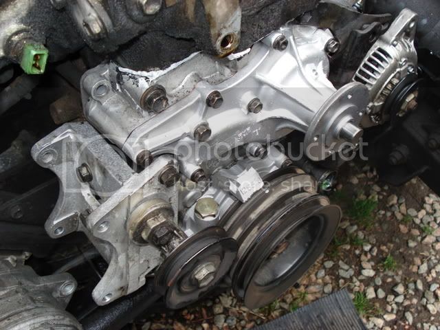

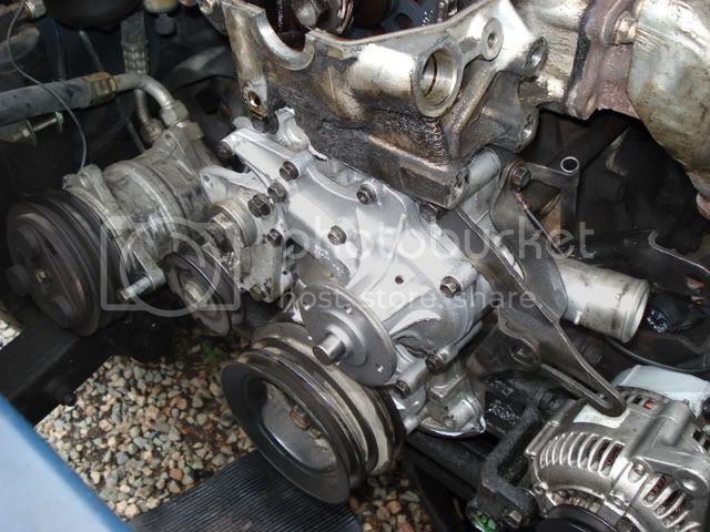

Is the nut on one of the ends of the fork? Does it have a curved slot in the "Handle" of the sling shot? If so, it's probably for the top of the alt, so you can tension the belt. Oh, and weird about the sprockets and chain..... Glad it's together though. :cheers:

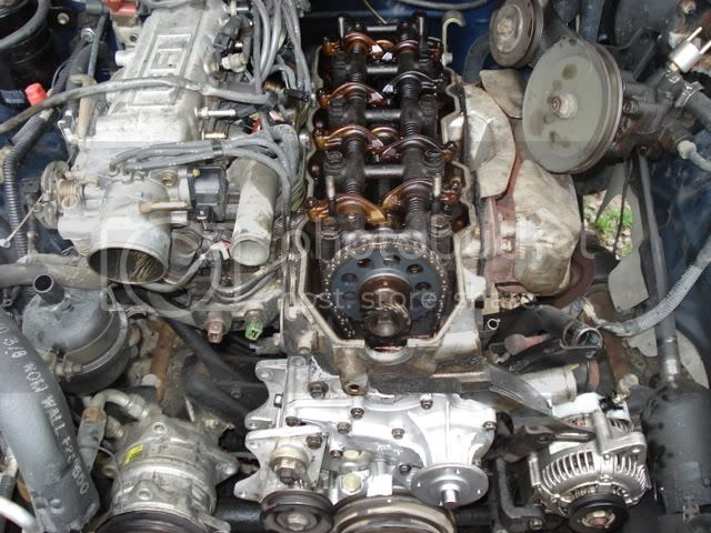

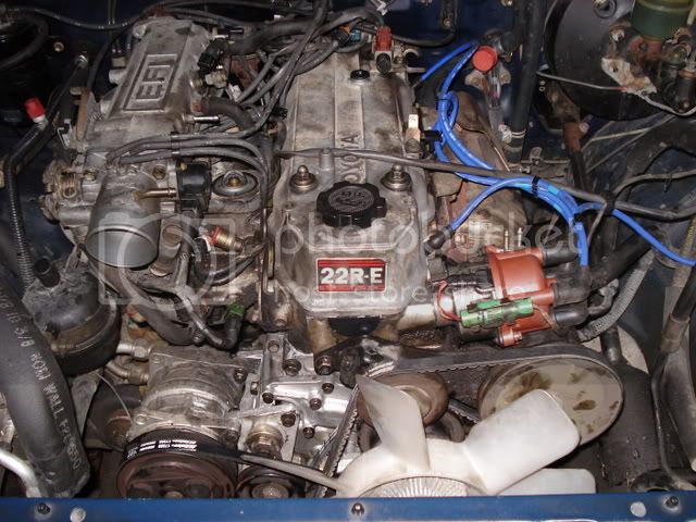

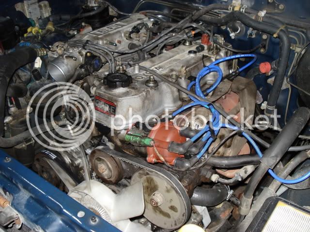

Glad you got the right stuff finally.. That sucks that they didn't work with you on that wrong chain. I can't place that bracket right now since it's been awhile but here are some pics of various stages when I did my 88 that may jog your memory:

:DOk that scared the living crap out of me :D. I checked it again this morning, the oil looked clear. I bought a whole case of oil the other day though so Im going to change it again todlay. Thanks for your guidance guys. The fork shaped bracket bolted to that empty whole in the front of the block on the driver side, one fork bolted to the tab on the bottom front of the ps bracket, and a bolt ran through another fork and the ps bracket into the back of the pump. Now it's time for my vented rotor swap :grinpimp:, gotta fix one p.o. mistake at a time. When he did the brakes last he only changed the outside pads :rolleyes:
