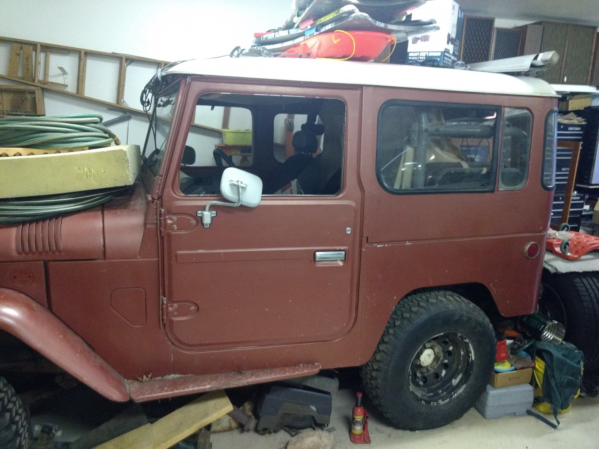

I have never seen a 9/73+ FST model in person and would only make sense no to redesign the doors after so many years. I know the part number changed 9/73 for the doors and the B pillar. But seen Toyota change a part number for no apparent reason. The site I use shows the back runners on the factory roll bar having the same part number 9/73-2/8/78. 2/78 was the date the seat belts moved from the hard top to the roll bar. Actually 8/76 (76 model) the radius changed other paint color there were no other changes to the side runner. So I would agree very possibly the doors or bows didn't change after 9/74 in the US. I have switched out the hard top for a soft top a few times on my 68. I have always switched the doors and hinges at the same same time. So never attempted using hard doors which are off a 79. My poor 68 has become a real mutt over the years.
View attachment 2440055View attachment 2440056
that’s a great looking mutt though! I don’t recall what month the build was, but my US spec 74 oem soft top had The flat bow &flat soft doors. I’ve seen one is spec 75 soft top that was the same. I’ve never seen a later model US spec soft top, so I don’t know if you could buy them In the USA after 75. I’ve owned a couple of later model global spec 40’s that had the flat soft doors &main bow. But most of them also came with hard doors & the later bent bow.
