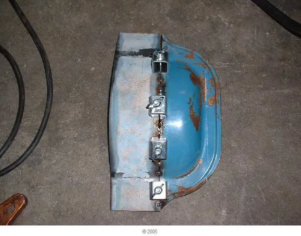

Today I put the body back down on the frame. In order to do that, I had to clearance the floor. Since this is my new floor, I made a tester cut around my e-brake disc and trimmed as little as possible. I then had to stretch my new trans cover 3". I had an old cowl in the garage, so I cut out a 3"x15" strip to use as my filler. After getting the bends pretty close I tacked it together, flapper disc the welds down and added a little primer. I still need to finish the edges and drill some mounting holes to keep it to the floor.

hey rockcod,
i always forget what these things are called...
attachment.php
how do you like em? i've been thinkin about gettin some but have just never pulled the trigger
malphrus
Malphrus,
This is the first time I have gotten to use them. They worked really well. I bought these at Harbor Freight and believe it or not, they did not break or fall apart after the first use!! They hold the metal nice and flat and makes welding much easier. I forget the name of them, "Sheet Metal Welding Clamps?"

Malphrus,
After seeing your post I bought these same clamps at Harbor Freight for $5.00.
I tacked welded around them as you have, which brings me to my possibly obvious question.
After removing the clamps do I continue to make tack welds across the gap or try and lay a bead along gap?
I'm a beginning welder and learning from scratch.
I continued with tack welds to keep the heat build up to a minimum. Do some practicing on scrap sheet metal and find what works best for you.
