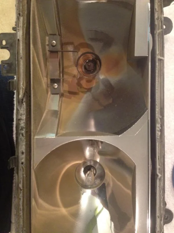

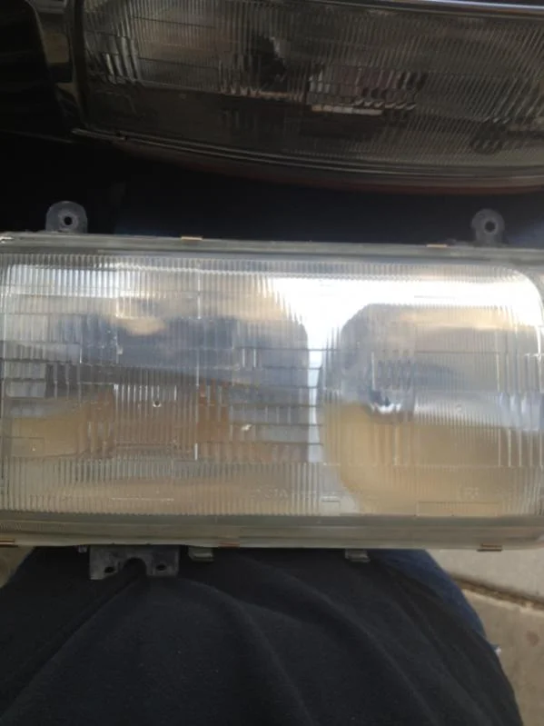

Alright so I finally was able to get back to this project and after baking the headlight at 280 for 8 minutes I was able to pry the glass off of the headlight housing! The pictures follow as such:
Passenger Side Headlight before
After opening. Note the tan areas are not really dust they are more like a hard caked on mud substance and I don't want to scrub it too hard
And this was the glass
Just doing some accidental archeology here while looking for a completely different thread. On the off chance that this ever helps someone:
That's not yellowing. That's actually the plastic of the reflector itself. The silver has come off, and that's most likely what that debris on the lens is. You'd need to have it resilvered.
Source: I've ruined reflectors in the past and got to learn what they're made of. :p
This concludes today's vintage thread contribution.
Anyone know if you can buy new reflectors? If no, how do you get them re-chromed?
Haven't done it myself yet, but some people have taken the headlamps apart, gently cleaned the reflectors, then sprayed them with a bright silver or Chrome paint, then put the headlamp back together. I don't know however what the original coating was on the headlamp reflectors, paint versus a vacuum deposited metal coating, or ??
