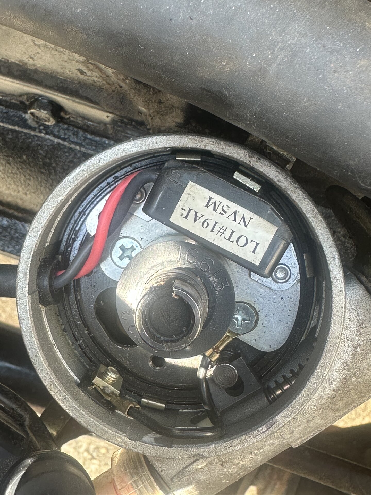

Id check inside the dizzy to see if the shaft is worn (floppy in the bearing) or the pickup has moved (the distance to the trigger can be fussy). Check its all tight and good clearances.
...And take photos to help the next guy fix it quicker ;)
Can you post a picture of the inside distributer ?

Hello to all that may have this issue now or later down the road. I’ve been away from the Land Cruiser for a few months now, life just gets in the way sometimes, but I diagnosed it as a bad igniter, so I ordered one from pertronix and got her back on the road, along with a new slave cylinder for the clutch, thanks for the help
