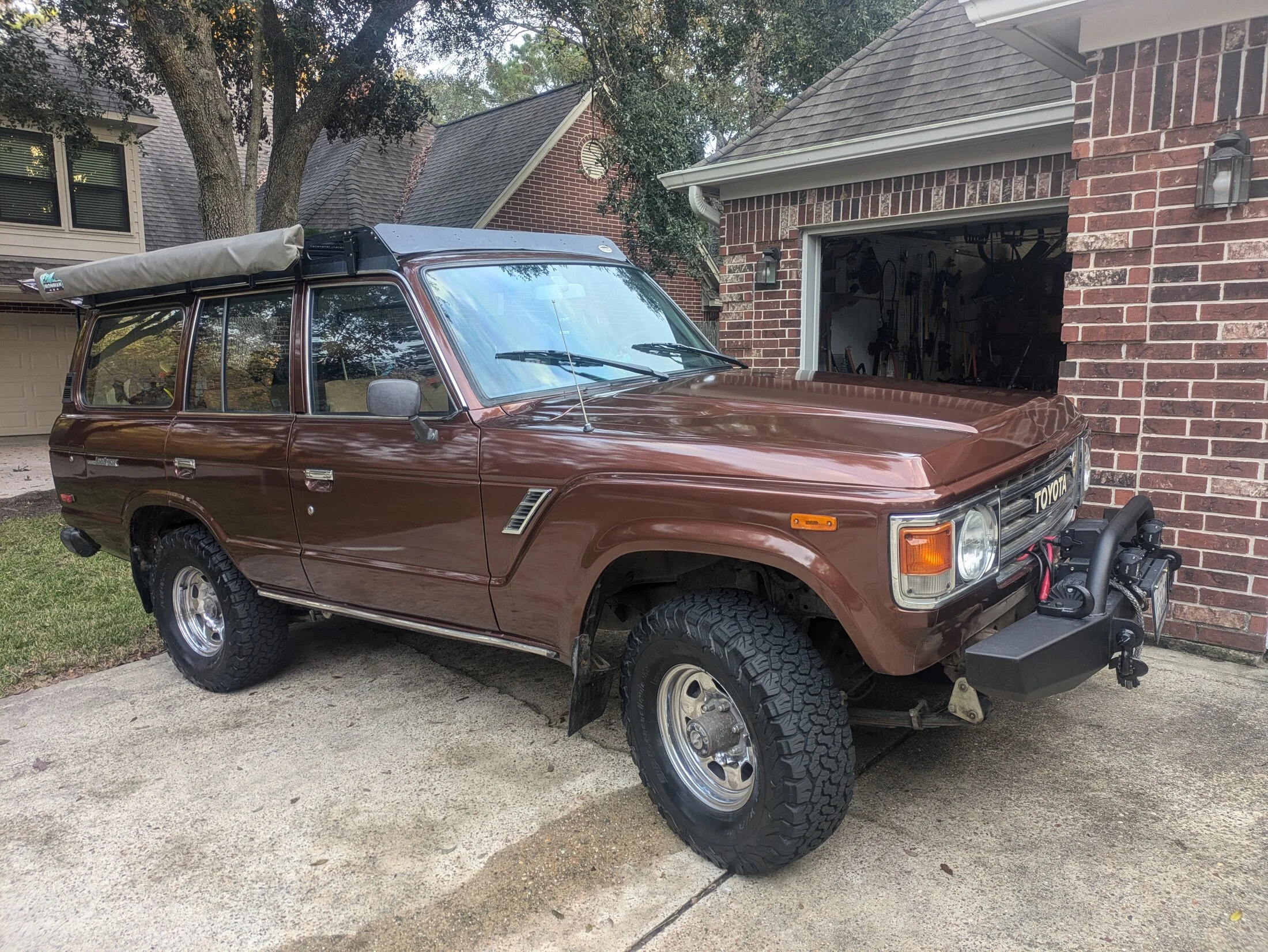

Just cleaned her up and realized the lighted Christmas wreath will no longer fit with my bumper I added this past year.

Your truck is prettier than mine ;-)

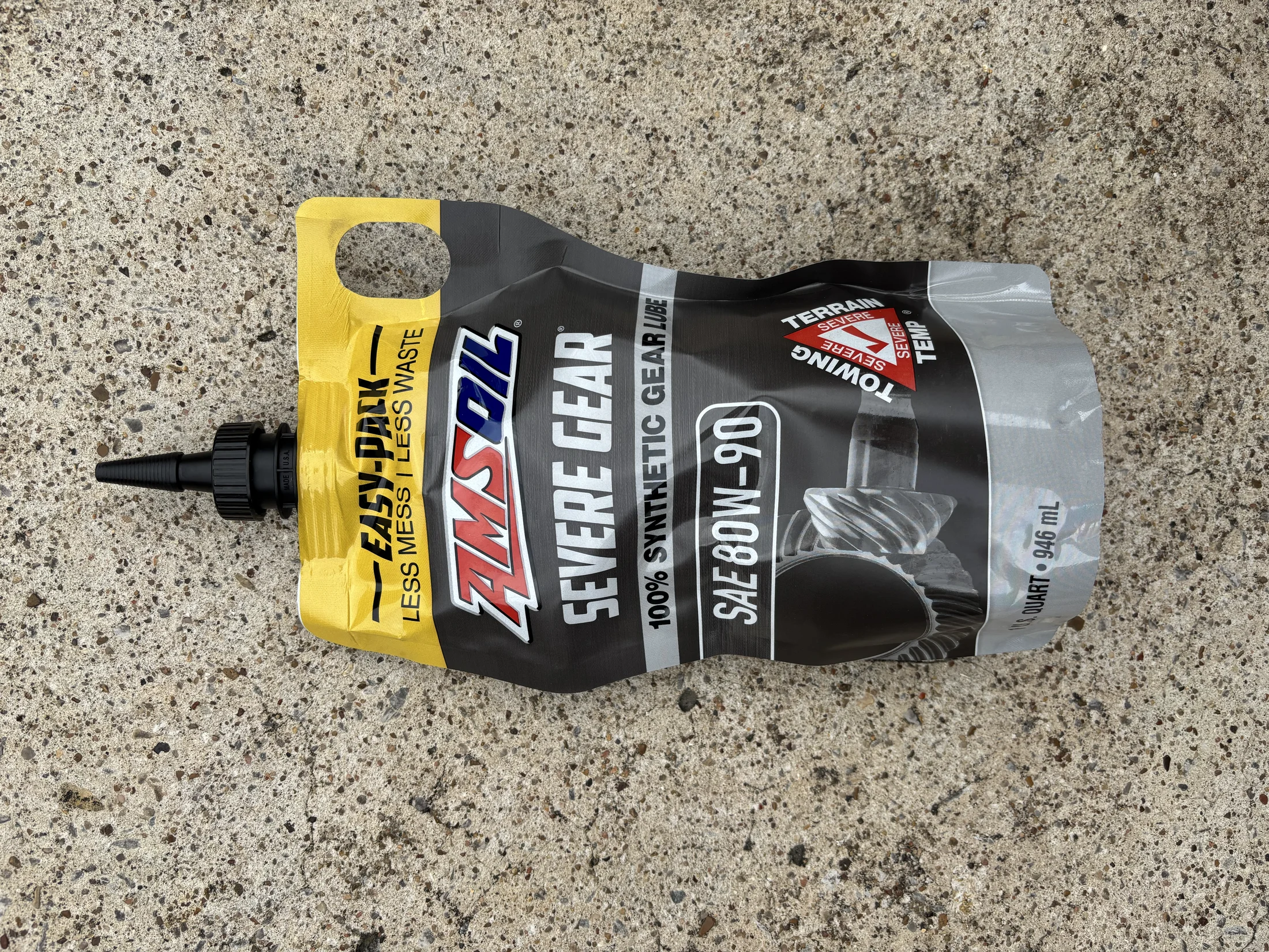

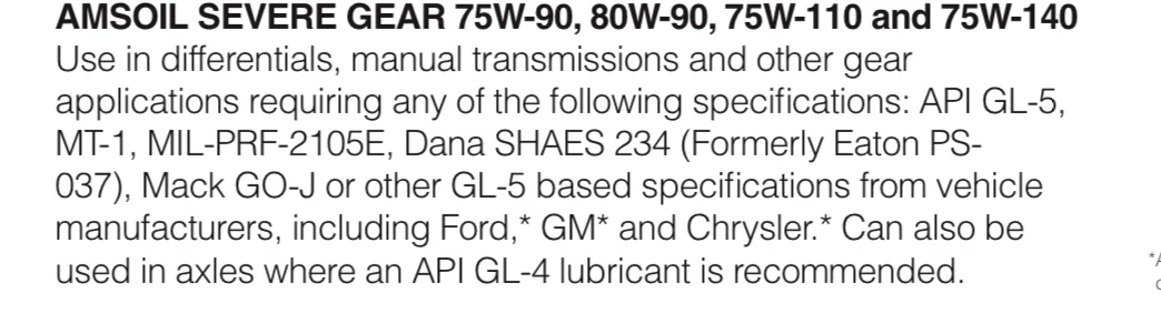

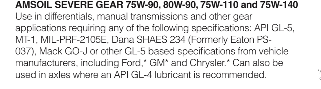

I looked into Amsoil, but it is not spec’d for transmissions that need GL-4. Which could lead to synchro wear/damage. As I recall, the Toyota manuals are spec’d for GL-4.
That is correct - I run the Amsoil stuff in the TC but am running Redline MT90 in my new H55F.
Agree with the above, I've only had my truck driveable for a few weeks with the H55F but reverse is clunky. I put it in 4th gear, then 5th gear and then it glides right into reverse.
Toy_tek,
Thank you for the catch! The Amsoil website even lists the GL4 fluid. My vendor was embarrassed, is providing a full refund and has ordered the correct fluid. I just hope I haven’t incurred damage for using the wrong fluid for the past month! Grrr…
