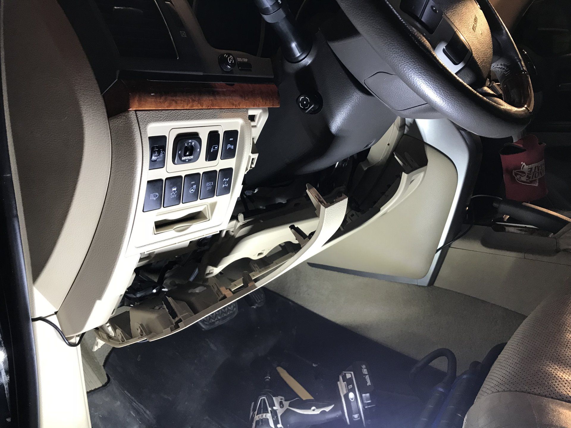

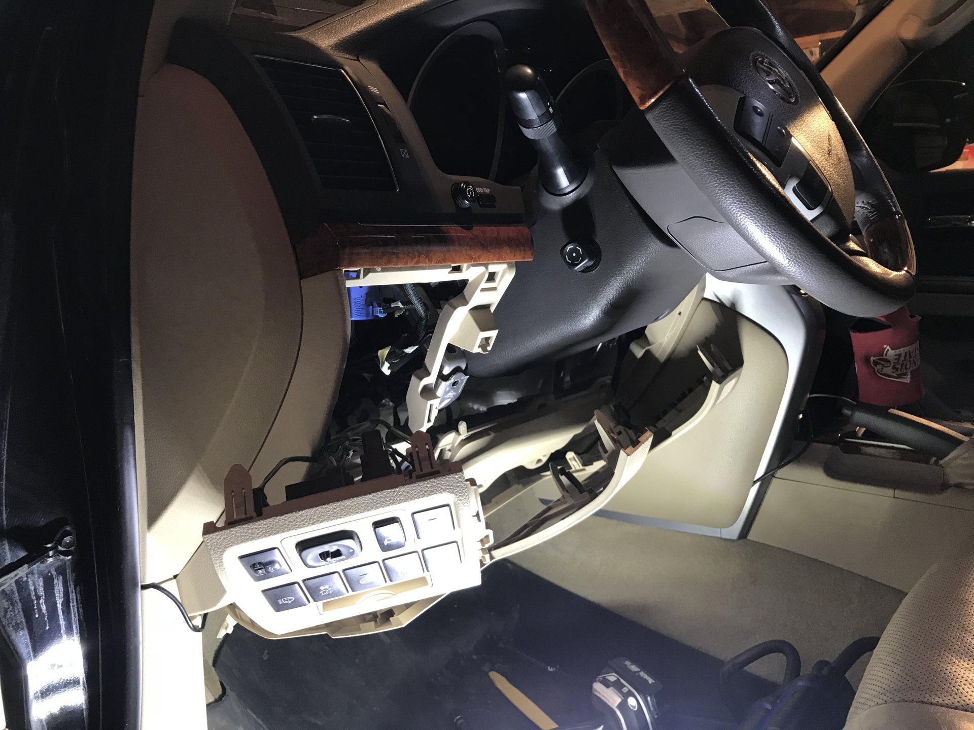

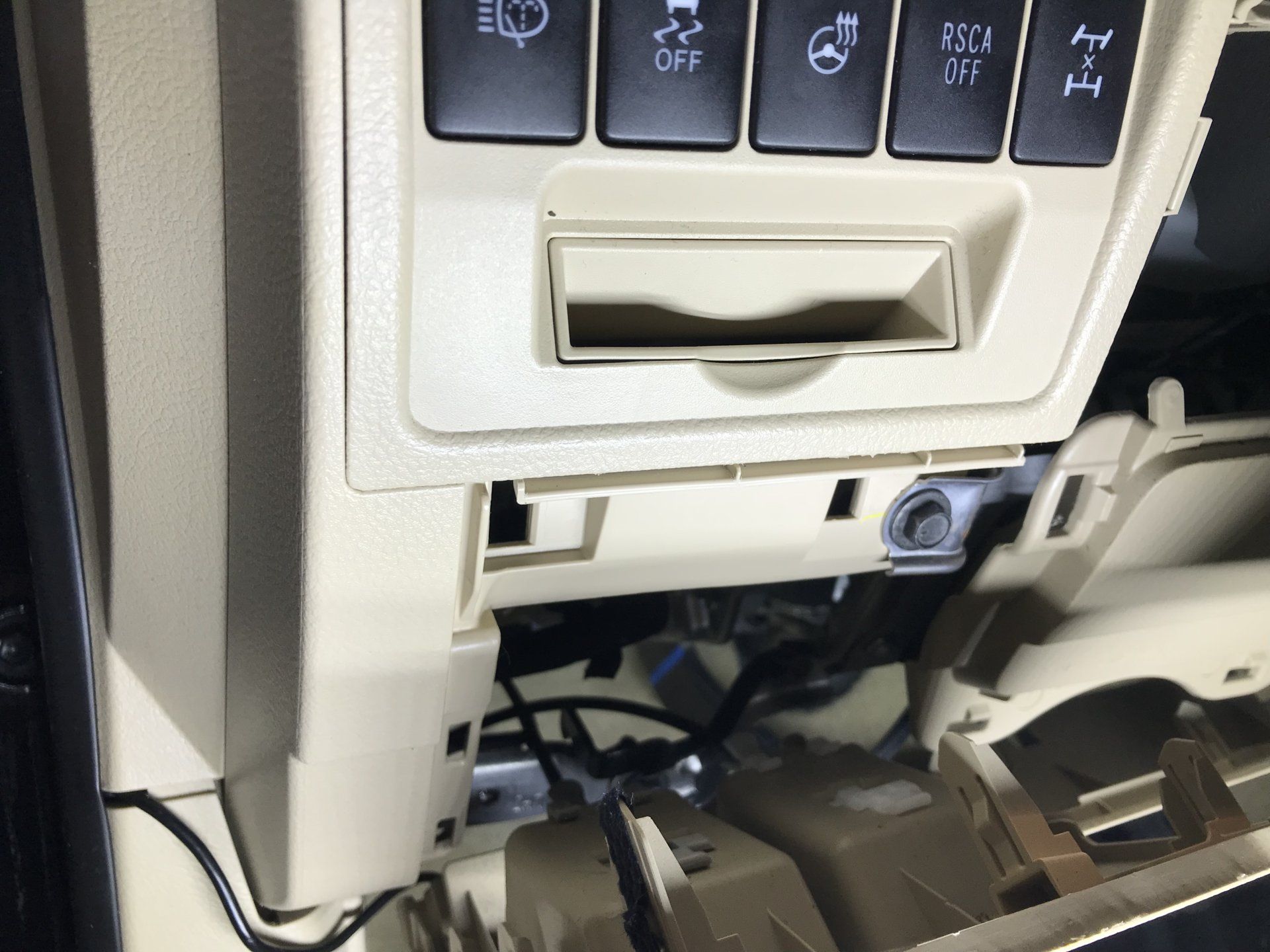

Got in there and got the signal relay swapped out. I pulled the old relay out and taped the new DD one onto the metal mount pictured above. Photo proof that it went in a ‘13 LC200, not sure they’ll help with the install but I snapped them so I guess I’ll post them. You don’t have to pull the old relay and tape the new one down but I didn’t want it flopping around behind the dash. I’ve already got a mystery rattle from my drivers side 3rd row jump seat that’s making me nuts.
