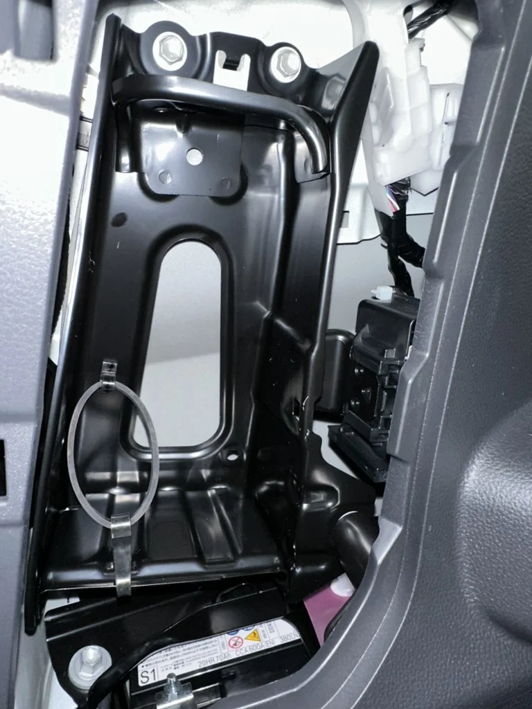

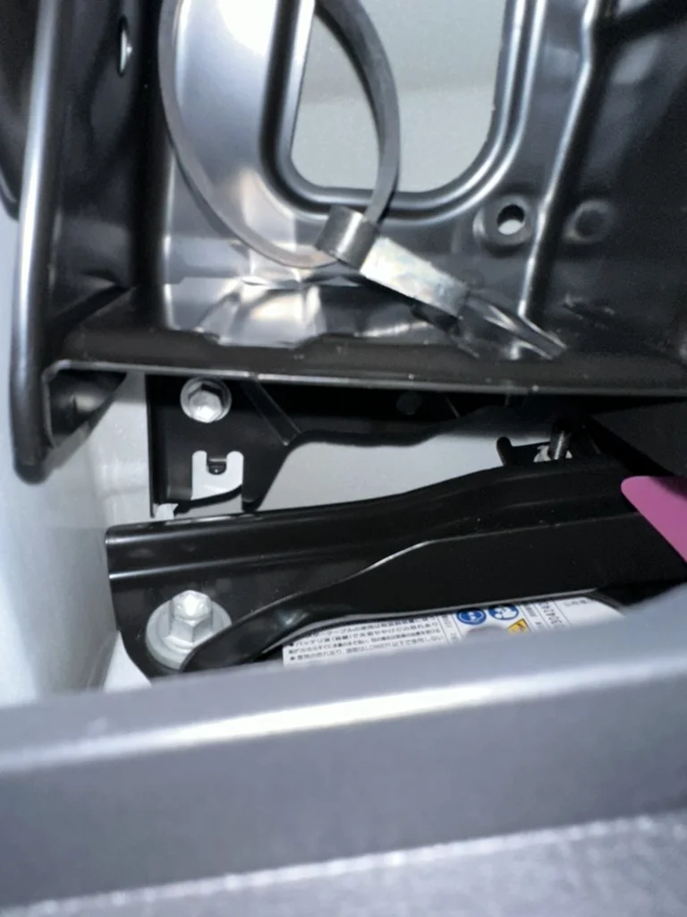

The factory jack location looks interesting.
Would require removal of the mount for the jack and fabrication of some sort of bracket to mount the air compressor using the same bolt holes that the jack mount uses. Compressor would have to be inset further than the jack so that the cover can be put back over it. Wiring would be easy with the battery right there.
Issues I can see are ventilation. Not sure if the compressor would get too hot for this to be a good spot to mount it.

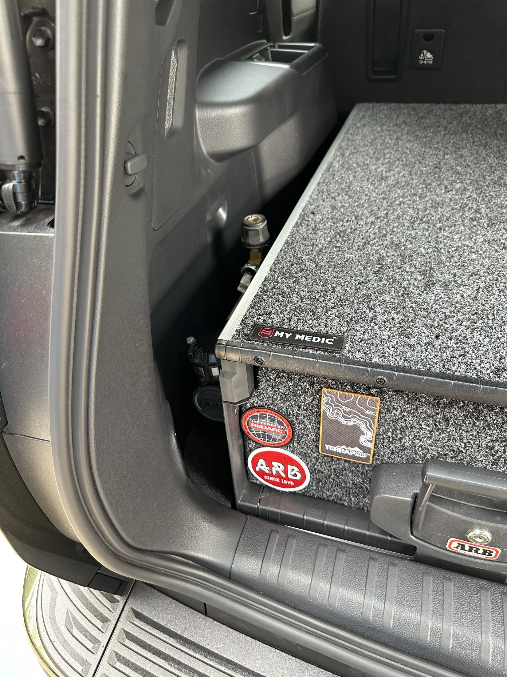

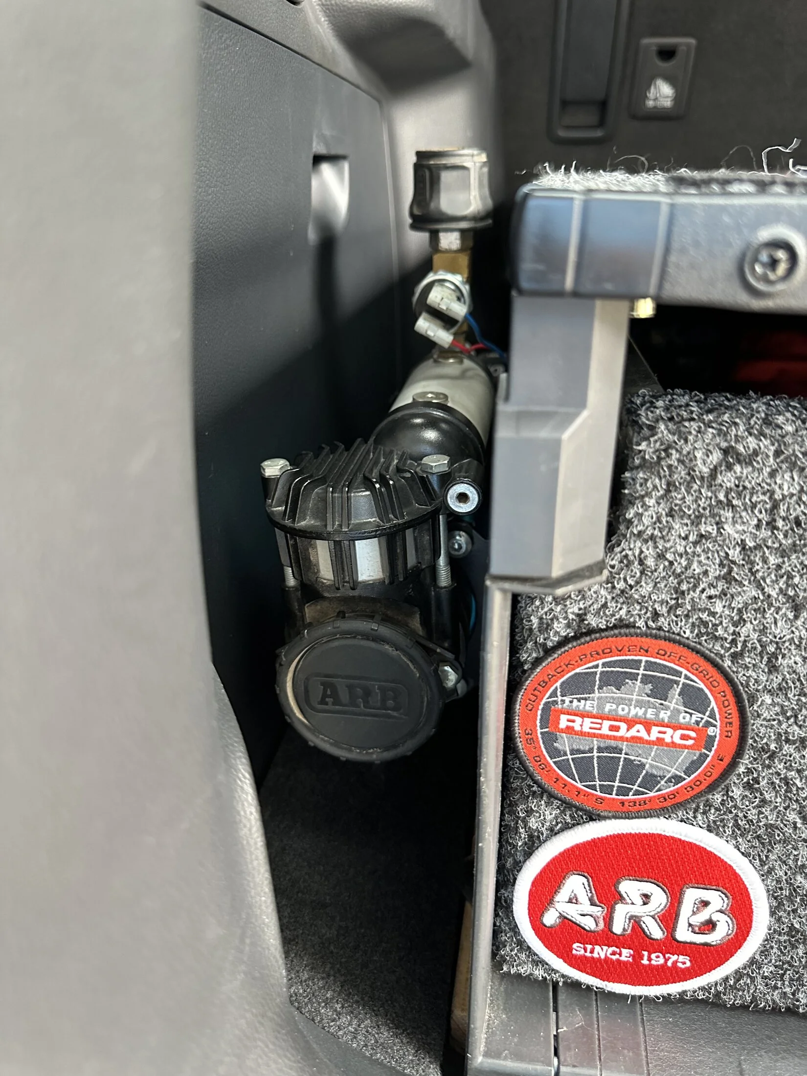

I ended up mounting my spare single on the side of my drawer set:
I've got a set of drawers I used in my LR4 that I'm debating whether I'll use in the 250. They'll inherently make the existing storage compartments in the floor of the 250 unusable. Not too big a deal, but a factor. Anyway, if I do use them, this method would be in consideration.
