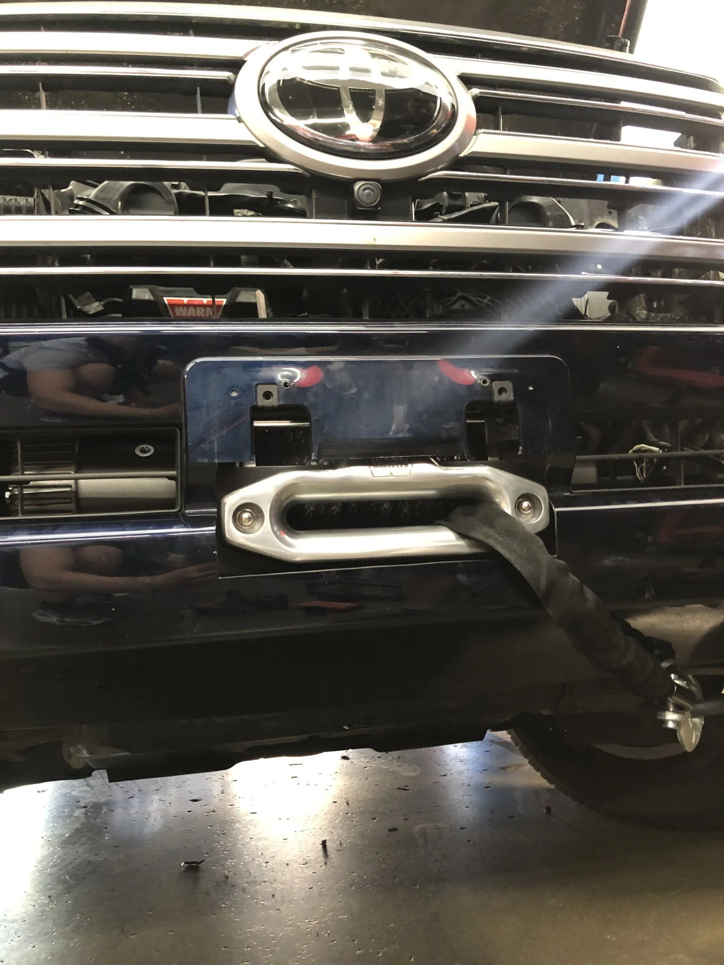

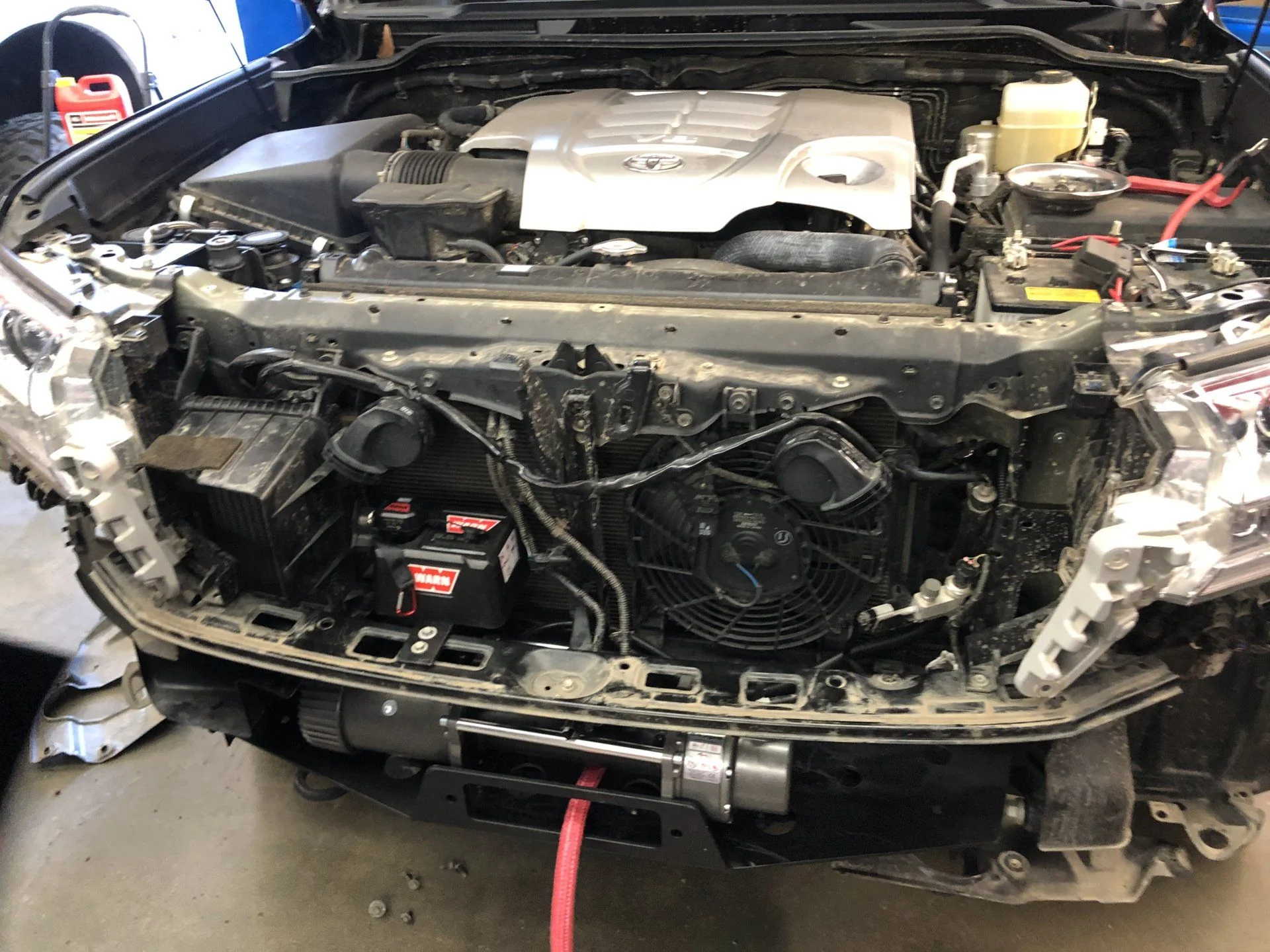

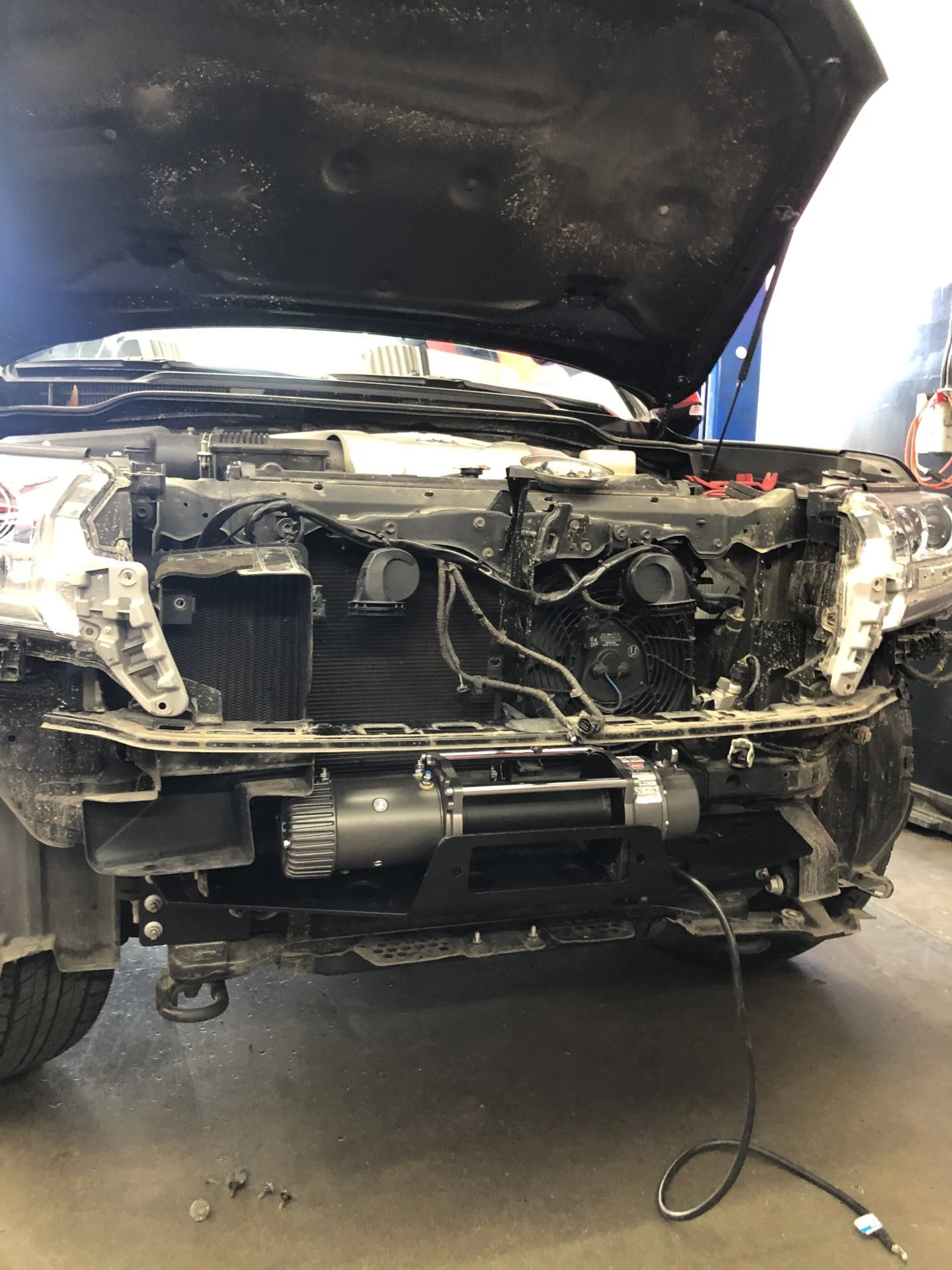

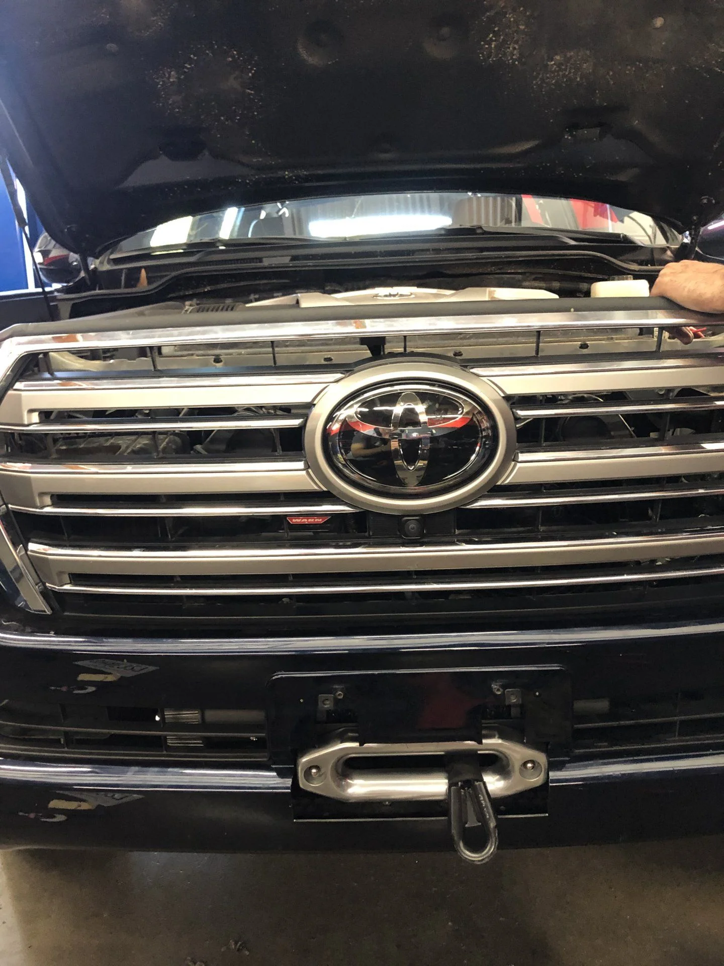

Hey friends:
I just want to share some pictures of my newly installed hidden winch mount along with a Warn XP-S 9.5. Alpha Off-road at Santa Clarita,CA helped me with the installation. Art and his buddy helped me, super friendly staff and quality work. Thumb up.
Tell me what you think about this set up.
More mods to come, if you haven’t, please follow me on Instagram @OMW2PNW.
How do you reach the disconnect??? Looks tight for the hands to fit through

I brought this mount back from my last visit to home, China. I bought this for 800 yuan, equivalent to $114 USD from the shop that does mods for my LC200 in China. I believe Trail Tailor makes this as well. They look identical, whereas mine doesn’t has a Trail Tailor logo on it. Here is a link.

So does it basically replace the bumper? (not the bumper cover, but the actual bumper)
