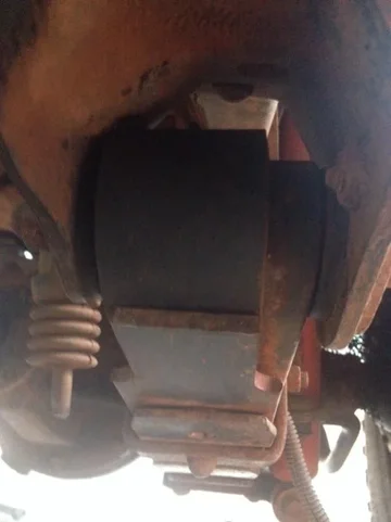

Pulled the box and tranny out the other day and noticed when under there the wrap or second leafs on the rear front spring mounts is sitting a fair way off centre of the bush spring,so much its rubbing the inside edge of the spring mount on the frame.
Would i buy them again,no thanks i"ll go something a bit better quality.
image-25348165.webp Heres a pic of where there rubbing.
Both sides the same on the front springs.

View attachment 856894 Heres a pic of where there rubbing.
What springs are these? (part number?) I don't see any clip liners on the spring clamps, those plastic clip liners are 100% responsible (along with your u-bolts) to keep the springs from 'fanning' which is what has happened to your setup. Now, some non-US application springs don't get the clip liners and I'm honestly not sure why that is without a bit of research.
No idea what the part no is,all i know is they are the newer emu dakers. Bought em new and fitted them myself. So they wernt complete?????? They are the heavy Hj60-61. All i remember. Is a piece of plastic gonna stop this???? Got my doubts. Have you got pics of the plastic bits???
Oh ok reading that again yes they had the plastic bits on the clamps,they were twisting early on with them on their too. Seriously you cant expect plastic to stop that.
... Oh ok reading that again yes they had the plastic bits on the clamps,they were twisting early on with them on their too. Seriously you cant expect plastic to stop that.
Yes I can, and they do. Plastic reacts extremely well under the slight compression force they get from the fanning spring all while offering an excellent slip surface throughout the spring movement. Either OME builds the clamps tight against the springs (like an original Toyota spring) which turns into excess noise and or limited flex OR they allow for the gap and use the clip liners to keep the pack from fanning. Fanning isn't a manufacturing defect, it relates to the clamps and the u-bolts. Replace the clip liners once a season (or less if they are holding up) and your good to go. They are inexpensive and take less than 15 minute to do the entire truck. I happen to know the ARB stockists in Aus keep them around, I've seen them on the shelf ;)
