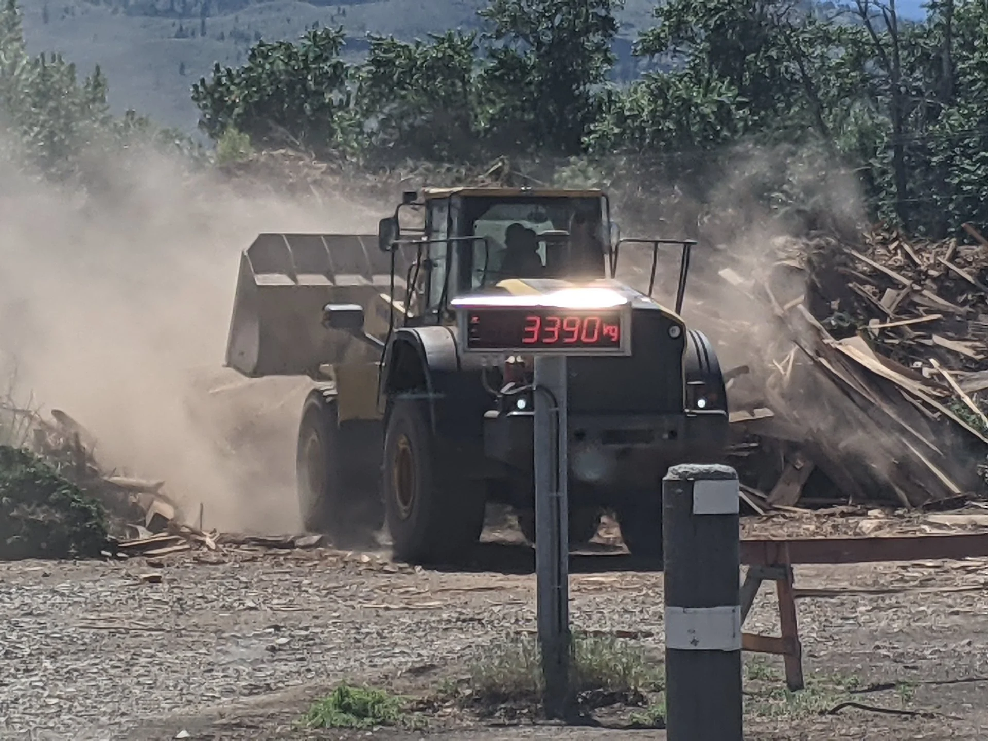

While the J's will probably do fine up front, I'm concerned about the rear specifically as I think that's where most of the weight is concentrated. 3400 KG is a LOT of weight.
I'm definitely leaning towards the 2868s in the rear, with a 24mm spacer to match the 3" J's in the front. With L shocks all the way around...

Agree as well to go with the Slee 4” Heavy Progressive rear. At 7500# like your pic shows, it should put you near or just above 3” of lift (23” hub to flare).
