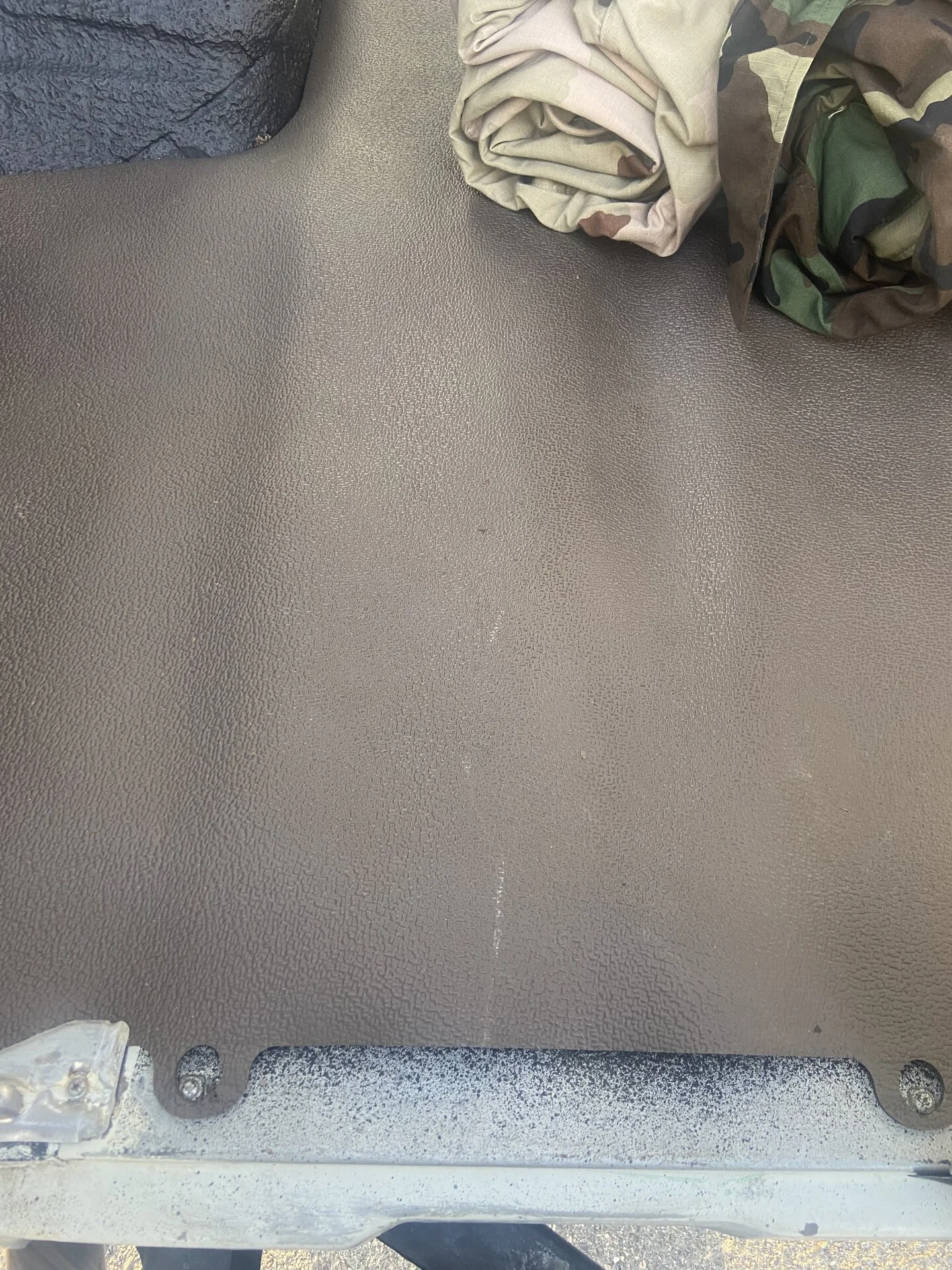

Middle mat which I need is 58540C.
58540-90K41-16

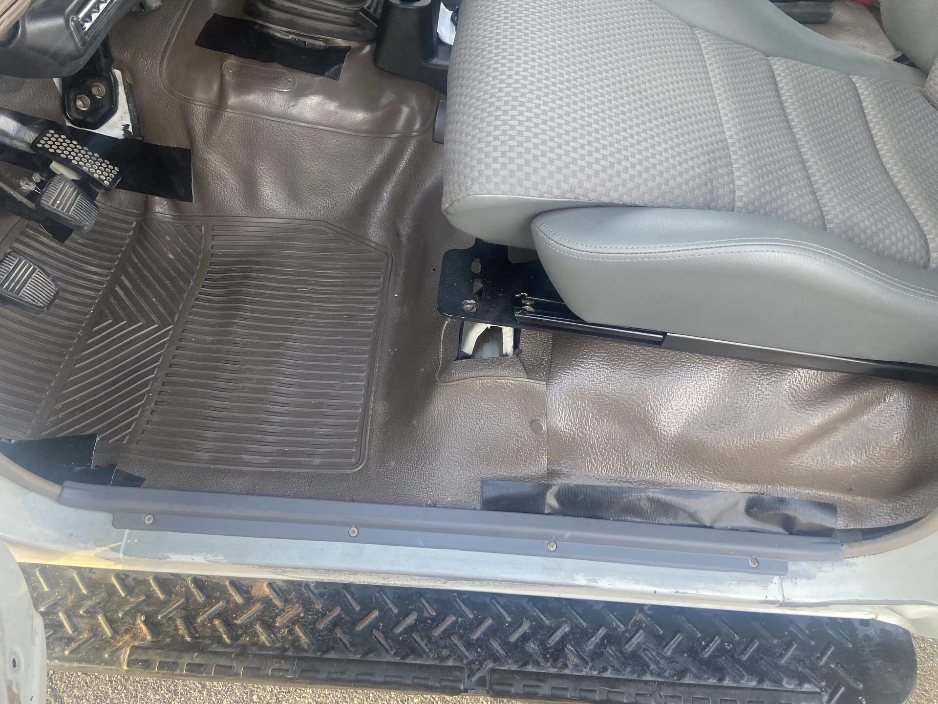

Think this is the dark gray that I've got in my troopy. $445 from Japan, curious if I can get it here in the states.
This is what i call dark Grey, I think its listed as blueish Grey.

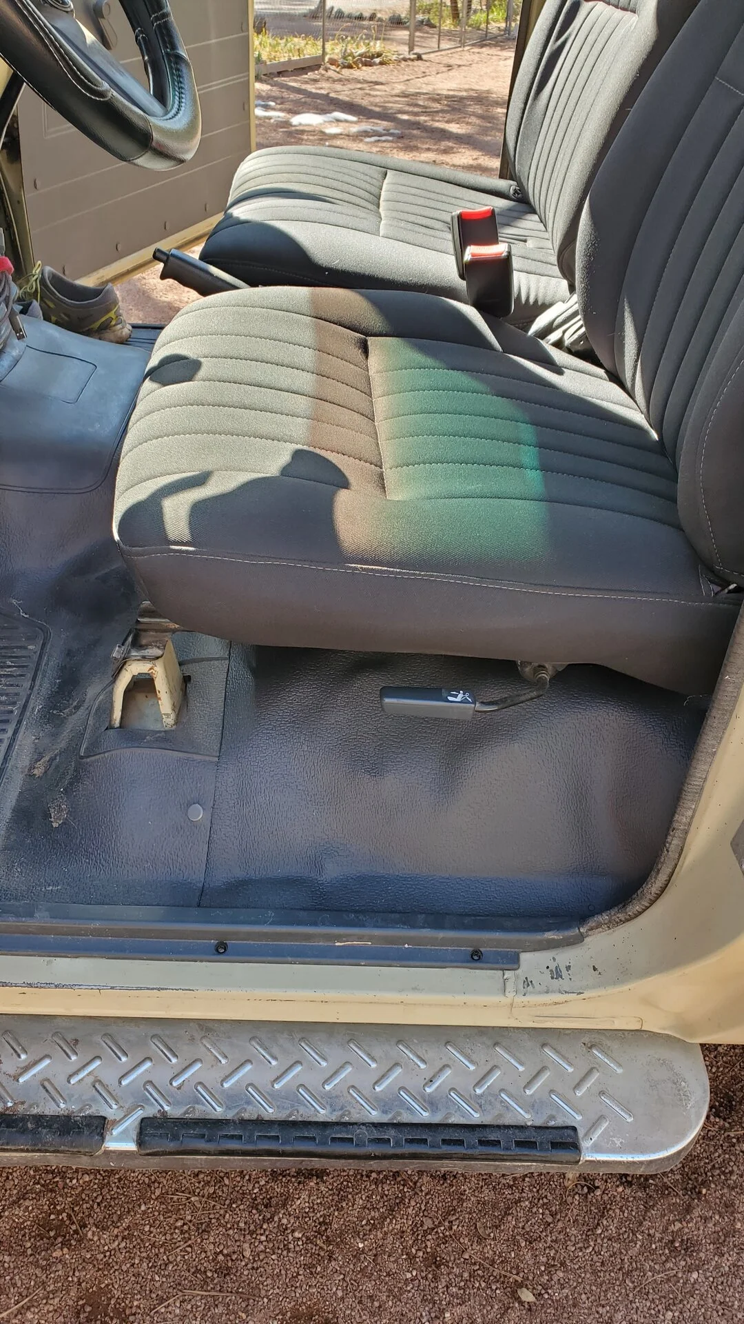

This is my rear mat and front mat. What color is this? Sable I hope since it's the only middle mat color available!
Your mats are Sable... but I thought Oak was the only mid mat available. Where'd you find a Sable one?
Your rear mat looks Oak, does it match your front?
Look at the 58540C section and you'll see two sable options.
I'm partially color blind so they look close enough for me!

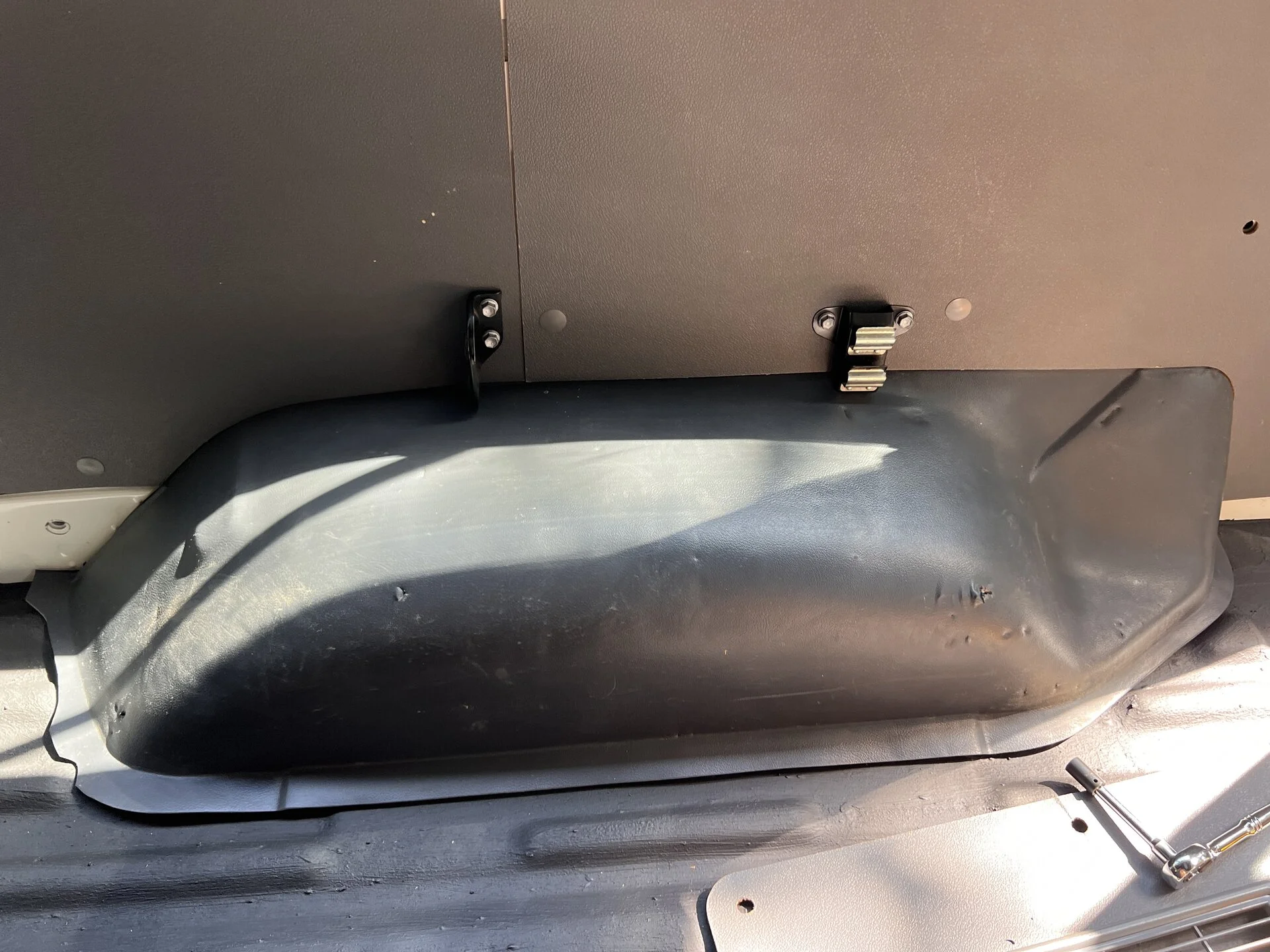

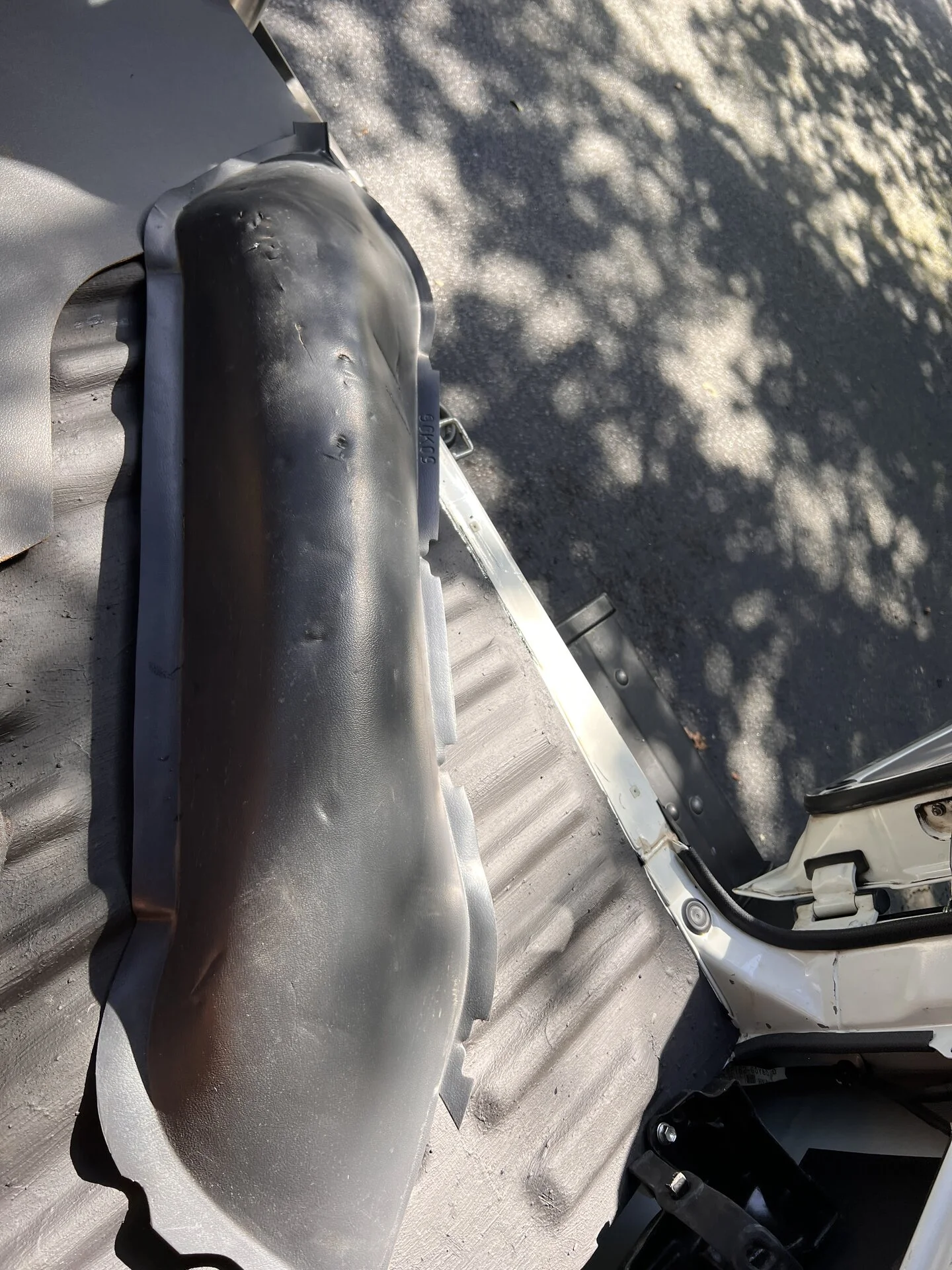

Do you have the wheel arch covers? Curious to see what they look like.

Tomorrow, I can send a photo of the wheel arch covers.
I uploaded 3 photos. It’s made of a thin foam material. If you are thinking of buying OEM ones, I really don’t think it would be worth it. They are very flimsy.

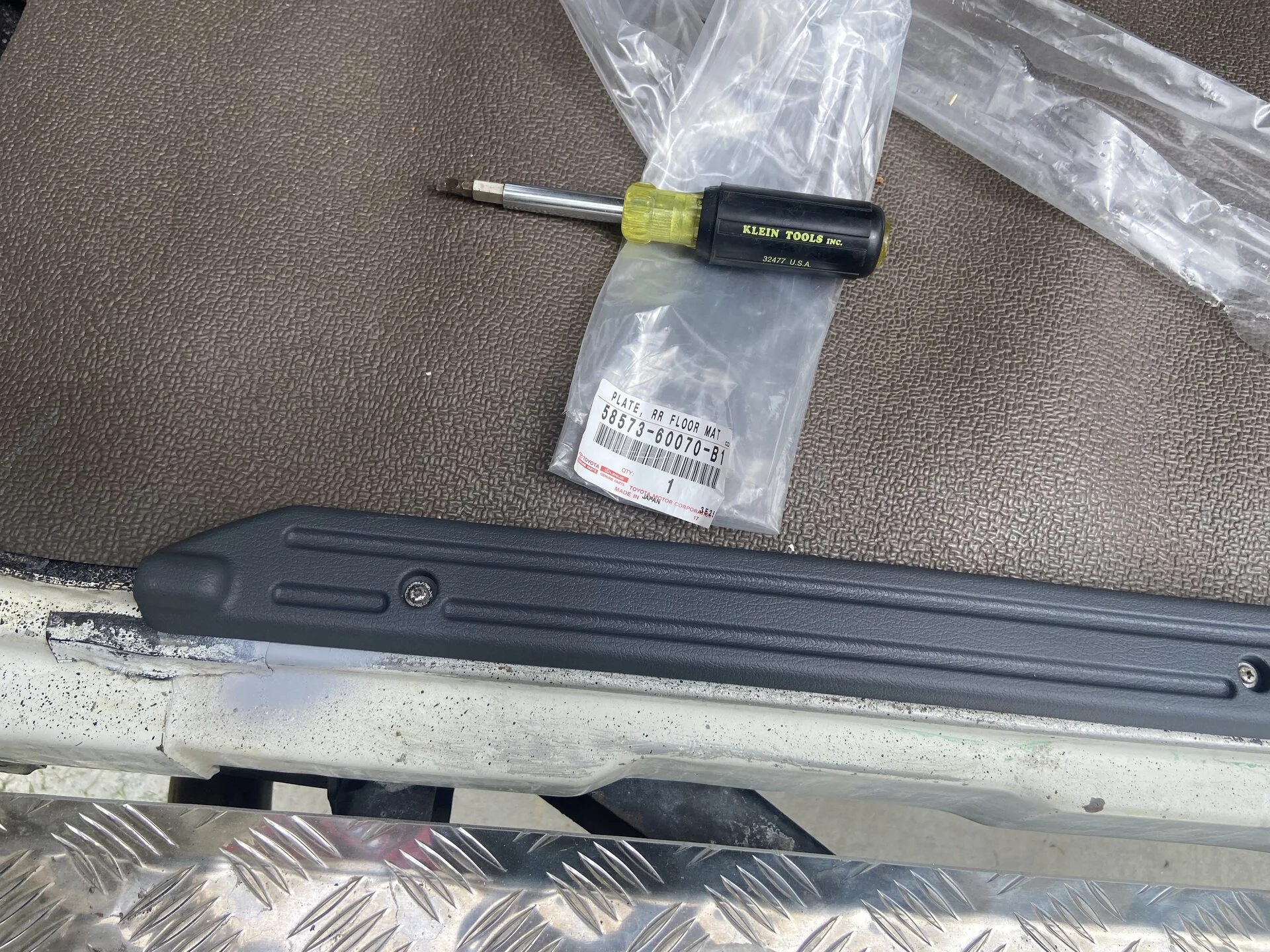

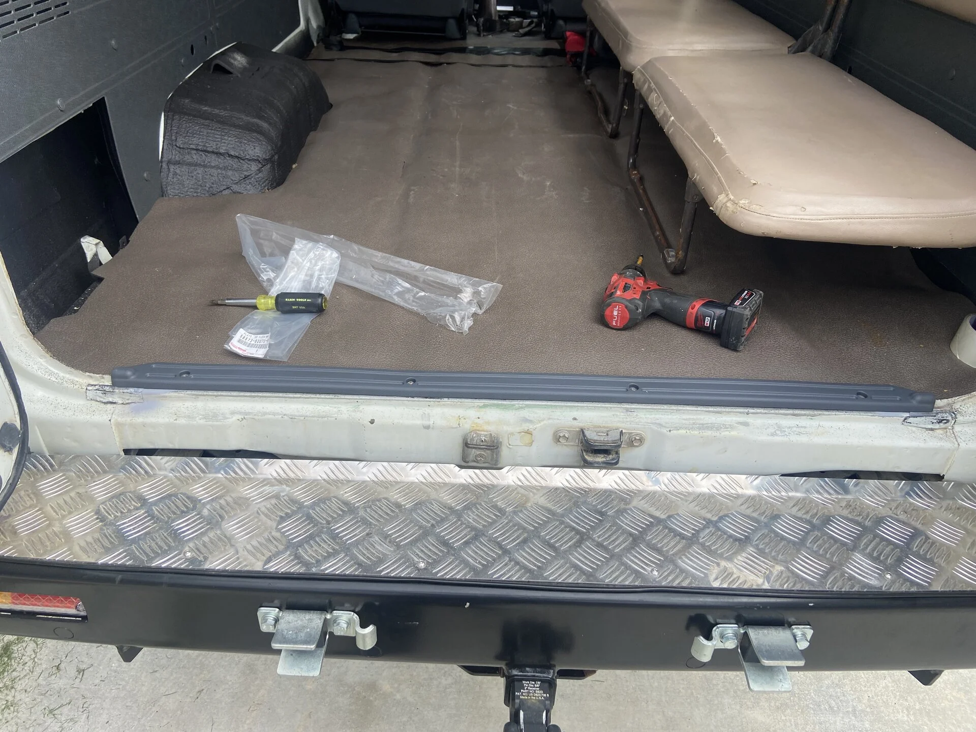

Added the threshold for my rear mat.
is plastic now the only option? or what you wanted?
Hello,
Before 1999, the threshold was a three-piece metallic part. It rusted badly. Chances are it was discontinued long ago.
After 1999, it changed to a single plastic piece.
The plastic threshold is easier to install and remove, and it fits well in older models. It does not rust.
