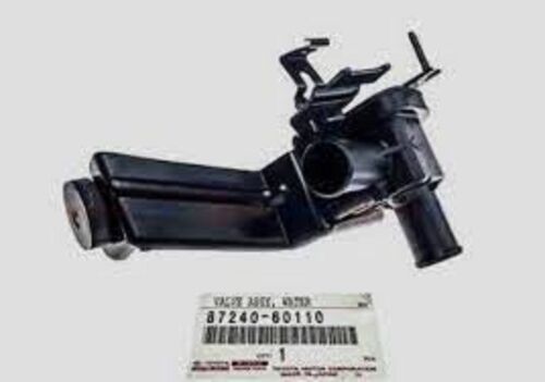

The heater hoses are a no go, because the valve has been replaced with another part number and doesn't have the 90* bend.
However, the replaced part number valve DOES fit. it bolts to the firewall with the cotrect bracket and has the cable hold in the right place
This is the valve assembly I ordered.
thats the updated replacement, the original in our rigs had a 90* bend so you only needed a 90* hose, now you need to get a 180* hose, easy peasy hose readily available, like this
Great, thank you. Going to be a learning experience.
you'll need a 90* hose also and put the two together for the distribution pipe off the engine, but thats the only hose you need to mod.
