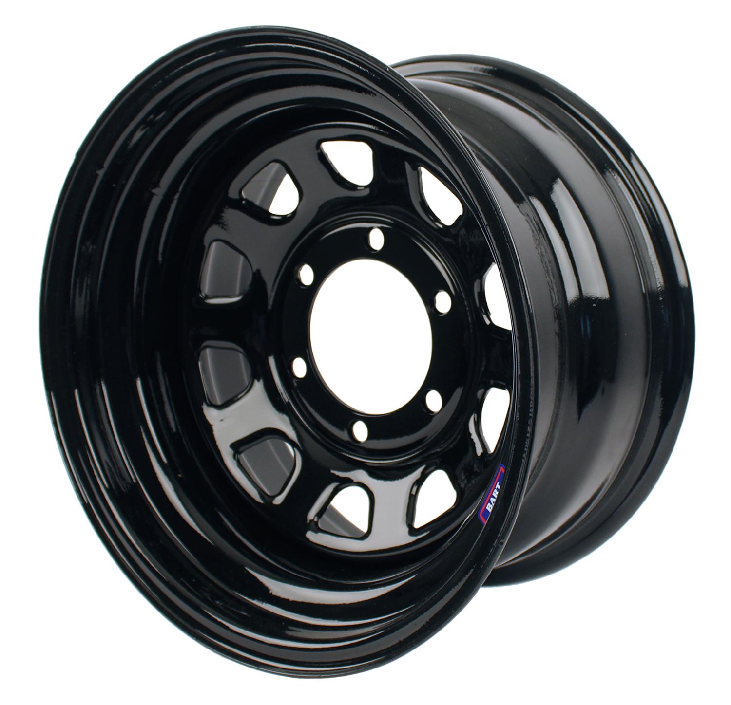

Well, steering done. Everything is in and torqued. Still need to center the steering wheel and get it aligned. Wheels do rub a little on the tierod links, even with the spacers. So new wheels will be a necessity now, not a luxury, need proper spacing.
