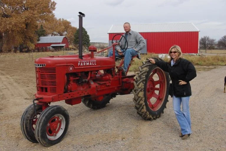

Funny. When I had my photo-op on the tractor I asked where this Farmer Jon's straw hat was.

We had a nice walk around the tractor. It does have a generator, but the belt is not hooked up. We also learned a bunch about maintenence and stuff. I've ordered a PTO cover to keep those pant legs safe. Also the PTO doesn't shut off and the guy thought the spring was either broken or stuck. We need to remove several bolts to install the cover, so the rest will come out and the cover will come off for a look inside.

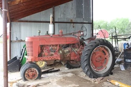

As far as I know the 1939 Farmall M and the John Deere B are still there. I don't have a picture of the JD. The M is rougher than it looks in the picture, but did run. Tires are shot.
