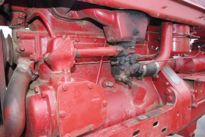

I went out this morning for a few more pics. 1939 was the first year for the Farmall H. The starting serial number was 501.
The bug jar is a Mason jar. Updraft carburator.

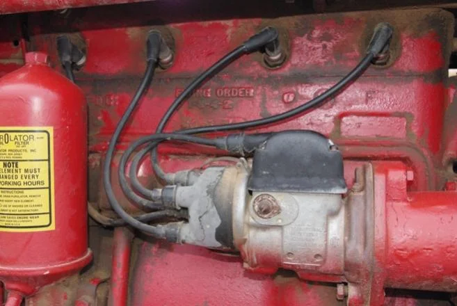

More pics.
Magneto instead of dizzy + coil + battery. Kewl.
-Mike-
Yep, specifically an H4 magneto.
It does have an electric starter, but no battery, alternator, or generator. I'm going to try and get the electric starter going for general use, but we will crank start for events.
