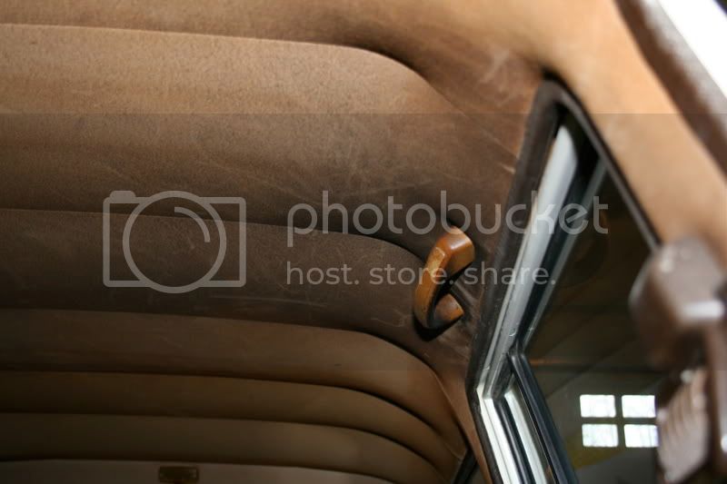

clean and detail interior, was smoker vehicle and I have NEVER, EVER seen this kind of tar build up before on anything. the headliner is nearly black in spots.

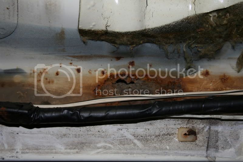

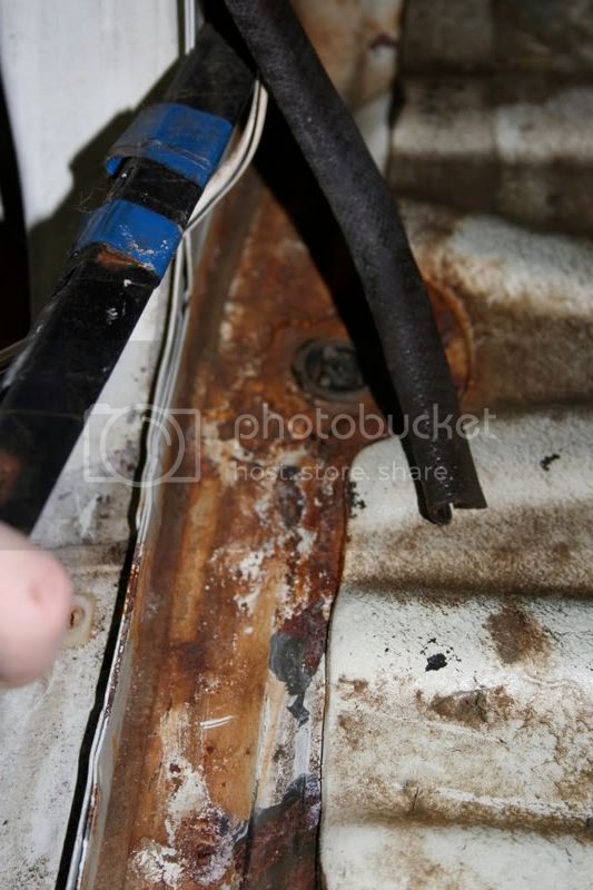

Pulled the interior apart and found some oh so special surprises. More frocking rust!! took it over to My pal Bull's place and had him cut and patch the bad spots. after that I painted the interior metal with Rust Bullet.

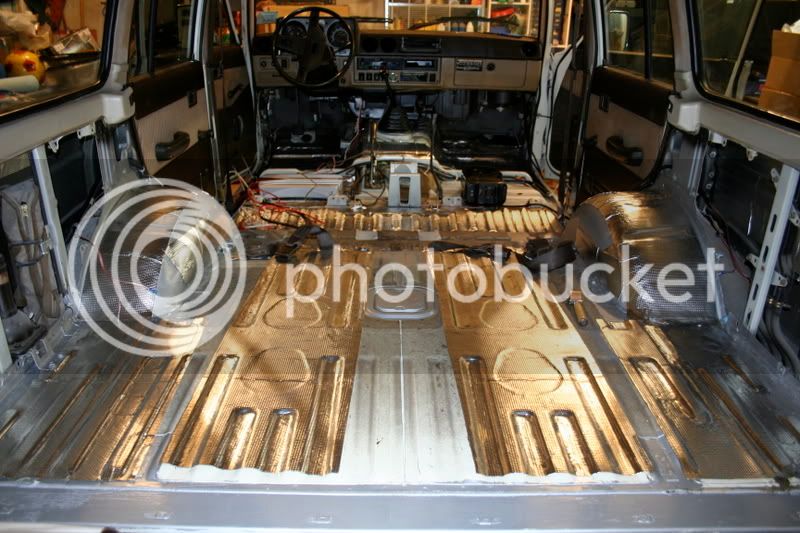

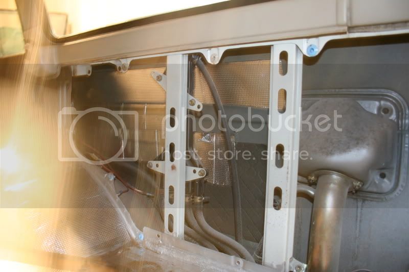

next I applied sound dampening material to the fender wells, inside quarter panels and floor pan, paying special attention to the tranny hump. I used a product called B-quiet. Good stuff, super sticky and easy to work with, no heat gun required. Initial observation on the little wood roller that comes with the sound damping material is worthless, even moderat pressure causes the roller wheel to pop off. the most useful part is the handle, ti actually was evry usefull for working the air bubbles out.
