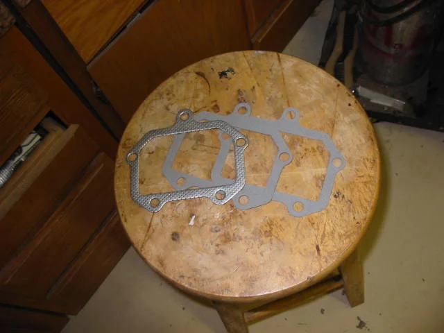

look at your manifold.. total of 5 bolts holding the bottom to the top. intake manifold to exhaust. i just set an intake and exhaust manifold outside to go to my neighbor's scrap pile but can easily send it to you. it's a 1f manifold etc.. and see if you need these gaskets. I can send either or both via the normal parts shuttle tomorrow if you need. i'm honestly tired of holding onto this manifold so if you need it holler now or it's scrap. I was going to cut the bolts holding the 2 together and sell the intake on ebay but didn't really want to mess with it..
and yes if the flapper is gone you can weld it shut or just stick a bolt in there for now. if you know someone that can weld cast with the proper rod that's what you really need.. mig makes mud of it but can be done just not pretty or very well.. i'd see if you can find someone to weld it with a stick. sadly probably best if it's not on the truck tho. and no i'm not sending a spare intake manifold gasket to you. I think butler grabbed my last spare.

you have a manifold, manifold to intake gaskets, and a remote in the parts shuttle located by your house/office/kids school..
Please do not return anything in that delivery, it left the garage and went to a new home is all that matters to me.. I've honestly never used those gaskets they've sat in the drawer for years and they come with intake manifold gaskets every time i purchased one. I normally ran headers on all my 2f's over the years so i'm sure there are more lying around somewhere if you need them.

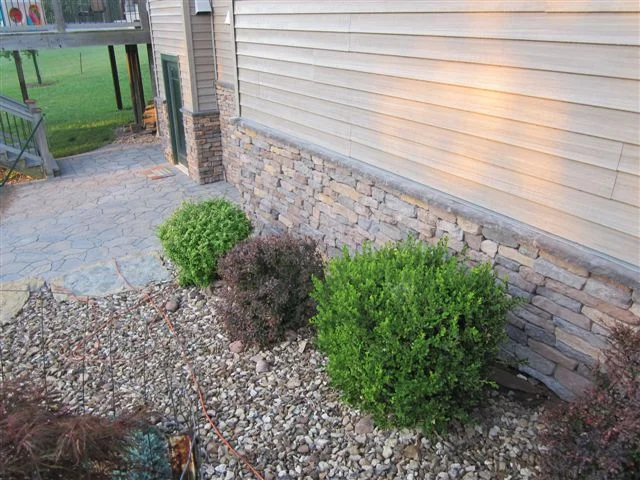

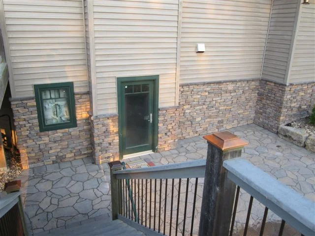

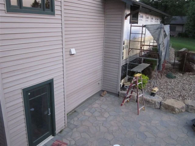

Here is the project that took me out of the garage. For those that came to wrenching weekend, this is off the fire pit area....

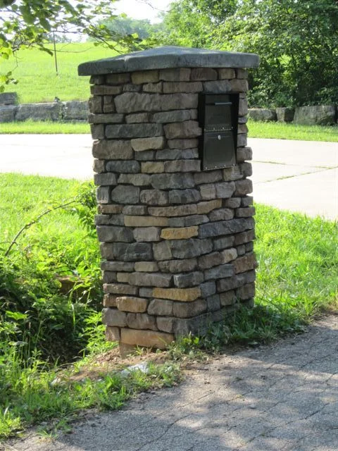

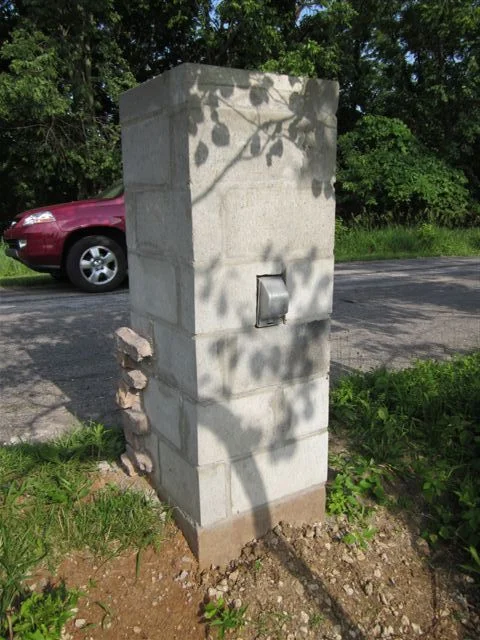

rock project

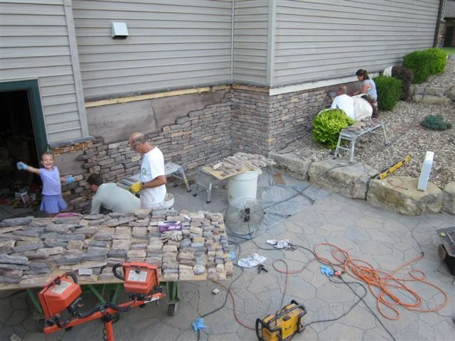

Here is before and during shot....

I really like the middle picture with my dad, myself and my daughter (notice the dress / work clothes). Three generations.
Also, on the right is my bud, Rob and his significant other who got talked into helping out on yet another project.
Kelly - Looks great - you just eyeball/hand lay those stones - so much better looking than the patterned stuff.

On the rock laying... when I say "rock", I should say man made concrete rocks.... The field area is pretty easy to do, but you spend a lot of time hunting for the right size rock when you come to a small area or a corner. It really is a two person job. One laying the stone, and one hunting for the right rock. You can see in the one picture a 4x8 sheet of plywood with rocks small on the left and long on the right. This is a MUST if you ever do this. You still have to hunt for the right thickness, but at least you have a fighting chance to get the right rock.
I still need to do the firepit surround, then I can hide the extra boxes of rock until needed later. This project will be put off until it gets cooler.
Thanks for the kind words, it was more of a project than I thought it would be, but aren't they all?????
