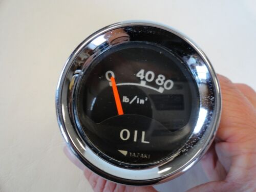

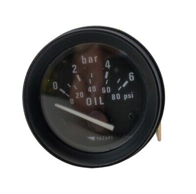

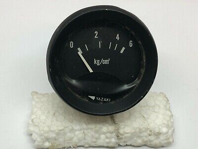

did i mention YAZAKI and NipponDenso make analogue oil pressure 2 5/8 pod size gauges , and they will both communicate in electrical harmony with a YAZAKI manual gauge type Oil Sender like on a 1FZ-FE for instance ..
NO old skool capillary tube set up needed , i like the black and white 100% solid data that is a guarantee of verifiable oil pressure , heck you can see oil flow up the clearing tube to your hand held gauge real time live ...
note no affiliation :
these examples are good in-shop bench test gauges if you will :m
