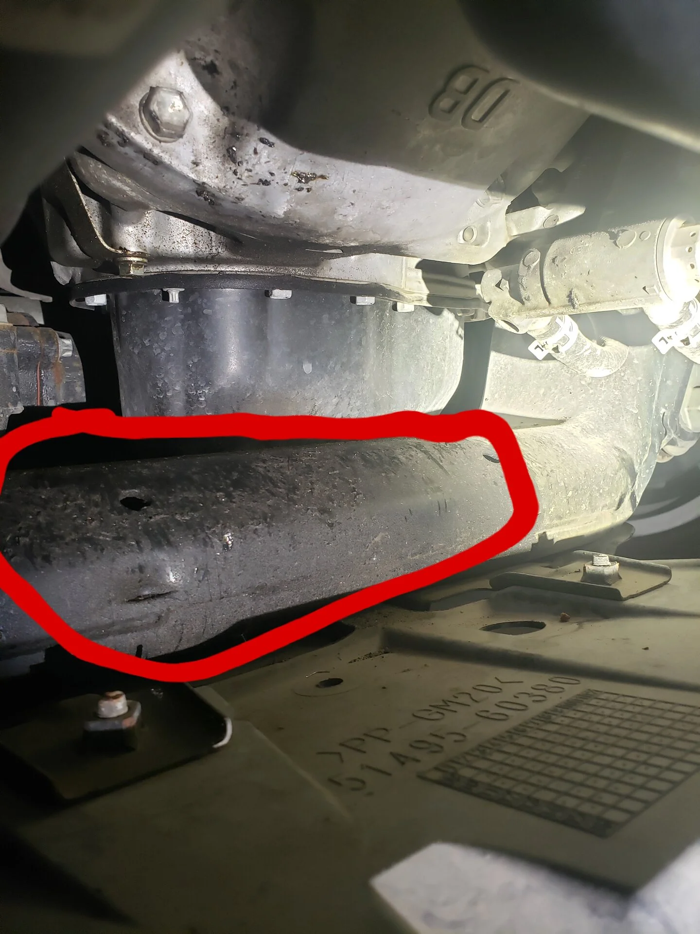

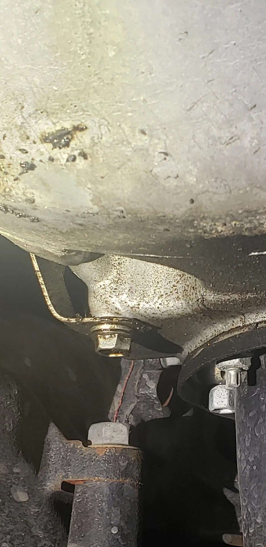

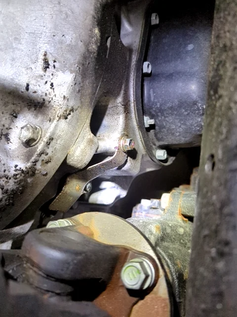

Thanks for your replies. I did go under the truck this morning to have a look with a flashlight and took some pictures. Here's what I found.
There is a buildup of oil on the frame. But it looks to be old buildup. Not fresh. I circled it on one of the photos. Now, there is fresh oil that is on one of the bolts. But I dont see any around the main seal itself.
I cleaned up the area including the one on the frame and I'll keep an eye on it. What do you guys think?
still looks like grease from the u-joint on the crossmember. in the pic the bold dosnt look like it has oil on it it kinda looks like grease as well, does it feel like oil or grease
I touched it with my index finger and its definitely oil. Its light brown color consistent with oil.
As mentioned, wipe it all clean and give it a month, especially since you're dip stick is not showing any loss of oil.
You know what else is light brown and consistent with oil...the grease in your u-joints! You know what is oil based, brown, an d changes consistency when it gets flung onto something hot, the grease in your u-joints. I'm just giving you a hard time, but I'm pretty darn confident it's grease from your u-joint.
Agreed.
That‘s most likely just grease that’s been flung off the u-joint
😂😂😂 ok I probably deserve that dig! Seriously though I appreciate your input. I feel better that it could be just grease. I will keep an eye on it and report back in a few weeks. Thanks again
