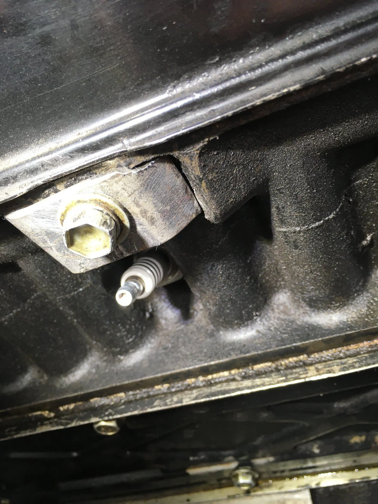

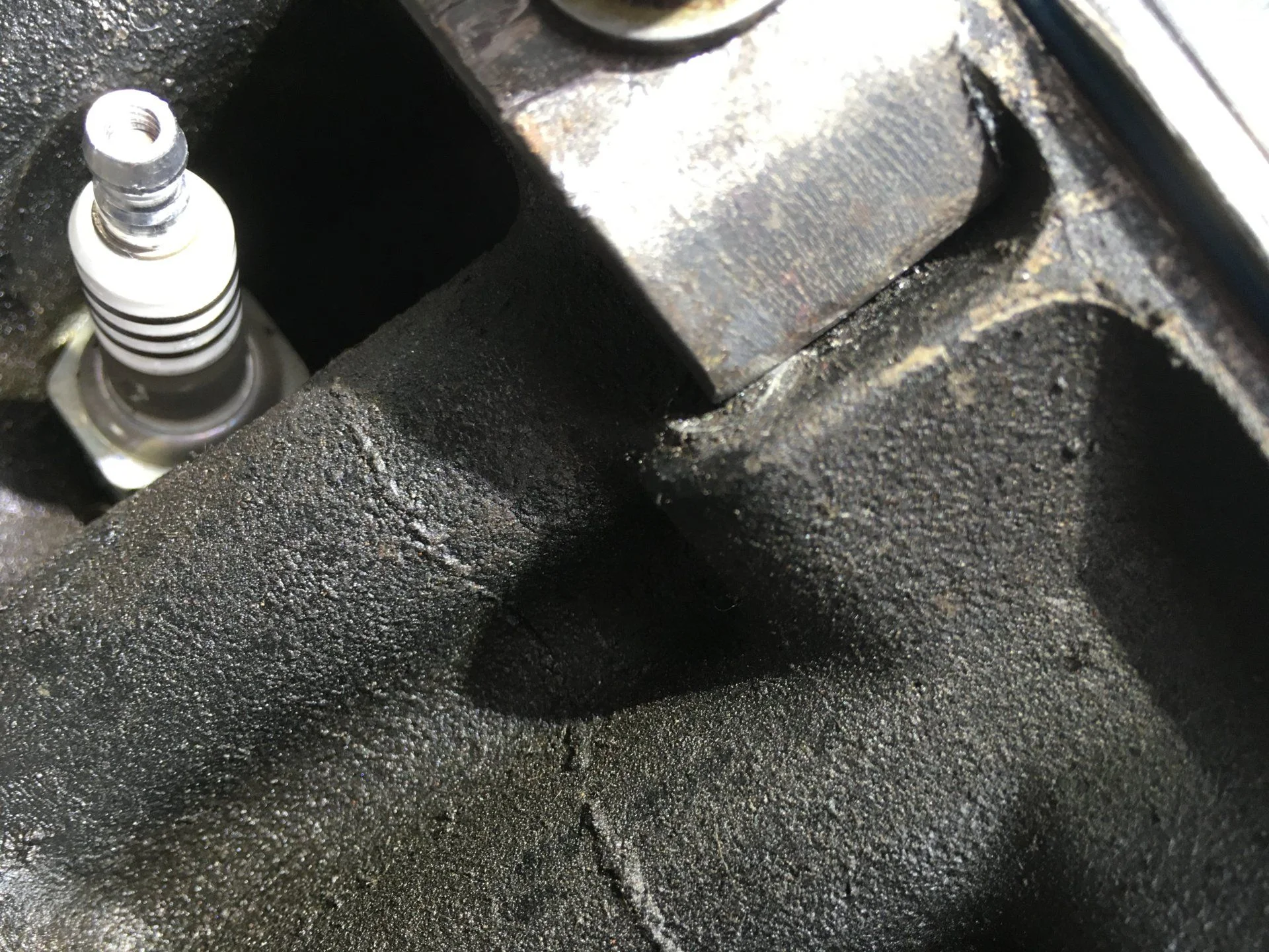

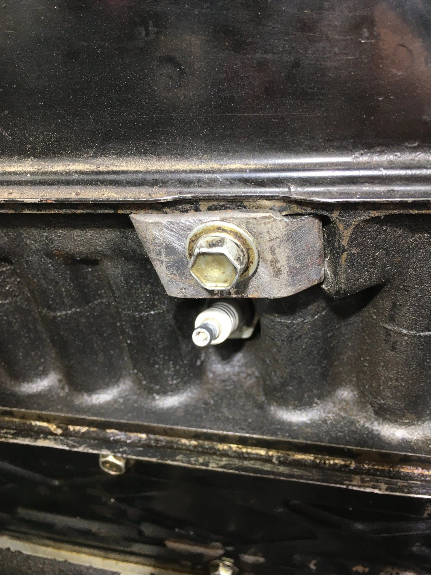

Well, you all officially scared the bejesus out of me. Here in Ecuador it’s not an easy task finding plugs, so I opted for a different approach. I also did not like the idea of “possibly” breaking a tap off inside the head. So until it’s time for a rebuild..... I do believe, as long as it’s not weeping oil and annoying me, I’ll never have a problem with this fix.
I’d like to see it try and pop out now.:cool:
