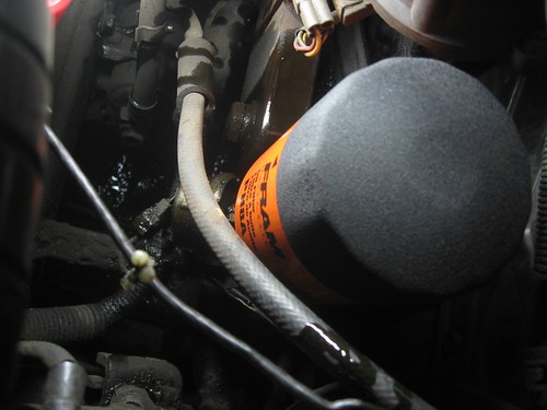

OK, did my first oil change on the ADV80 and made a mess!!!
How do I prevent making such a mess or is this even preventable? Oil changing gods, please bestow your wisdom!
Very slowly.
Lift up the filter, let oil fill the base, then put the filter back on the threads. Wait for oil to drain from the base. Repeat.
Or punch a few holes in the top of the filter, wait for an hour or two to let all the oil drain out, then remove.
Looking at the engine, that oil spill is only helping you clean the gunk off.
If you're really concerned, after you change your oil hit the entire engine with GUNK Engine Brite or other degreaser of your choice. Not only will you clean off the spilled oil, but you'll be much less frustrated with the gunk when you have to work on something else.

I just take an old bed sheet or old towel and stuff it around there as much as possible.... That soaks up alot before much of it gets out of control....

I'm not an oil change expert, but I know the mess you're talking about. My own approch that has evolved over the past dozen oil changes has been to pack some crumpled newspapers around the filter base and then a couple of paper towels. Pull all the papers out with the old filter and clean up the residual.
Moving the filter to a remote spot looks like the best approch, and will be in my future.

I've gone to using doggy potty pads :hillbilly:
Had some left over so I just stuff one of them under there, trying to insure the ends are "cupped" so the oil doesn't just flow past before it gets absorbed. Alternatively I've also just stuffed some shop towells in there as well (making sure they are "cupped"). I always put a large trash bag below the area now to catch whatever the potty pad or shop towells miss.
I've tried punching a hole or two into the oil filter but all I ended up with was more holes for the oil to come out of making a bigger mess as you spin the filter off...Granted, I only waited 15 mins or so...
In the end it seems between the potty pads and/or shop towells and just being as quick as possible seems to work the best for me.
I epoxied the garage floor, that helped. Now I've got a little trough thing under the oil filter that runs the excess into my bucket, nice.
I wrap a newborn diaper around the filter. That catches most of it, but not all.

Is the filter upside down on the R side of the engine (as on an FJ62)?
IF SO, punch a hole in the top of it (sharpened screwdriver) & let it drain while you drain the pan. The longer you wait, the more oil will drain back into the engine & the less in the filter.

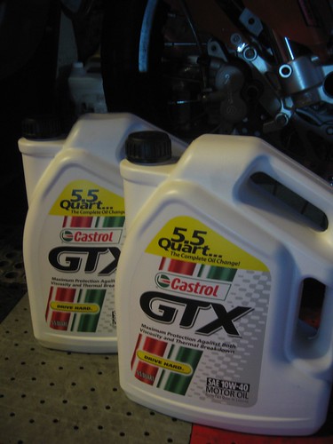

I paid $19.change each X 2 = $40+dollars with tax and all that junk:
So while I was at the Toyota Dealership, I thought I would ask how much it is to have the oil changed. They told me $35!
OK, so I forgot to add in the oil filter to my purchase, so now we are $47+ that I paid... $35 from the dealership??? HOW?
So I asked the dealer if that also included the oil filter? He said YES! Brand of oil? Castrol. Same as I purchased...
