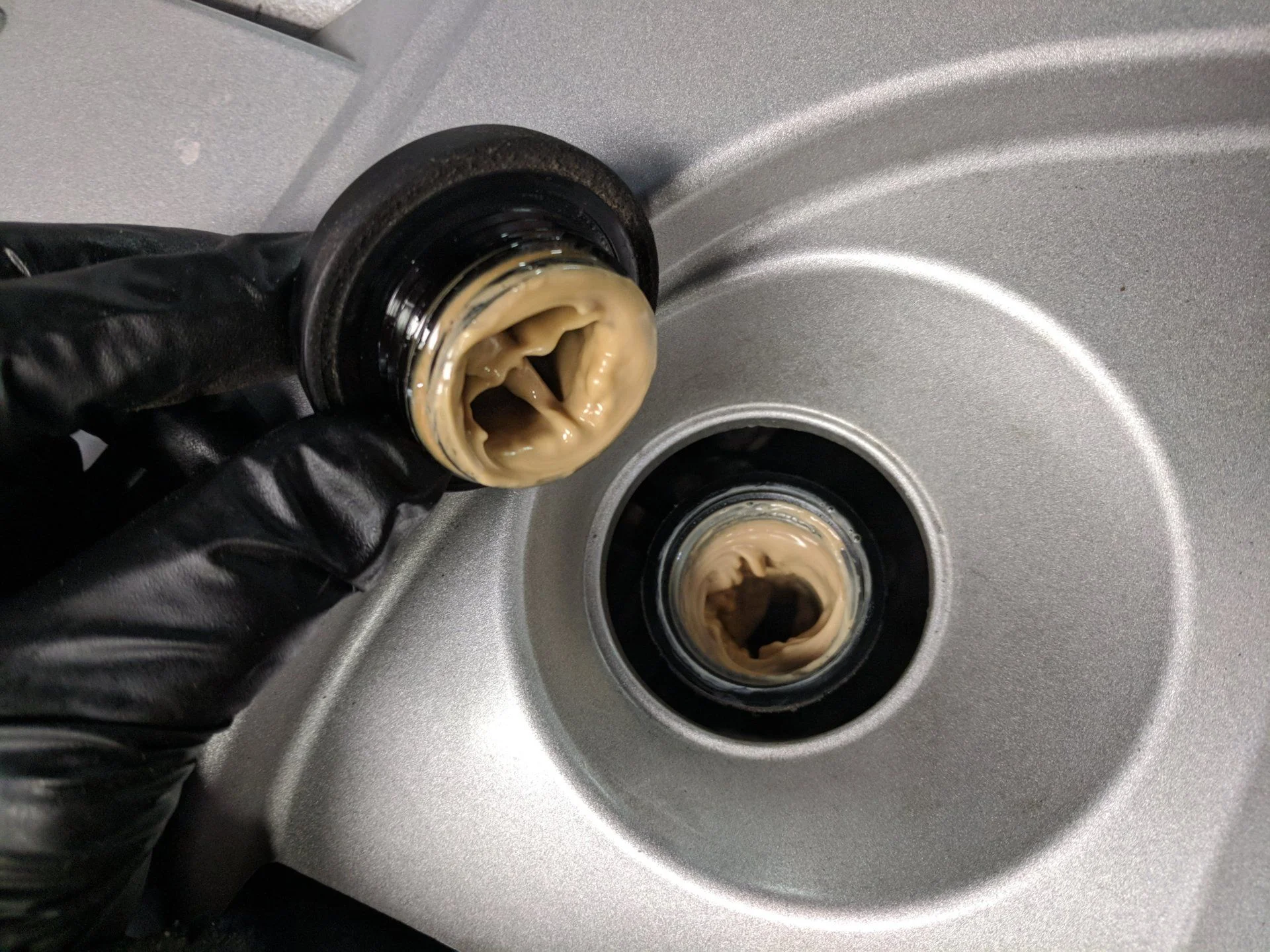

I hit 5000 miles and 8 months this weekend since my last oil change, so I figured I'd take advantage of the mild temps to do a change today, since I had everything at home to do it.
Last change was in May, 109200 miles, first one oil change for me, as soon as I got it home. New OEM filter and Amsoil 0-20W "OE" grade oil. I check it every few weeks, it never moved.
At 114200 miles now. Warmed it up for a few minutes in the garage, then dropped the shields and pulled the drain plug. Oil was dark as expected, otherwise looked normal. Then I removed the fill plug, and found this:
That goo went all the way down inside that plastic fill riser. I pulled the engine cover, and removed the riser. You can easily see down under the valve cover with that off, I saw no more evidence of that residue anywhere, it all looked normal for that many miles. I drained the oil filter into a separate clear pan, let it sit, saw no milky oil, water separation, or sediment, it looked normal, as did the oil filter.
This truck has never used coolant, the last time I added any was last fall when I had the water pump changed (preventive), and I have a mark on the reservoir at the level when cold, it's never moved. It has never smoked or had a steam cloud out of the exhaust. Engine runs very smooth. I also had the plugs changed when I did the water pump, they looked normal but worn out, they must have been original.
My commute is 8 miles, and I occasionally let it warm up before leaving, especially if it's really cold. I scooped as much of the goo out on a blue paper shop towel, and you could see it wicking water out into the towel. Plain water, not pink. Then I cleaned the rest out with brake clean.
Hoping this is just condensation build-up from not running long enough, as has been posted here before. Seems rather excessive to me though, I'm kinda freaking out. I'll check it every time I get gas from now on, might do another change in 1000 miles just to be safe. Maybe I'll find a longer route to work.

At least you're not losing coolant, so I wouldn't be too worried. Condensation and quick drives can be the cause. Still very odd and very excessive. Might try switching to Toyota oil. I've had this before on other vehicles, but never had a vehicle that bad. Looks delicious though, toast some bread and spread some on for a quick snack.
Looks like a combination of your short commute and cold temperatures is resulting in a lot of condensation - I'd freak out, too.
Couldn't hurt to baseline your lube system by switching to Toyota 0w-20 oil and a clean filter next oil change, and running a few errands during the week that extend your engine run time. Other than that, good luck!

I would take the unit for a 30 min or longer drive once in awhile, so it thoroughly warms up and boils off the moisture.

We ran into this years ago in Southern British Columbia. My friends wife had a short commute and when we went for a longer drive the cap was just like that one. Because of her short commute the engine never warmed up enough to dry out the oil and it built up because it was warm enough to cause the condensing of the air in the engine. After the oil was changed they made sure to warm the engine with a longer drive once in a while and it didn't reoccur. It turned out to be a non-event.

4,5,8 miles, you are crazy to start a landcruiser for that, and the sludge is proof it never warms up to operating temp.
Also all the idling on driveways is just stupid, idling does not heat up a car properly, driving does.
All operating below engine service temp is small scale damage.

I'm no guru, but I did some poking around...and found this:
Looks an awful lot like what this video describes as "accumulated condensation that doesn't have a chance to heat it's way out on shorter drives."
This <5 minute video also mentioned that it's not usually a huge problem. -Just looks horrifying.
This guy's clarification would be done by checking the dip-stick. If it looks milky at the dip-stick, you want to look for coolant. He also has some suggestions & other things to look for & some other factors to consider when short trips are the norm. Talks about the need for more frequent oil changes since short trips can lead to other issues that mean NOT waiting for 5000 miles to change oil.
