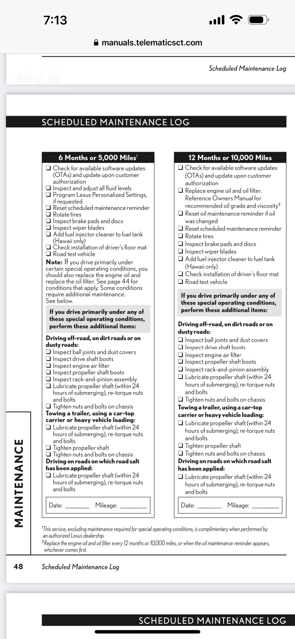

I thought that they’ll only give one free oil change on a new Lexus since LexusCare only covers the 5k and 10k maintenance and the oil isn’t scheduled to be changed until 10k. If you claim driving under “harsh” conditions, can you get an oil change out of them at 5k?
Lexus quietly revised their recommended maintenance plan for the GX, 5000mi intervals are standard now.
my dealer told me to come in every 5k when I bought it.
There is a 5,000mi maintenance, but it doesn’t include an oil change. Only tire rotation.
This is the same maintenance as other Lexus cars, it does say if you drive under special condition/severe service change engine oil and filter at 5k, basically without the oil change the 5k service is a tire rotation and some inspection

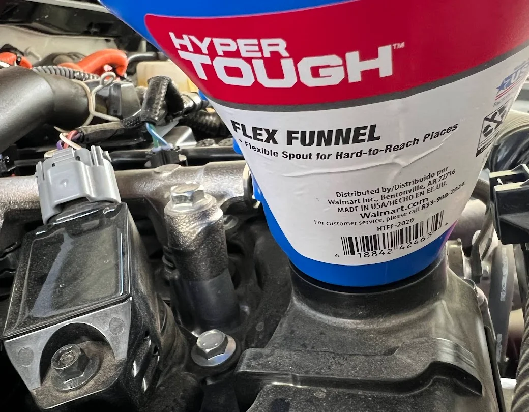

If you use a funnel to fill, it likely won't go down far enough into the oil filler cap hole to stay upright. At least mine didn't. A bit of a pain to hold it and fill with the 5 quart jug. Saw in another forum that a 1 quart bottle fits it well, so I may try to cut one in half next time to use as my dedicated 250 funnel.

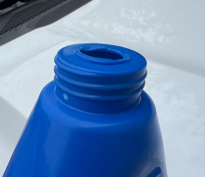

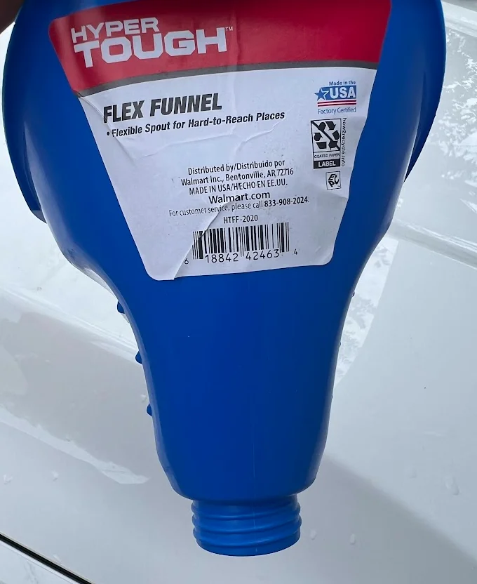

Found a threaded oil funnel that should work, but you have to cut off the tip below the threads. It screws into the oil filler cap spot fairly snug. I went overboard, used a Dremel cut off wheel and smoothed the cut with a box cutter, then heat gun.

For some reason I didn't like the blue and clear neck ones on amazon. Prefer a larger opening to wipe out easily after use and to hold the jug.
