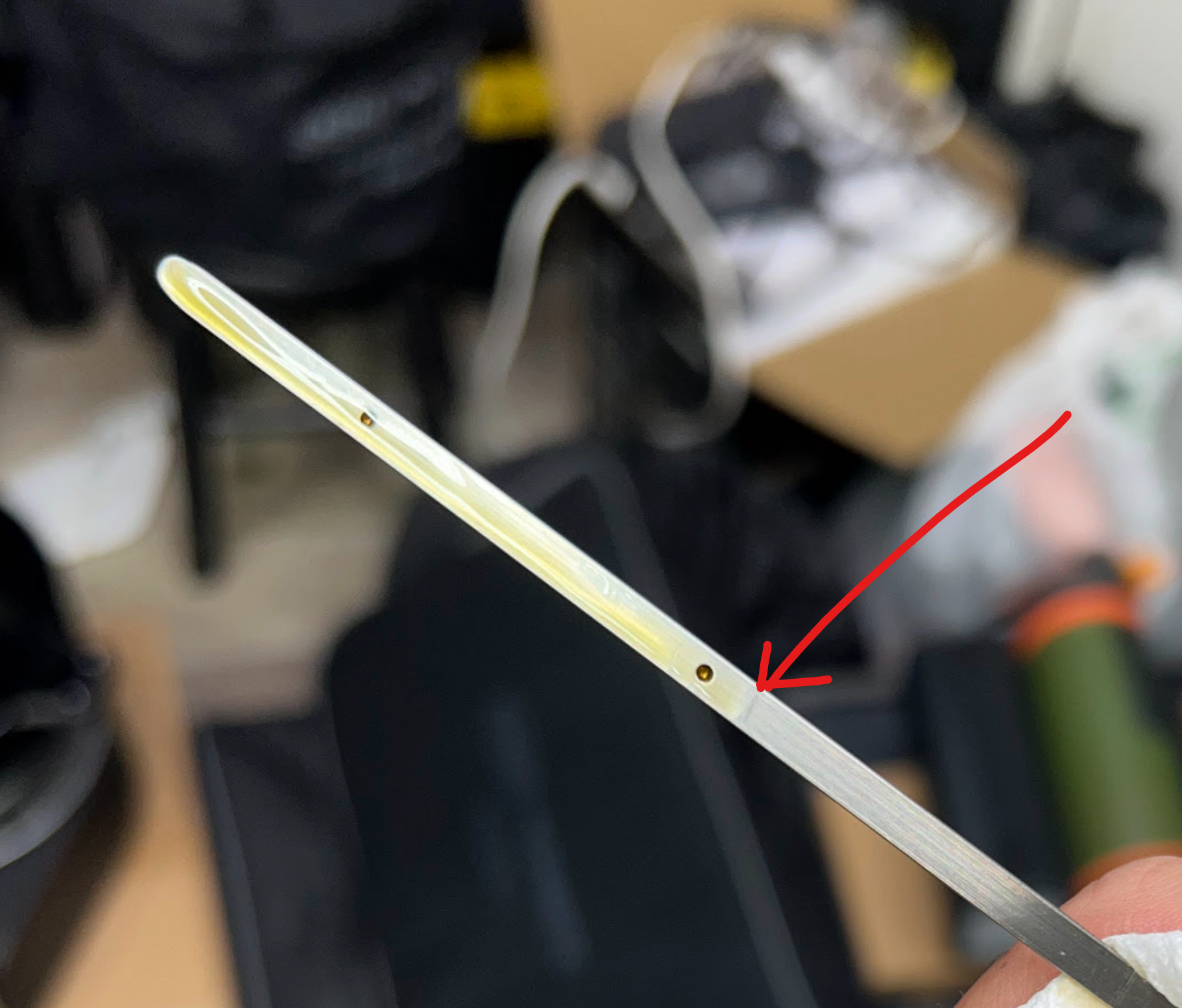

Factory fill oil level was a tad above the upper limit mark - red arrow on the dipstick below. Been that way since day 1 of ownership. After the oil change and adding ~5.9 qts, it's a little more than halfway between the two limit marks.
