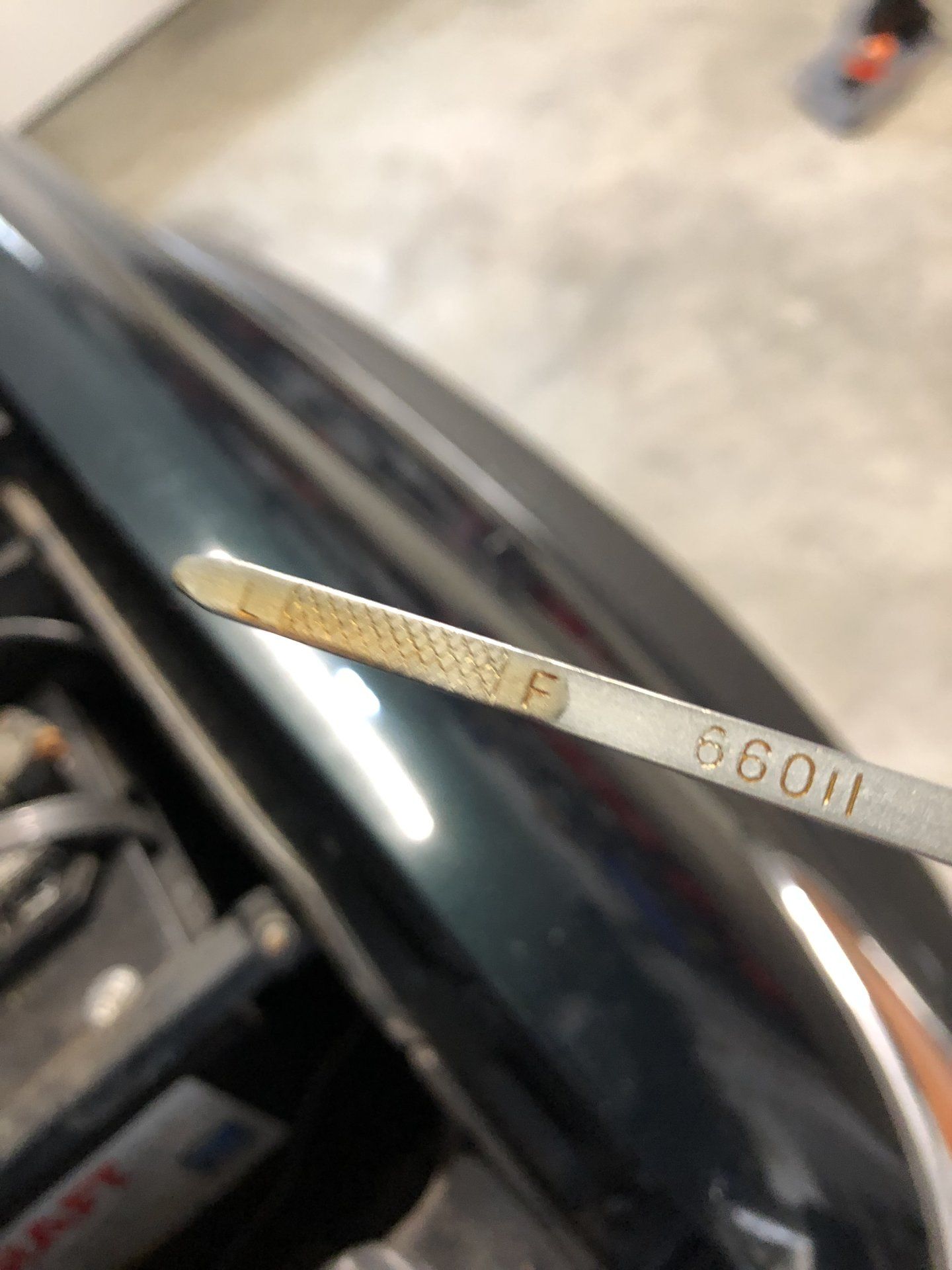

It is certainly possible that you don't have the proper OEM dipstick. Post a picture of the lower portion and overall measurements so others can compare.
I will post a photo of it tomorrow, I'm stuck at work all night.

It has sat without running for 2 days now, and sits slightly above the F mark.
I'm just going to leave it as is. Lessons learned.
Thanks for the help gentlemen.
Dipstick after sitting 2 days. Should I drain some oil?
