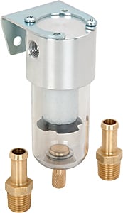

I think THIS might be one choice at JEGS. They claim it is designed specifically for PCV.

Slow Left and Output Shaft, the one Ouput has pictured is the one I have installed.

Here is the JEGS model installed in a FJ60 with a 2F. It's included bracket can fit under an existing bolt. None of the original PCV hoses need to be cut. The innards are typical of a common oil/water separator... It's just smaller. The bottom clear bowl can unscrew when it is mounted on the bracket. Easy to go 'back to stock' if you wanted to for some reason:
BUT... before you get all excited about it. See my later post on actual use.
Boy, that thing looks like a water separator/filter for compressed air systems....
