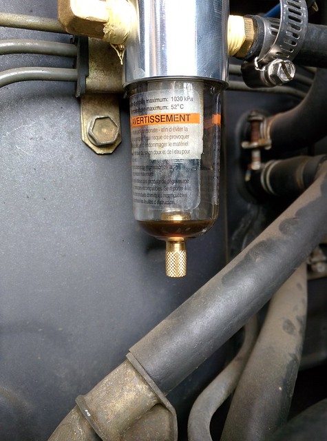

I just installed it this morning, took the pics and ran up to the computer and posted it :)
It would have taken 20 minutes to install it (had to drill out the mounting bracket hole slightly larger to fit the 8mm bolt) but I had to run over to the hardware store to get a right angle NPT fitting. I had a short piece of 3/8" fuel line laying around.
I'm curious what will end up in it too.... Very curious indeed.
Show us a pic after a month or three
Cool. Looks like it's doing it's job.
I wonder if you are going to notice an increase in MPGs.
That was only after 1 day of driving? How many miles?
Only about 50

Just thinking, because for 50 miles that seems to be a good shot of oil...but then again, I haven't installed one yet on my rig so I really don't have a point of comparison, just didn't expect to see that much after 50 miles...
I did this install yesterday, and drove 150 miles today. Actually, it was 10 hours of driving, since 100 miles were on forest service roads and in 1st and 2nd gear. Some time in low range as well. Was in the cascades, so a lot of up and down. There's definitely some s*** in the can.
So this has been installed but you've not really put it to use yet? Looking forward to see what accumulates in the bowl.
