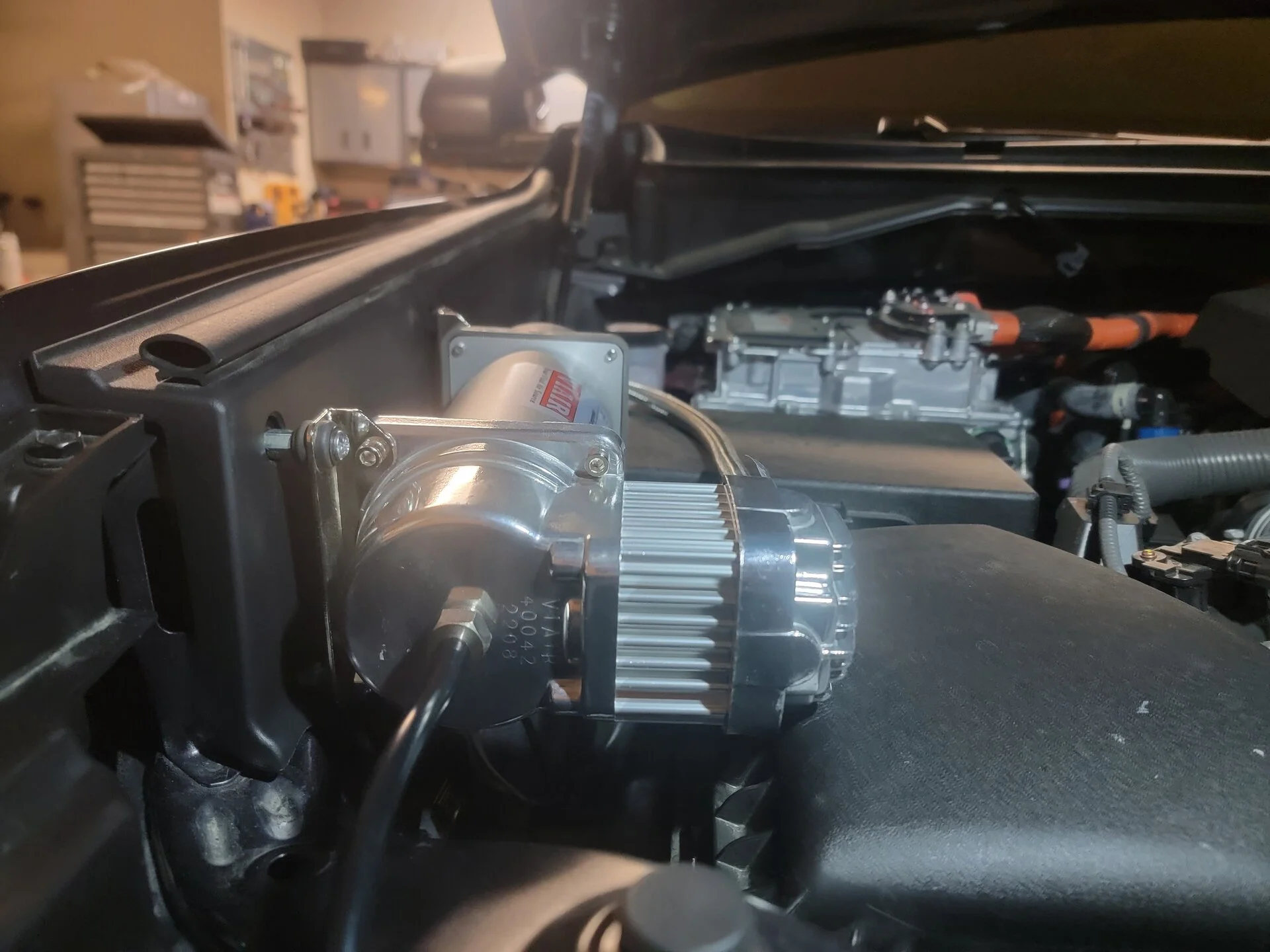

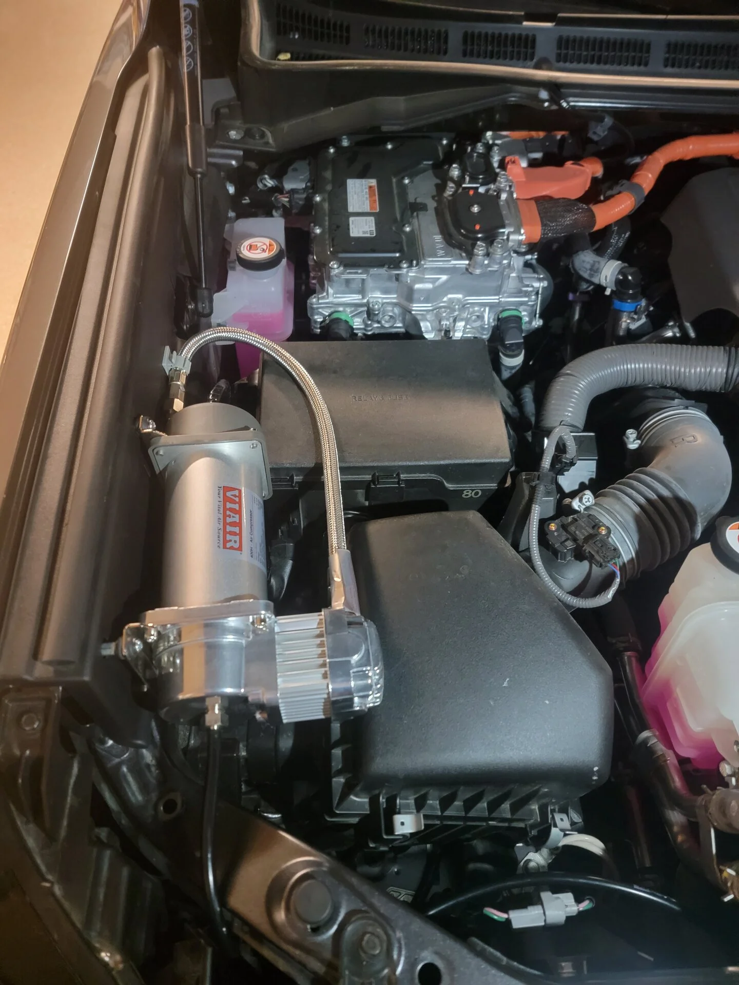

Thought I'd share the air compressor install I finished on Friday. Viair 400H mounted on the side of the engine bay to some L channel brackets. Brackets mounted to existing bolt holes supporting hood apron on top and one rivet nut on a fender support hole on bottom. Mounting screws go through the engine bay trim so that it retains the hood seal gasket and more OEM appearance. Inlet air located at top edge of radiator and inside edge of plastic (headlight shield support?).

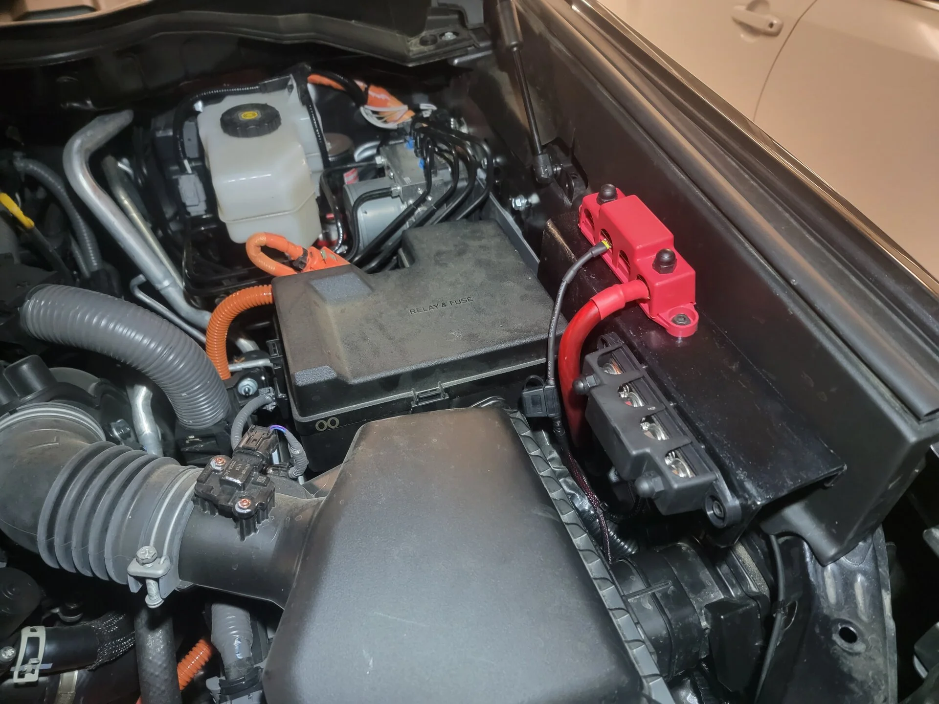

Power routed to bus bars mounted on other side of engine bay, wired with parallel 1/0 cables running back to parallel 500A continuous duty solenoids mounted above battery in rear quarter panel cavity. I preinstalled these for the winch but decided to use it for the compressor as well. The solenoids are activated with the previously shown "Winch Power" switch on the dash, and for the compressor, using the local switch as well.
No excessive vibration, and although it was a tight fit, there is no contact with the air filter housing or fuse box, and I kept just enough room so they could still be opened.

Did you route from bus bars back internally or hug the frame externally?..

Externally. I watched a video where they routed it along the sill channels by the doors and maybe my 1/0 sheathing was thicker than theirs, but no way was that fitting, and also wasn't looking forward to drilling that size of firewall hole. Instead it travels down, along the top of the frame rail, then jumps into the driver side wheel well along the fuel lines with plenty of space behind the liner, and through some gland seals into the battery compartment.
Once I had the guts to drill my battery compartment holes, the rest was easy.

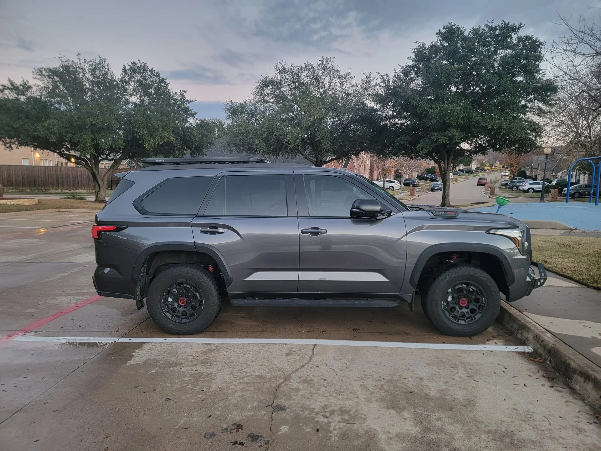

The 3/1 lift gave me 2" in the front and 7/8" in the rear.

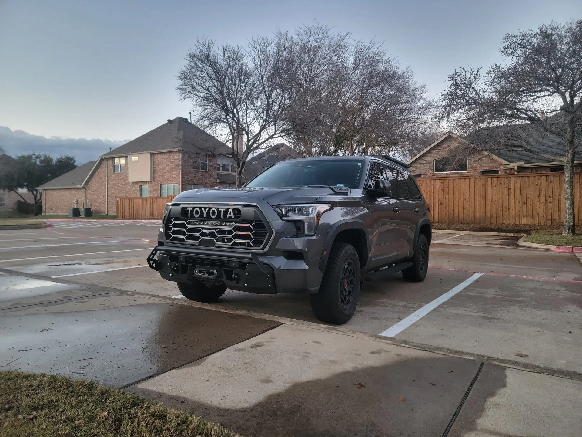

The CBI covert bumper bull bar appears to be fully compatible with both the ultrasonic parking sensors and the forward radar. Both have worked with no issues.

Westcott 3/1 makes the OEM TRD Pro tires look so small!
CBI Covert bumper with bar:
