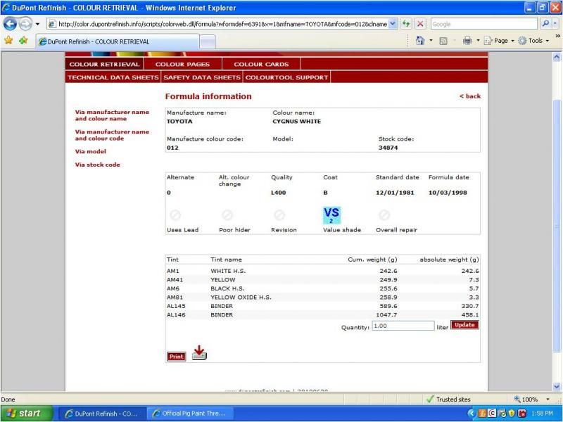

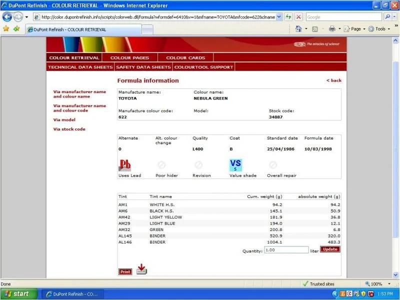

Was able to gain entry into the Dupy HAL 9000...they'll probably snuff me out again :mad: but here ya go John.
Todd,
Would you be able to list the ingredients for my 1974 Pig w/ Nebula Green (622) and Cygnus White (012)?
Thanks!

Pretty sure it's base coat/clear coat...do you need the single stage formula ? I do believe that is what the "B" stands for right underneath where it says "Coat".
I was looking for 2 stage (base/clear), no need for single stage formula.
Anyway to confirm it for sure the 2 stage formula?
Thanks!
TJ....at this point and to be certain, I'd go here Locator | DuPont Performance Coatings - appp20.asp.dupont.com and find the nearest Supplier. With the color code and stock code from above in hand and ask them if the can mix it in say a 2 stage poly urethane like Imron Elite or I think they have a lesser expensive Chroma series paints. I'm not good remembering the Dupont line...Centari I think is the single stage stuff. Anyway, call the nearest supplier and talk to them...they are the ones that will be doing the mixing ultimately.
